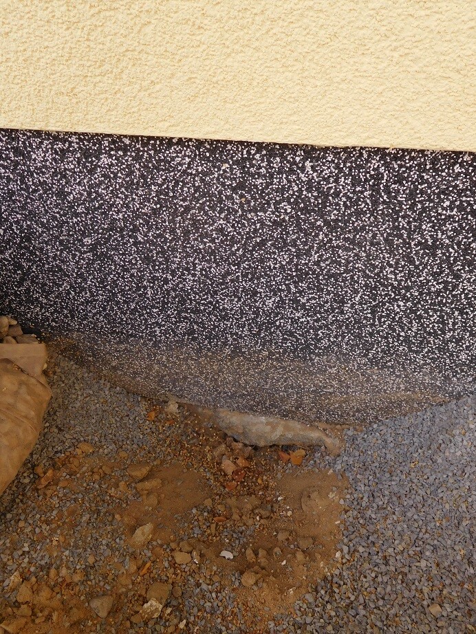

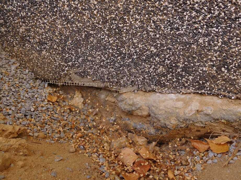

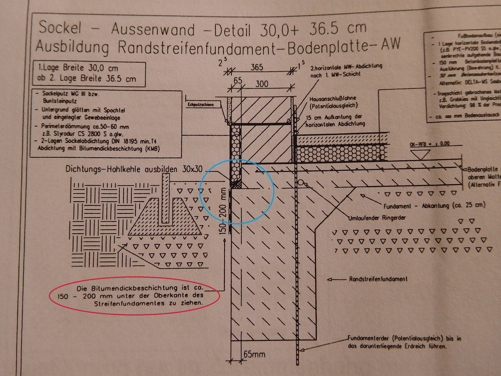

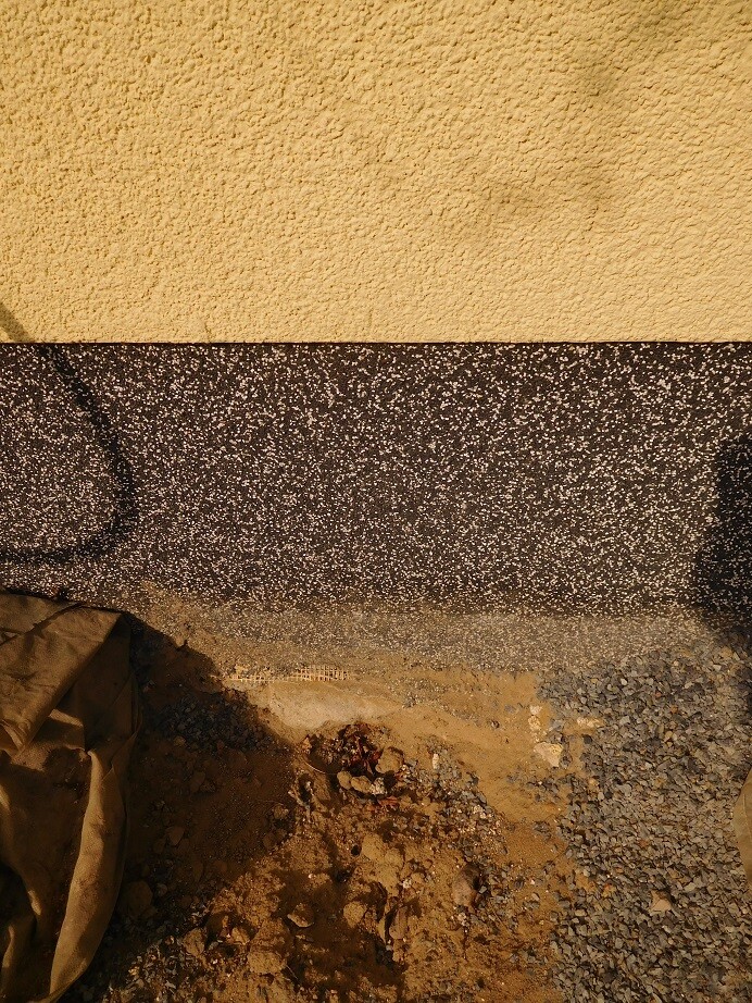

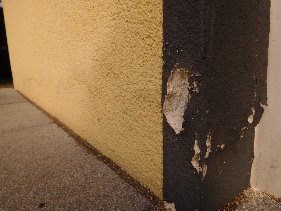

With this post, I am also sharing some pictures:
1.) Damage overview
2.) Plan excerpt (red marking = instruction for bitumen, blue marking = detail of foundation-to-plinth plaster transition)
3-6) Exposed transition areas without bitumen.
I hope the pictures provide a clear impression.

1.) Damage overview

To me, it already looks like the building waterproofing on the plan isn’t extended high enough. I also can’t see any render or base waterproofing.
What kind of experts did you consult? Are you sure you understood everything correctly? You must not backfill directly against the bitumen waterproofing!
