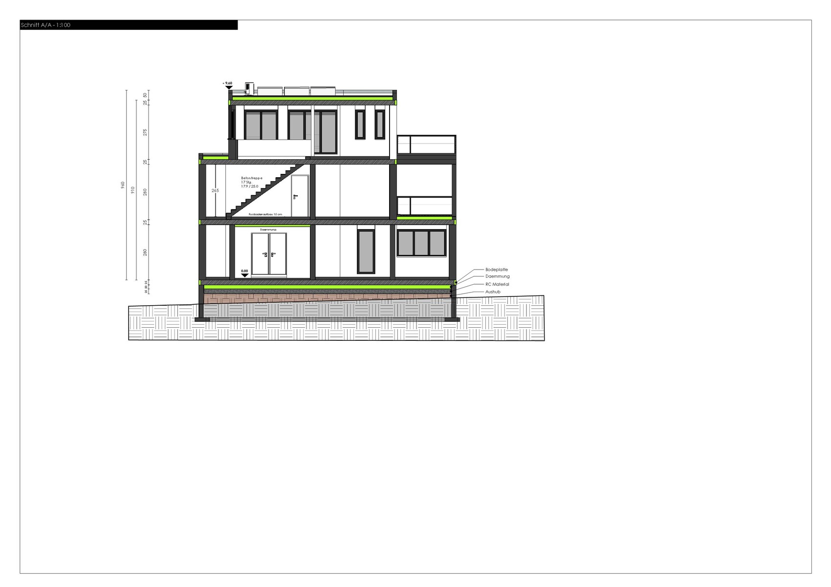

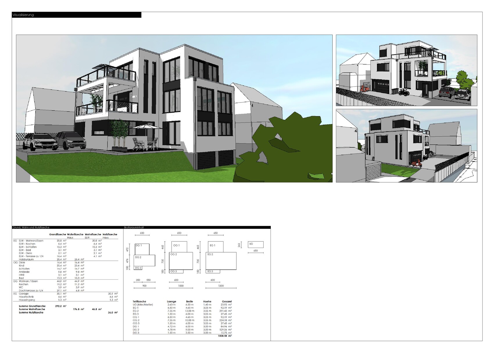

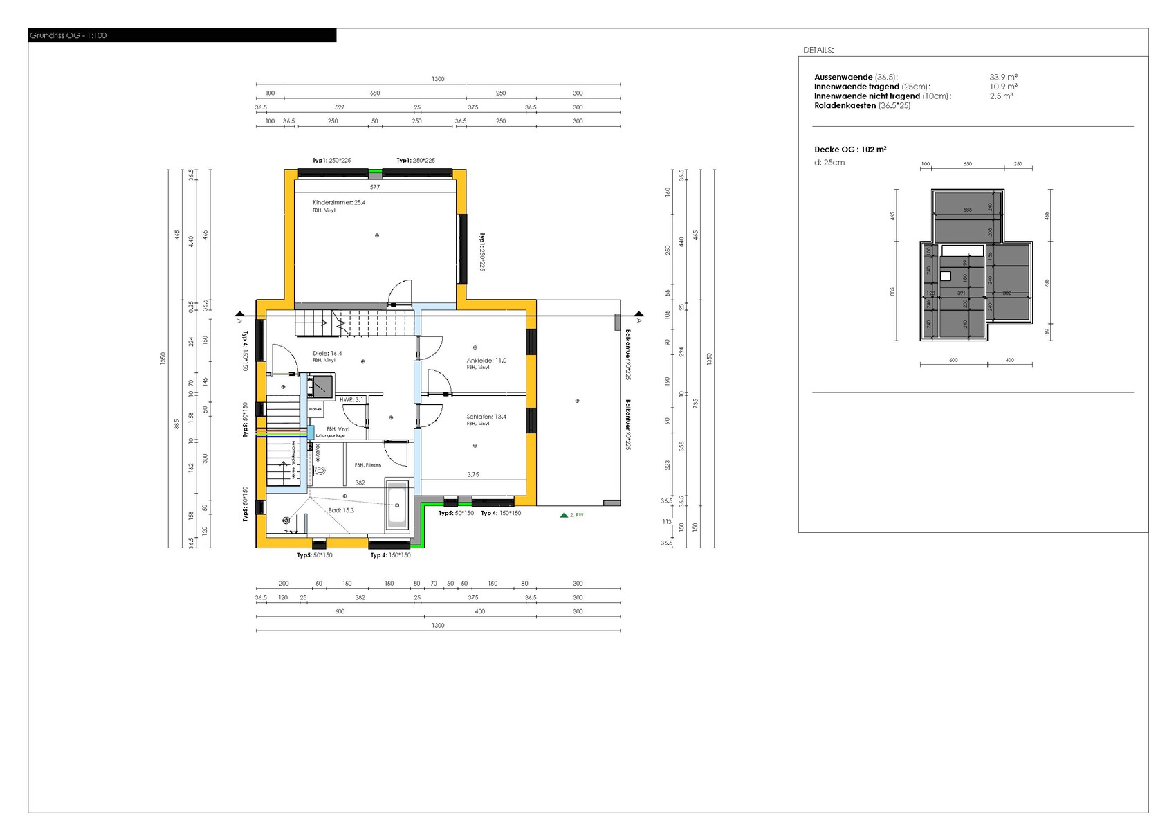

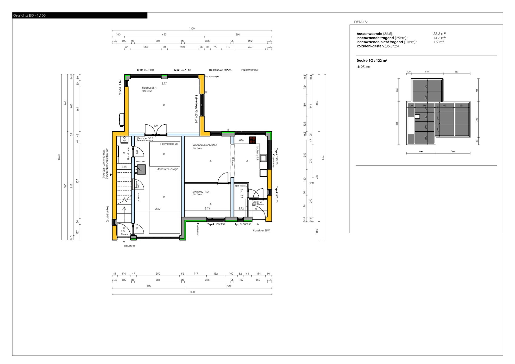

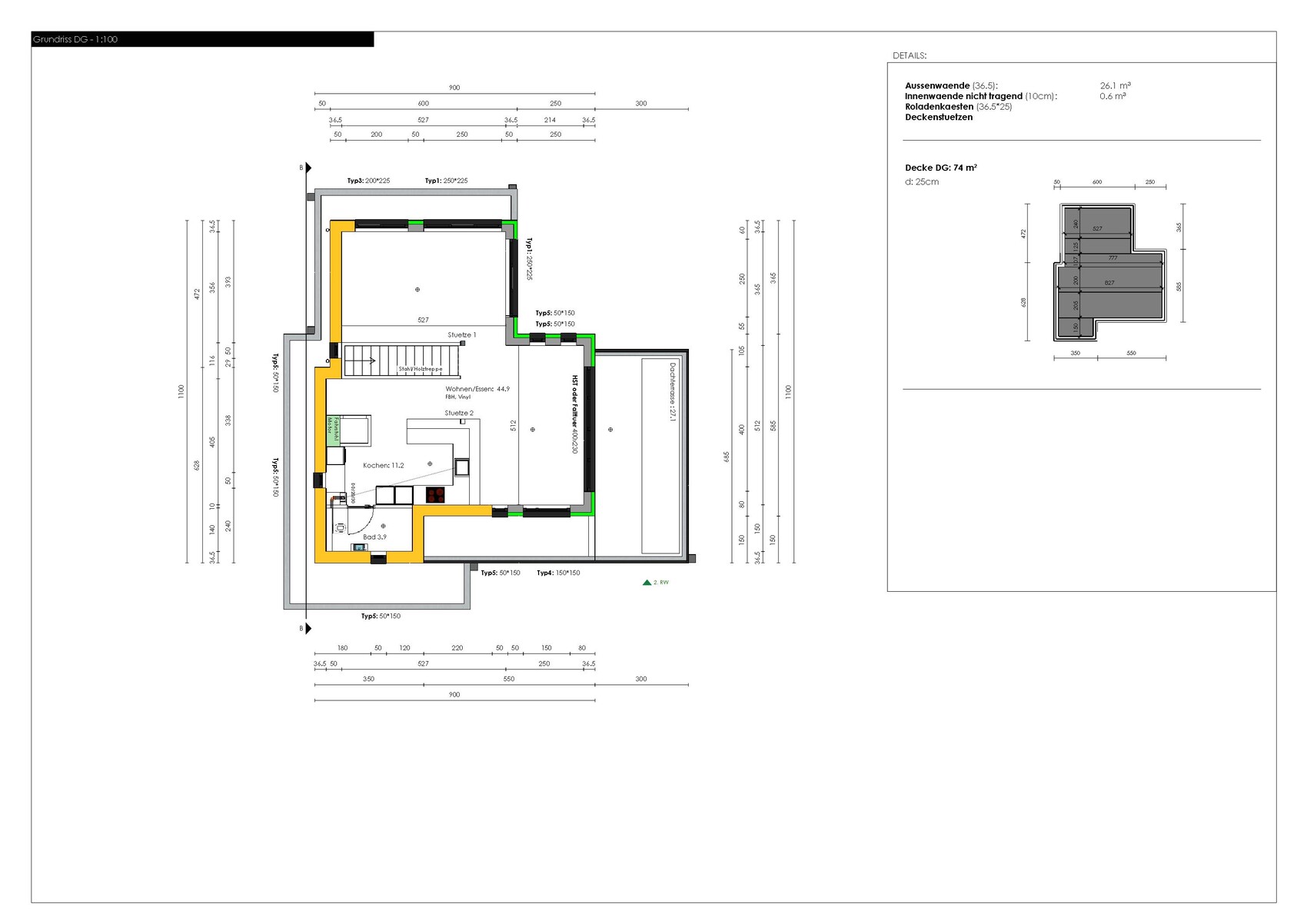

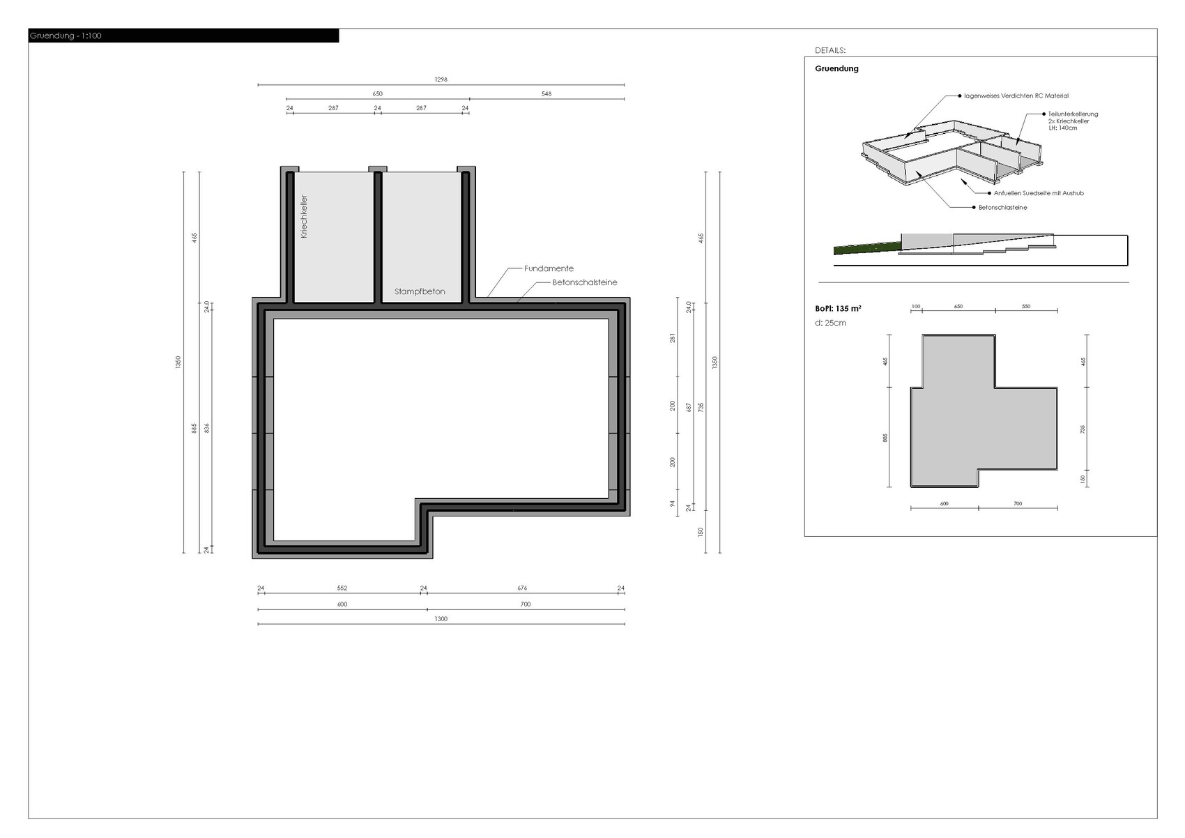

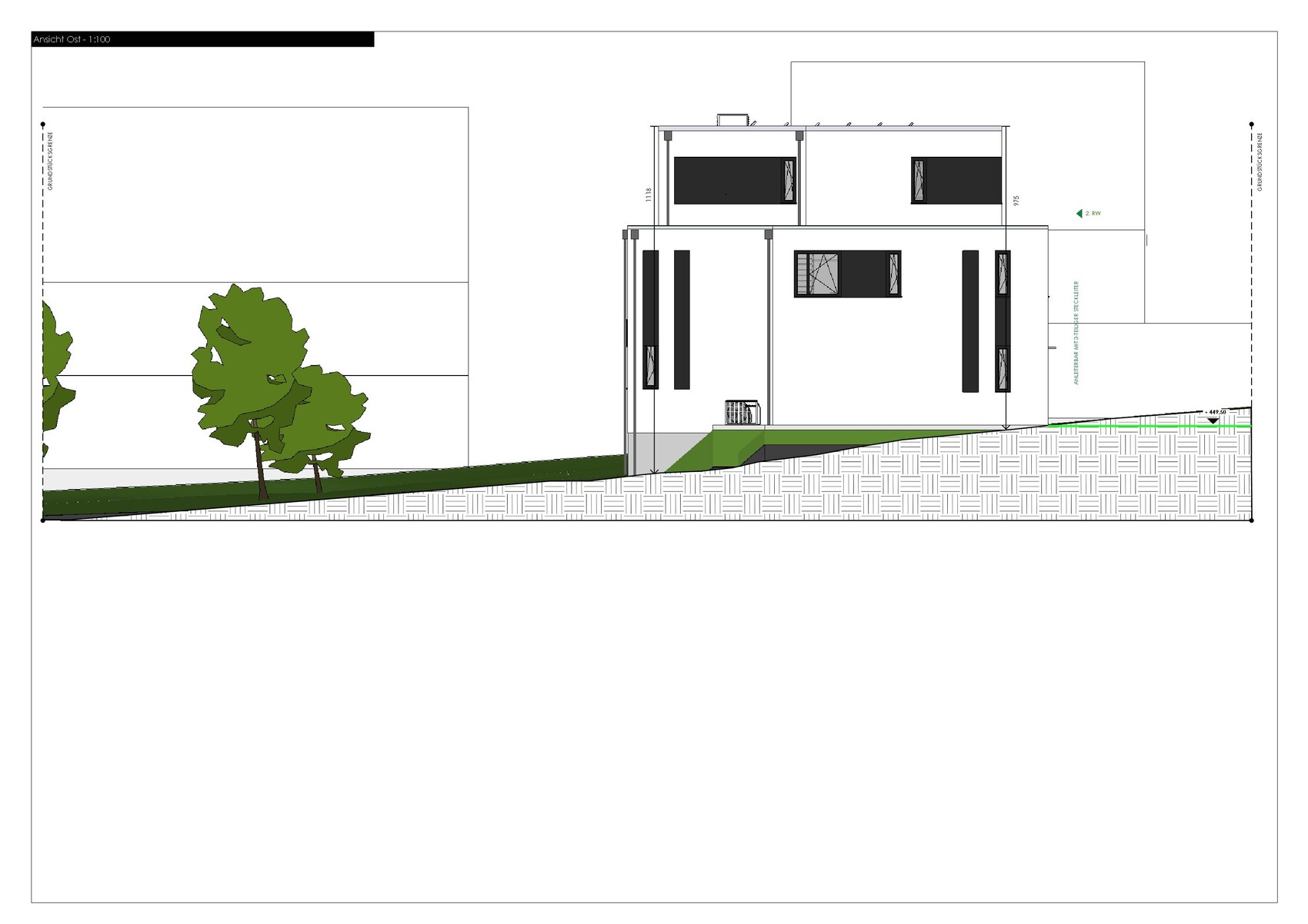

Attached are my current plans. I am currently focusing on the foundation. (Soil report is available)
Which option is more cost-effective? Using formwork or building with concrete blocks and filling them with concrete.
Does anyone have experience with this? Many thanks.
Best regards, Alex

alexisan schrieb:
I have planned for 1 square meter per ceiling.
DIN 18040 requires, for barrier-free access in new buildings, elevators with a cabin size of 1,100 mm x 1,400 mm (43 inches x 55 inches) to accommodate a wheelchair user and a companion.
11ant17 Feb 2019 19:34
I assume these are internal dimensions. That means there will be additional space needed for installations, technical equipment, and so on.
