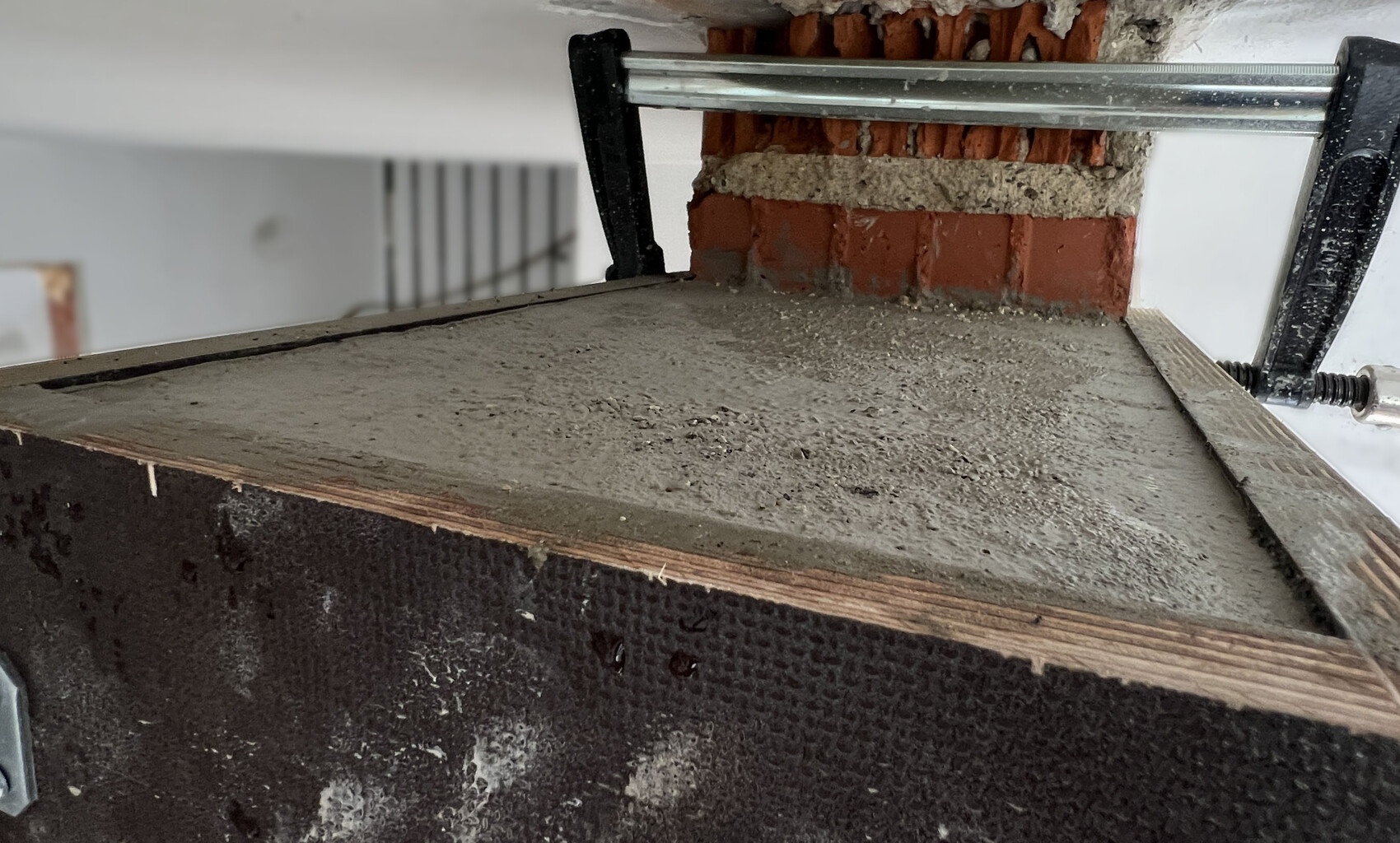

I had a small mishap while making a foundation: the foundation ended up slightly uneven (1-2mm).
Initial situation:
  • Creating a foundation for a double T-beam to support a ceiling, after partially removing a section of wall.
  • Everything executed according to the engineer’s specifications (foundation height, etc.)
  • Foundation dimensions: width 24cm (9.5 inches), length 30cm (12 inches), height 18cm (7 inches), with appropriate reinforcing steel.
  • Distance from foundation to ceiling: approx. 14.4cm (5.7 inches)
Unfortunately, after the first drying overnight, the foundation became slightly uneven – more precisely, it slopes slightly forward and along the edges. This might be visible in the photo.
As a result, the double T-beam would not rest flat.
The height at the back is correct, but at the front and sides it is about 1–2mm (0.04–0.08 inches) too low. The foundation was formed with rather dry concrete at the bottom (compacted), and the top few centimeters I poured with wetter concrete, hoping for a better leveling effect.

Interior shell construction: concrete floor on formwork, brick wall behind, metal clamp visible
In der Ruine18 Sep 2023 10:40
The concrete is still fresh and can (carefully) be smoothed well. Sanding is an option, or a trowel. Once it hardens, use an angle grinder with the appropriate disc.

don’t stress more than necessary at this point. Nothing serious has happened yet.
From the picture, it definitely doesn’t look worse than what contractors usually do with those concrete pads.
