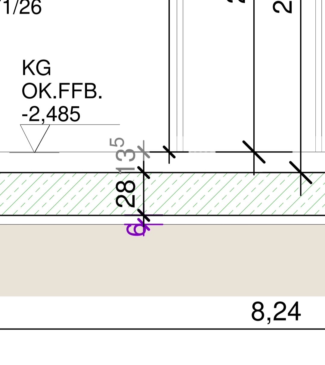

The wooden formwork for the basement slab has been installed. After the insulation was laid, the formwork on the inside is still about 20 cm (8 inches) high. According to the plan, the slab should be 28 cm (11 inches) thick.
Is it normal for the formwork to be lower like this? Will more be added on top? Should I address this with the construction company?

Currently, there is space for a 20 cm (8 inch) thick concrete slab, but according to the plan, we need a 28 cm (11 inch) thick slab. I’m wondering if some kind of adjustment will happen or if we will need an expert to inspect and then have the 20 cm slab demolished... Well, instead of immediately calling in an expert, I would first try to have a discussion. For example, I have had roller shutter boxes installed where none were planned or doors put in the wrong place. But everything was resolved calmly through discussion and then either corrected or, as with the roller shutter box, simply not charged for.

hanghaus20237 Oct 2025 10:38Please show us the section of the plan and a photo of the existing structure.
