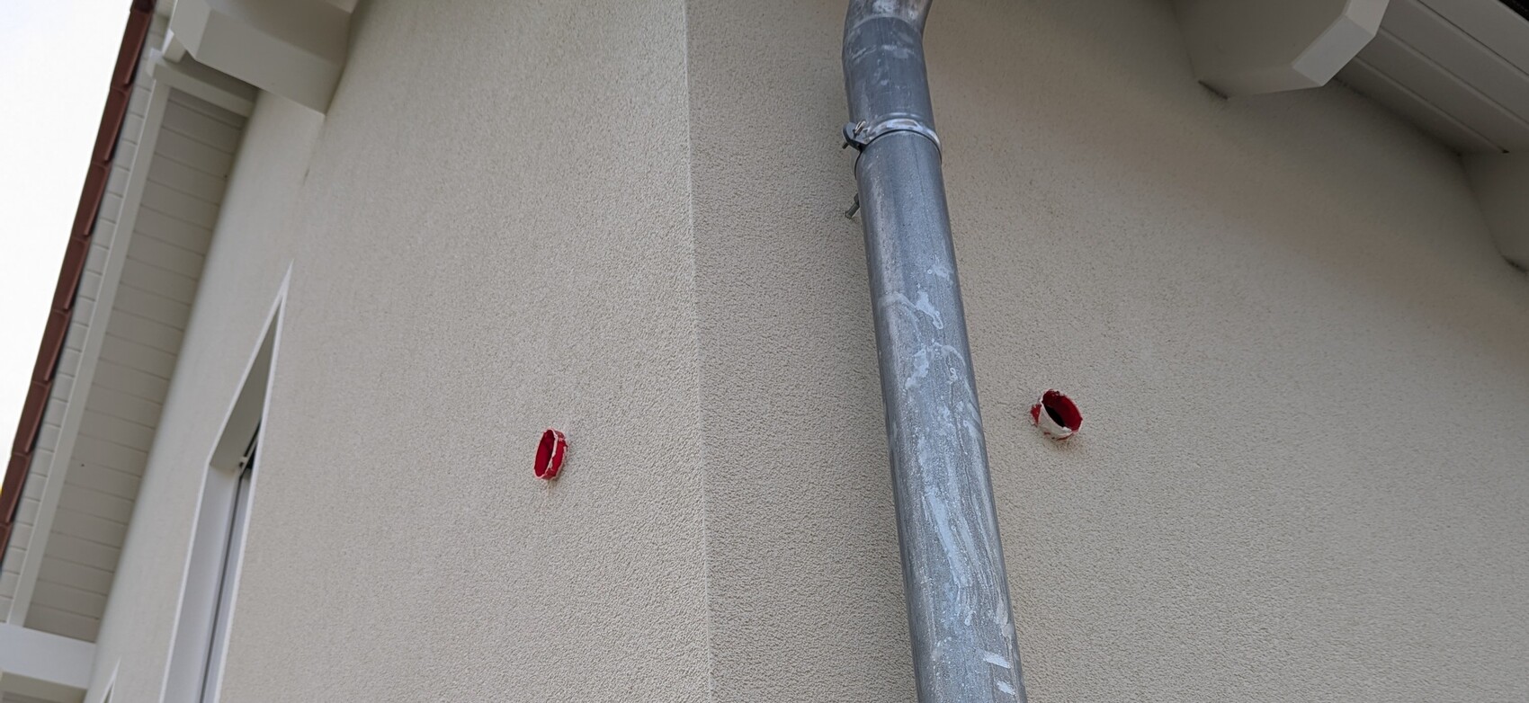

We had the electrician run power for outdoor cameras. The flush-mounted boxes now protrude several centimeters (inches) beyond the plaster. Is this normal? How is an outdoor camera or a cover supposed to be attached without it looking really awkward? What do you think?What does the electrician say about it?W
wiltshire6 Jun 2025 18:05You took a photo of the current work progress. When it is finished, it will look different.

What should be installed if you want to run network cables there? Are those simply flush-mounted boxes?The answers are probably as diverse as the scenarios. We can see a plastered facade, but we don’t know if it’s an external thermal insulation composite system (ETICS). The network could be Power over Ethernet (PoE) or have a separate power supply. We don’t know the weight and wind load of the cameras either – this affects whether the boxes are just cable junction boxes or if they should also serve as mounting brackets.https://www.instagram.com/11antgmxde/
