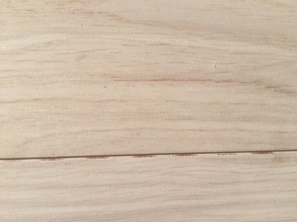

Vanessa9417 Sep 2017 14:45Hello,
unfortunately, we cannot recommend this flooring. We built our house last August and chose the Avatara MultiSense flooring throughout the entire house because we liked its appearance and it was described as particularly resistant to damage.
We still like how it looks, but after just one week, we noticed the first scratches. We realized that the scratches were caused by things like wooden chairs (which at that time still had no felt pads), tiny stones that made it into the house and then caused scratches with slippers, or other everyday stresses.
What is especially frustrating is that the scratches are very visible because the white core layer beneath the wood finish immediately shows through.
At first, we thought it might be a manufacturing defect in that batch and contacted our local dealer. They arranged an on-site inspection with a representative from Ter Hürne. During the inspection, our concerns were downplayed. The scratches were explained with the unusual argument that the damages had a “mechanical” cause.
Then Ter Hürne carried out a stress test on a leftover piece of our flooring. Strangely enough, the result showed that the flooring was fine and met all standard requirements.
As a goodwill gesture and to close the matter, they offered us two new packs of the flooring, which we were not happy with. That was the last we heard from the company.
Our biggest issue is that the comfort of living is diminished because we constantly have to watch out for the floor and, for example, ask every guest to remove their shoes.
In hindsight, we would have been better off choosing a cheaper laminate floor like friends of ours did, who also have children and a dog and still have a scratch-free floor to this day.

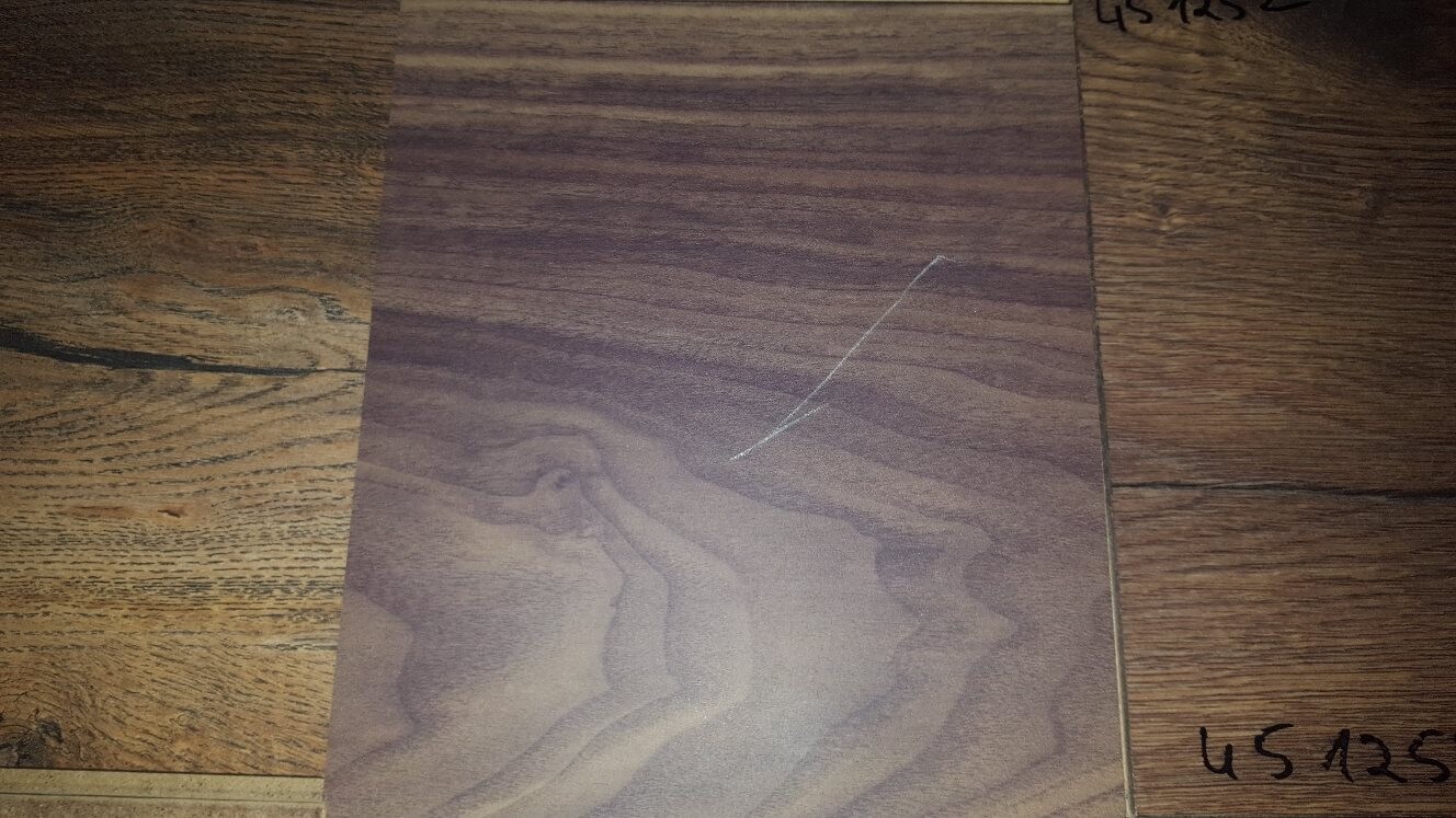

Chefschrauber8 Nov 2017 16:32I called ter Hürne today and explained the situation to them. The lady was very informative and told me that with the flooring— which is definitely not laminate—you can have fun with it as long as you handle it carefully. I believe her. I also appreciated that she didn’t try to present the flooring as exceptionally durable.
I wouldn’t go as far as to say that this is low-quality material. I would rather assume that this flooring is made or was made to feel particularly comfortable and warm, which has clearly been achieved. But to create this feeling, you have to accept a compromise—the trade-off of lower surface hardness and therefore less scratch resistance. That’s my idea about the more sensitive surface.
I’m uploading a picture of my sample with a scratch here.
I hereby confirm that I caused the scratch using an Ikea stool made of laminated wood; I did not use any metallic or other hard or sharp objects.
