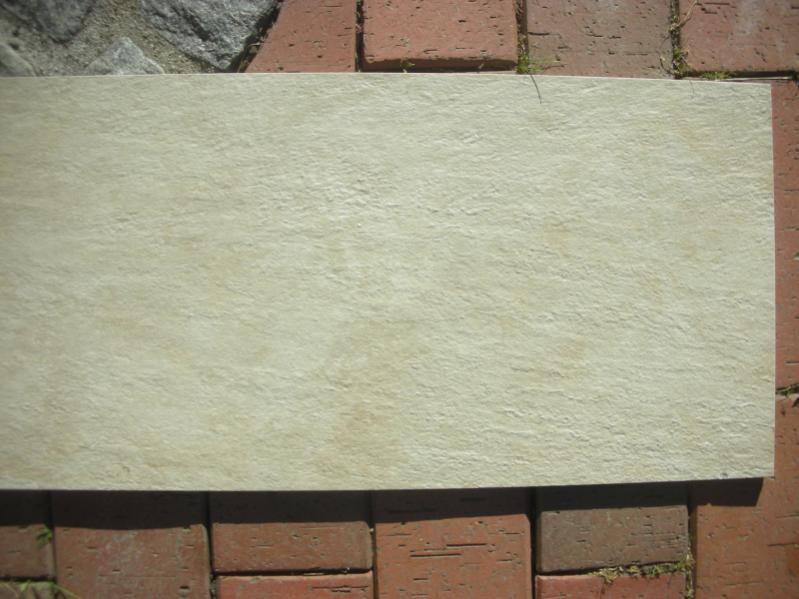

I have a porcelain stoneware tile that actually has a sort of slate-like surface. Here is a picture from my earlier selection phase (I photographed tiles, wallpapers, etc., under various lighting conditions to check whether I would still like them later 😉 ).

I have a porcelain stoneware tile that actually has a sort of slate-like surface. Here is a photo from my earlier selection phase (I took pictures of tiles, wallpapers, and so on under various lighting conditions to check if I still liked them later 😉 ).
OFFTOPIC ... phone signatures also annoy me a lot ... such an unnecessary, pointless text @winnetou78 😉Ours is very similar, Kerstin [emoji847]
@Arifas, this tile looks more like sandstone than slate

I thought the discussion was about the textured surface of the tile, which is supposed to resemble natural stone. And it does. But it’s not actually "real."
However, I will probably have to make a compromise anyway, because my husband finds the slate too uneven. For example, he is worried that chairs might catch on it when moved.
