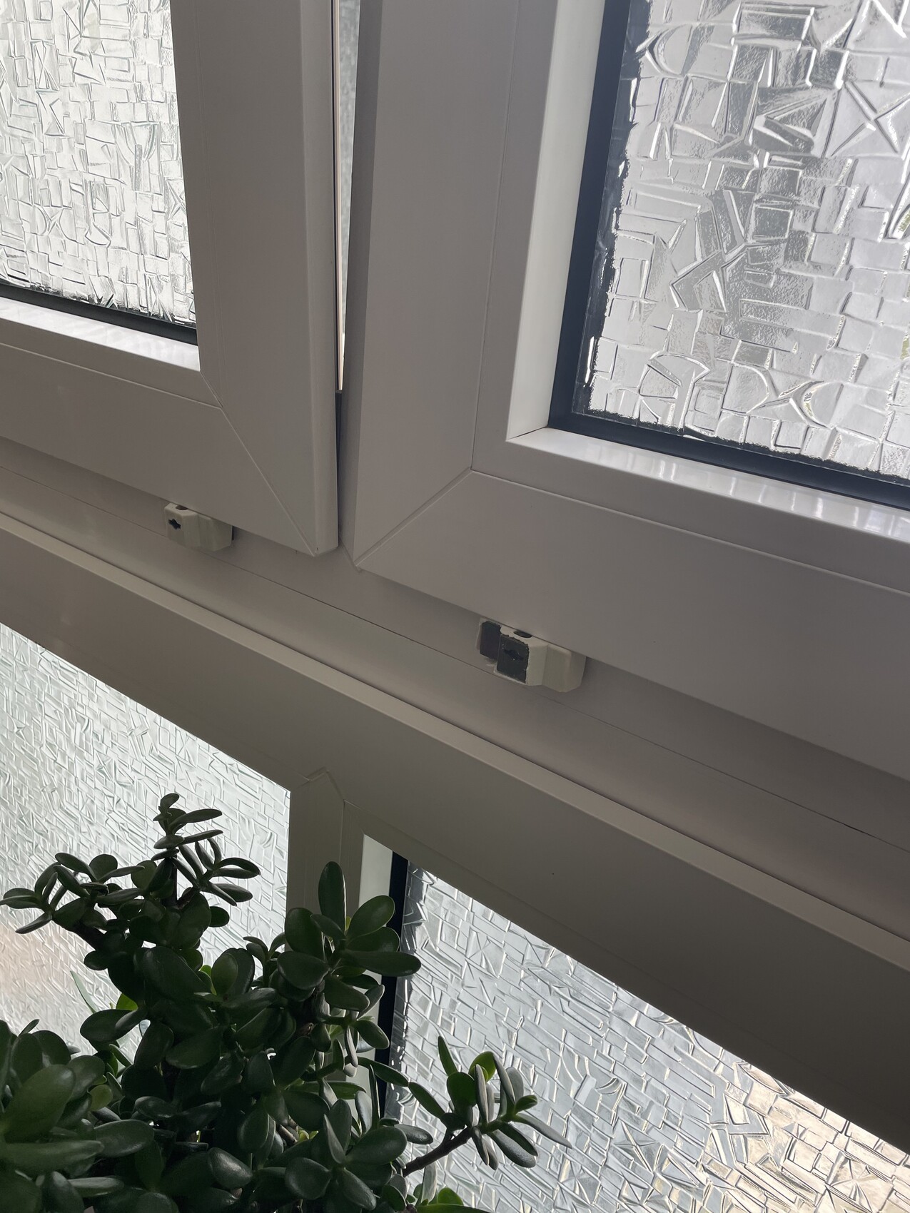

nordanney11 Jun 2021 13:44Reltaw2021 schrieb:
What is this? Could you please briefly describe it?In multi-family houses, for example, it’s quite common. It looks like this (I quickly took a photo of the hallway in my current building):R
Reltaw202111 Jun 2021 13:50Ah! I see! But I can’t apply THIS system to my plan, can I? Your windows have a transom.
