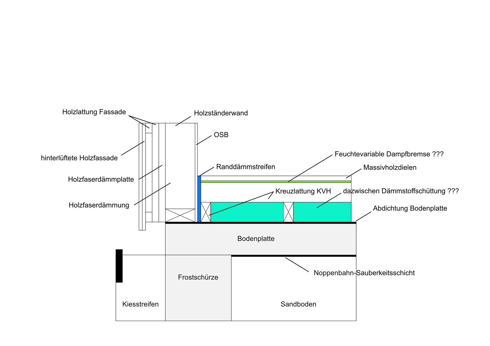

I have a question regarding the floor construction for an uninsulated concrete slab, see the sketch attached. We want to implement the following construction but have received somewhat different recommendations on certain details.
This mainly concerns which insulation material should be installed between the counter battens and whether a variable vapor retarder makes sense or not. The primary issue is the problematic transition from the cold concrete slab to the insulation.
Does anyone have practical experience with how such a setup can be executed in the best possible way?
