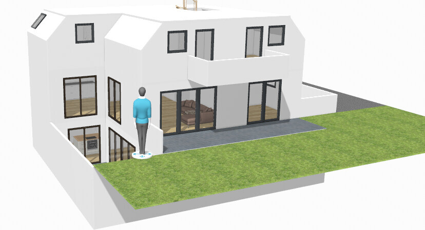

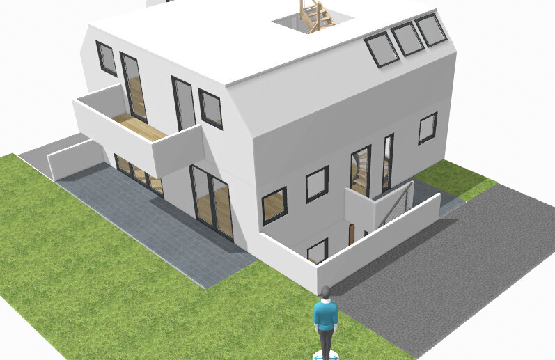

attached is our project with a request for suggestions for improvement, especially regarding the interior layout. The building permit application is currently in process, so please avoid complete redesign proposals for the building envelope, entrance, etc. Doors and walls can still be adjusted inside.
And yes, we are fully aware that this is a small constrained plot with limited garden space, but this is all we have here and we’re happy with it!

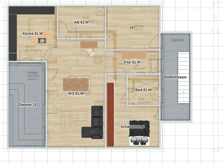

Basement, floors: Basement = self-contained apartment according to regional building codes, with separate entrance for permanent rental in the basement.
Number of occupants, ages: 2 adults + 2 children (4 and 1 year old), basement apartment: either 2 people or a shared office for 2 to max. 6 people

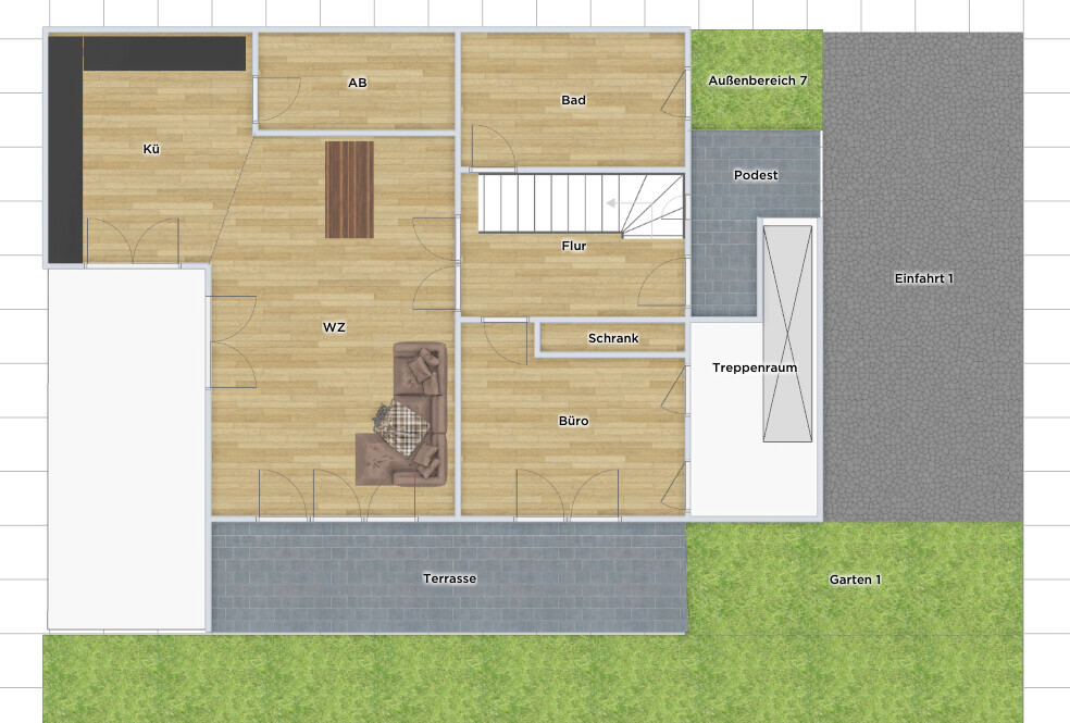

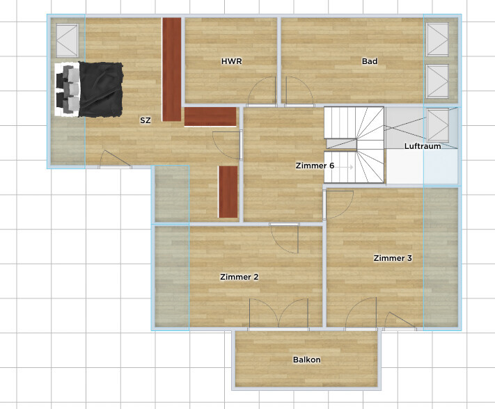

Space requirements on ground and upper floors: at least 120 m2 (1,292 sq ft). We have 165 m2 (1,776 sq ft) + 18 m2 (194 sq ft), so more than needed.
Office: Family use or home office? All three desired. One mixed-use room for home office and guests planned on the ground floor.

Additionally, we plan to convert the kitchen on the ground floor into a living room as we age and relocate the kitchen accordingly. Everything is optional, and planned with flexible plumbing. In the basement, we might still plan another room but are unsure of the location.
Is the size of the bathroom and hallway sufficient, or should we have it adjusted?
In the basement, we will add a south-facing window on the left side to brighten the basement apartment. This will reduce privacy and garden space but should please the basement occupants.

Myrna_Loy29 Aug 2022 22:23Although I feel the original poster may not want to hear criticism, here are a few comments regarding the floor plan. Why is there a bathtub in the ground floor bathroom, where the guest bathroom is usually located? If you want to enjoy a relaxing bath, would you want to walk through the hallway right by the front door? In a narrow bathroom with only a small window? And the kitchen offers very little storage and workspace for four people, with no proper pantry. (Unless the basement apartment is never intended as a separate dwelling, but rather as a questionable home office business use where you can easily set up storage rooms, so you don’t need storage upstairs... in that case, you don’t really need to discuss floor plans meant only for building authorities.) Why is there another office on the ground floor? You are building almost 300 square meters (3,229 square feet) and have space like in a small flat? Just to finance the build through rental income via the wife’s club?
