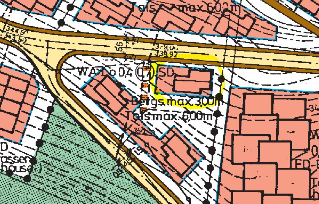

Zoning plan / restrictions
Plot size: approximately 640 m² (7,000 sq ft)
Slope: yes
Site occupancy index (floor area ratio): 0.4
Floor space index (FSI): 0.7
Setback from property boundary: 3 m (10 feet)
Number of floors: 1
Roof type: gable roof (24–30° pitch)
Orientation: ridge parallel to street
Eaves height on valley side: 3 m (10 feet)
Eaves height on hillside side: 6 m (20 feet)

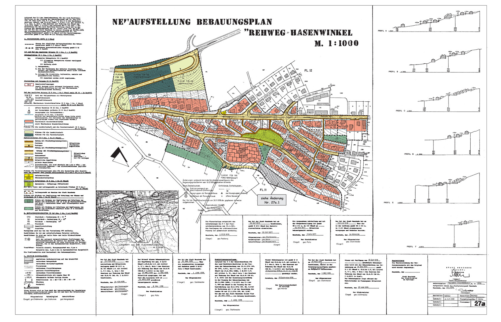

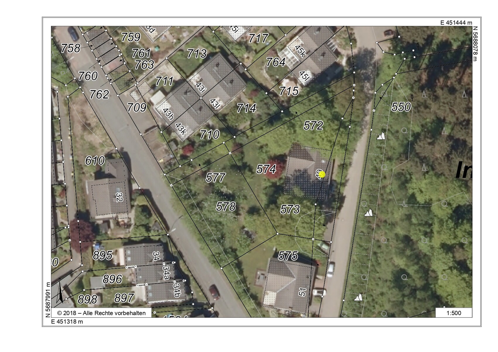

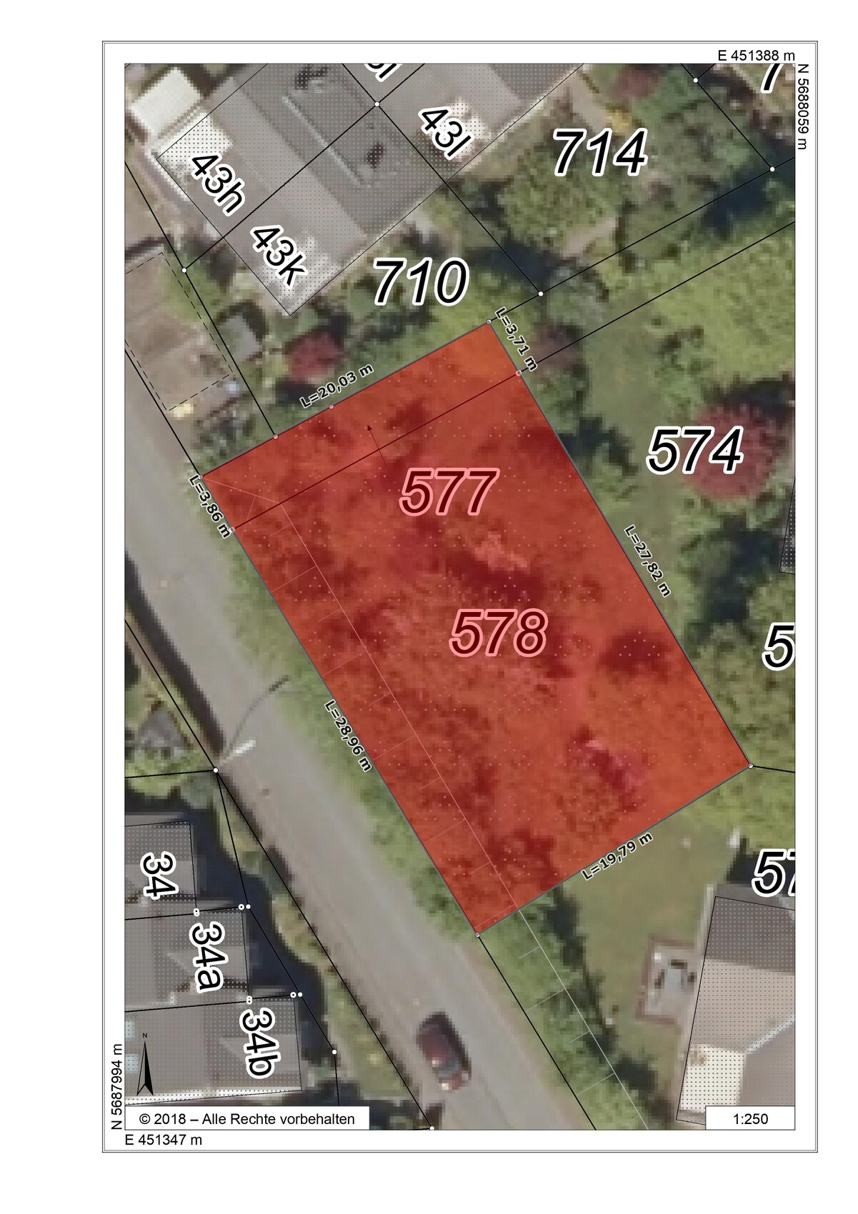

I will attach the zoning plan including the section to locate the plot, as well as aerial photos later.

So far, we’ve considered pushing the basement forward so that a terrace could be extended like a kind of balcony in front of the house at this offset. We enjoy the evening sun. Otherwise, I’m holding back ideas and waiting to see what the architect will answer tomorrow to the questions that have come up during the planning process.
Do you know floor plan designs with similar restrictions (slope, floor space index 0.7, eaves heights 3 m/6 m)? Or any other useful tips? The zoning plan is from 1978—can we negotiate with the city about these requirements?

derschwax23 Sep 2020 23:19Oh, somehow I mixed up all the values in the introduction...
Site occupancy index: 0.7
Floor area ratio: 0.4
Eaves height, valley side: 6m (20 feet)
Eaves height, hillside side: 3m (10 feet)
