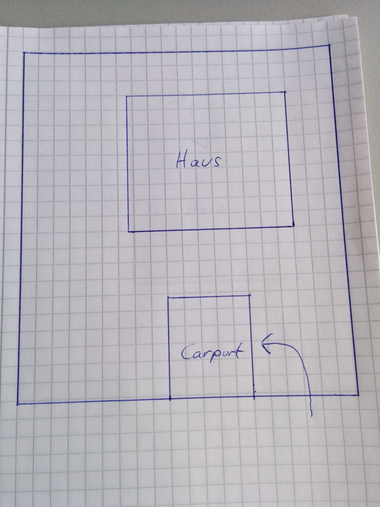

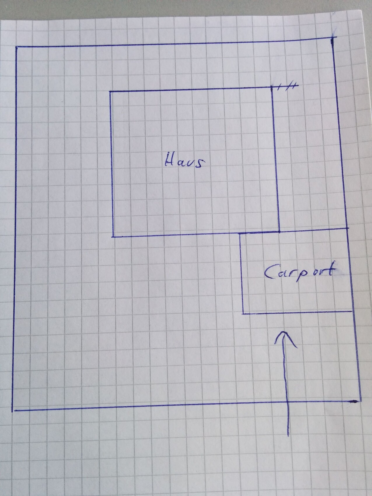

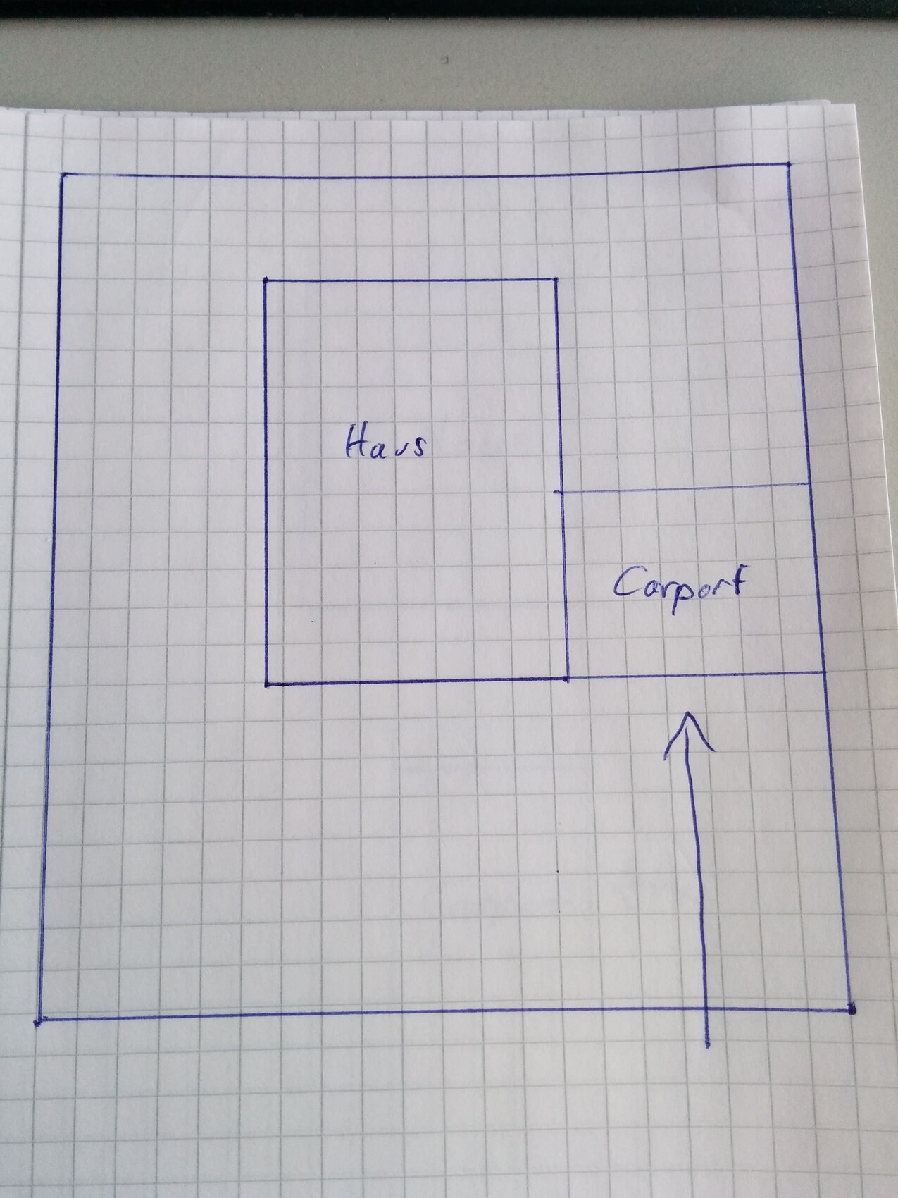

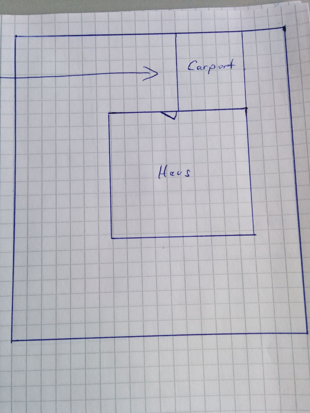

stefanvery2 Nov 2016 11:17ypg schrieb:
On the other hand, I would be interested in the age or generation of the family council who think that floor-to-ceiling windows take up usable space. My parents thought floor-to-ceiling windows would look nice. We ourselves find non-floor-to-ceiling windows much more practical.
I tend to go for a maximum house width of 7.5 meters. But that’s not available in an affordable standard design. It doesn’t have to be an affordable “standard” design, we have also contacted companies for custom plans. However, I wouldn’t be so keen on 7.5m width with 12m depth, because that would make the gable quite tall. Fortunately, we are allowed to rotate the house exactly 90°. That would solve the gable issue, but I still think a more balanced ratio of width to depth looks better.
So either mirror everything along the diagonal, resulting in the driveway coming from the west, or have the carport in front near the street so you have to turn 90 degrees left from the driveway into the carport. We hadn’t thought about rotating the carport by 90°. Whether we like it or not—time will tell—I would say it’s just as imperfect as the other options.
I roughly sketched out the different options on paper again. Did I interpret your two proposals correctly?
For the versions with the carport next to the house, we don’t like the long driveway either, especially since we are only allowed very limited building coverage.
For the carport at the top (northwest), I wonder if that works well with the sloping terrain. We would want to place the carport right at the boundary line up there. So, at that point, we’re about 1.40m (1.5 yards) higher than at the southeastern boundary. Since the ground level at the boundary cannot be altered—not even by supporting structures—the carport would have to be at least around +1.20m (4 feet) in height. In my opinion, the adjacent house would need to be at the same height, also +1.20m (4 feet). Then, without a basement, it would stand high above the plot.
If the carport is placed down at the southeast, it might be somewhat lower than the house, which seems better to me than the other way around.
Regarding the upper floor: Plan for both children’s rooms facing west, each around 15 m² (160 ft²). That could free up space for a decent storage room.
Downstairs, the utility room and the office should also be accommodated in appropriate sizes.
That isn’t the original floor plan, is it? No, the floor plan was drawn completely freehand. At some point, we realized that we could fit the result within the standard external dimensions of the Flair design. To compare prices more easily, we initially focused all our inquiries on these external dimensions.
Of course, I would like a more balanced distribution of room sizes too. We already tried several other floor plan variations. But something was always off, for example, the entrance area would be too narrow inside the house, etc. We’ll have to think it over again.
Thanks for your feedback! (Even though it unfortunately confirms my doubts.)
