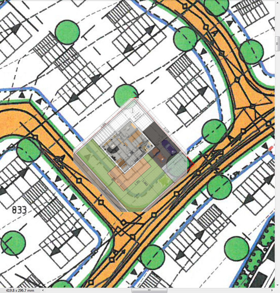

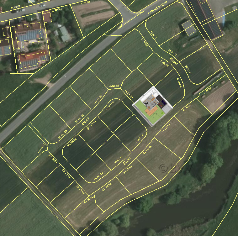

RobsonMKK schrieb:
Could you overlay the floor plan onto the section of the plan?
I'm having a hard time visualizing it right now.
Sure

RobsonMKK1 Nov 2016 16:30
Just to ask plainly: are you even allowed to access the property from that side?
To me, the plan initially looks like it is predetermined.
stefanvery
1 Nov 2016 16:34
RobsonMKK schrieb:
Just a simple question: are you even allowed to access the property from that side?
From the plan, it looks like it might be predetermined.
I asked the building authority, and they said:
"The driveway can also be placed elsewhere, but not in a curve area. The junction area of the two roads must be kept clear in any case. If there are no other deviations from the development plan, in our opinion, the construction project can be carried out through the approval exemption procedure. Ultimately, it is up to your planner to decide whether to apply for a formal approval or not."
Maybe a quick explanation of why the carport is located below instead of above.
Placing it above would either mean at least 6m (20 feet) of space above the house, which would reduce our garden area towards the southeast. Or above in front of the house, in the upper left corner of the pictures. However, in that case, there wouldn’t be any space left for visitor parking in front of the carport. Also, from our layperson’s perspective, the slope at the current position is easier to balance than at the top.
