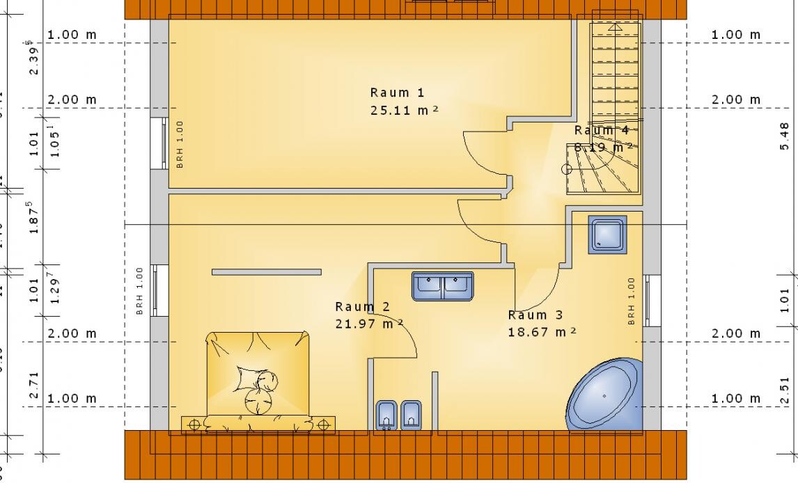

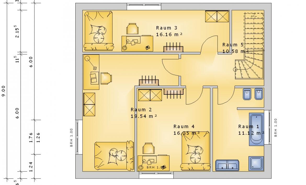

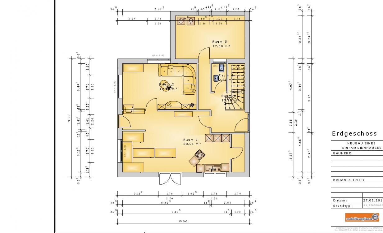

Hello Forum,
Here are my first drafts for a single-family house without a basement and without a garage.
Please let me know what you think and where I can improve.
Leon
2D floor plan of a house with three rooms, stairs, and bathroom
Floor plan of a single-family house, ground floor with living room and kitchen (highlighted in yellow)
2D floor plan of a house with five rooms, stairs, bathroom, kitchen, and entrance area.

Where is the whole family supposed to eat? With 3-4 children's bedrooms, I assume there are 3-4 children. But you only have space for 4 people at the dining table...
Bay window facing north?
What else can be said? This is probably one of the worst designs ever.

Hello ypg and Fiddy. First of all, I never claimed that the second design was mine. Besides, I wonder what difference that would make. And a scanned sheet... really, let’s stay grounded! Who cares about that? The "scanned" floor plan is the initial rough draft from an architect (a very sought-after one at that). Which again brings me to the question of why some feel entitled to call it "terrible" (especially since the house is far from fully planned and hasn’t even been adapted to the plot yet – forget about the north side).

Oh man, Fiddy, there are four chairs… you’re right! PLUS a corner bench (obvious to anyone paying close attention)! That makes enough seating. Plus repositioning the table, plus extending the table, plus adding another table, and so on… when family gatherings happen again.

I hardly believe that either, because an architect, no matter how good or bad, would normally plan chimneys and downpipes, among other things.
If there is supposed to be a tiled stove between the dining and living rooms, then a) the hallway in between is too narrow and b) a chimney is missing. If you were to include a ventilation duct, it would run in front of a child’s bedroom window and through the parents’ bedroom. Then the drawing no longer makes sense. The pantry is too large, but the kitchen is barely usable, with no workspace. The stove is right next to the sink, which is also not common practice.
Otherwise, I don’t find it that bad, although given the possibilities (area, footprint), I would expect more creativity from an architect.
I also don’t understand the bay window.

The green dot next to the stove is meant to represent an external chimney. The bay window was already removed in the revised version because, as you mentioned, we didn’t understand it either. I suppose it’s a small example of architectural freedom (and I’ve seen so many strange plans that made no sense and were structurally questionable, yet somehow earned the architect a peculiar award).
In our current house, we also have the stove next to the sink and haven’t noticed any drawbacks so far.
The size of the kitchen is definitely a point that needs to be discussed again.
I much prefer this kind of conversation because it allows others to reconsider what seems like a very good plan. Thank you for your helpful input!

No... I’m not a fan of destructive criticism... I’ve been a victim of such comments myself as the person asking the question. What’s the point of a “crappy” comment if you don’t know why! 🙁
Now I can recognize the stove pipe.
Cooking and washing up are like fire and water... you don’t do them at the same time; there are basic principles for a functional, ideal kitchen. You can look them up easily 🙂
Anyway, there’s a new plan, so the cramped kitchen space will be resolved too 😎
