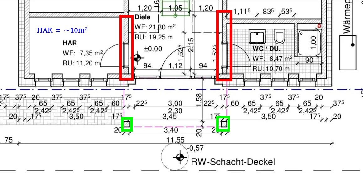

I would like to ask the floor plan experts for advice here. 🙂
I have designed a single-family house and encountered a problem. Currently, I have planned a continuous front with the main entrance door and windows in the entrance area. On the upper floor, I have planned an open space (void) above the entrance door area.
Due to rain and because the front door faces west, I have now decided to add a canopy. Here is where the problem starts.
I want to have a concrete canopy supported by two posts. However, the open space is exactly in that area, so I cannot use existing support walls or columns. Do you have any ideas on how I can install a canopy there without losing the open space?
Attached you will find my floor plans for the ground floor and upper floor, as well as an image of the canopy as I envision it.
I would really appreciate any help!

Hello Freistoß88,
I’m not an expert myself, a complete beginner, and I’m also planning to build a city villa while considering different floor plans.
Regarding your question, see the attached image—I would widen the 17.5cm (7 inches) walls to 24cm (9.5 inches) and embed a horizontal beam that extends forward and rests on the vertical columns (green).
That should effectively support the load from the roof slab, right?
Is that the company Q-Logic from Düren? Maybe they use such reinforcements.
