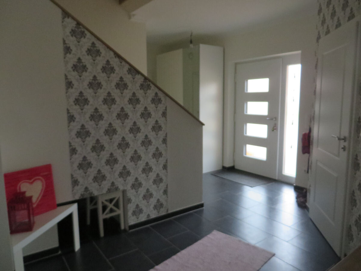

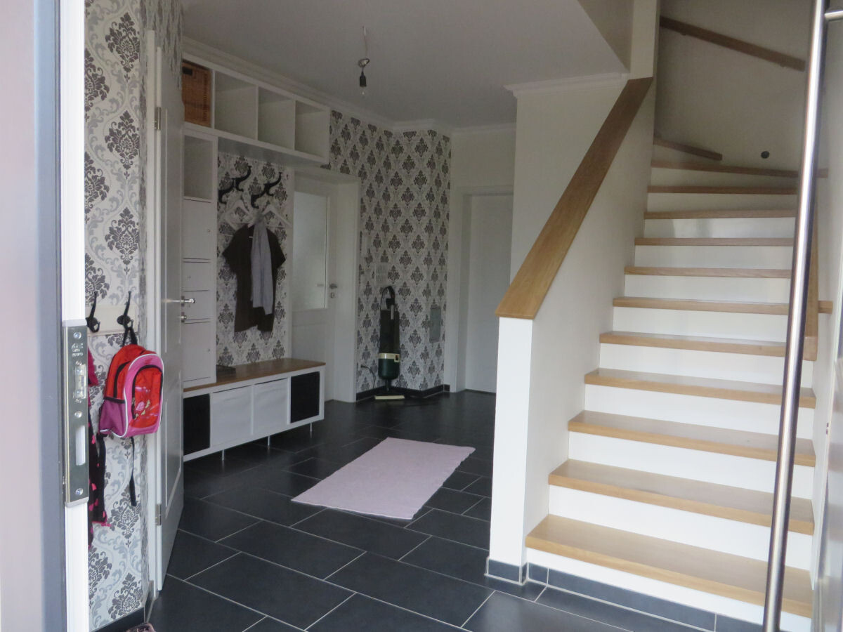

For example, I would have gotten rid of the bulky wardrobe, or at least found a different place for it.The wardrobe is new. And it’s not noticeable at all. When you enter the front door or just open it, you don’t see it. I’ve added two pictures of our hallway: one from the entrance and one showing the wardrobe’s position more clearly. The doors next to and opposite the wardrobe (used only for seasonal jackets and only by the house’s residents) lead to the utility room and office. Please disregard the runner and vacuum cleaner for now. And we have now also invested in a doormat inside the front door.

But does it really not matter where the staircase starts, or am I just completely confused today...?No, it does matter, and I can understand Manu’s point. However, I also think that sometimes it’s the "lesser" problem. I like that she brings it up because it’s not something you immediately think about, and it helps you consider whether it would actually bother you.
Example in winter with the staircase starting near the front door:
1. You enter the house with wet, dirty shoes. They are usually taken off close to the front door, so you inevitably walk several times back and forth between the entrance and the start of the staircase until you’ve taken them off (or helped the kids take off their shoes).
2. In the evening, when you want to go from the ground floor (GF) to the upper floor (UF) in slippers or socks, you have to walk through the area where you just had wet, dirty shoes on, which means you track dirt upstairs.
If the hallway is large enough, or if the shoes are stored so conveniently that no dirt ends up between the staircase and the front door, then this is definitely not a problem.

Very nice hallway, I really like it. I also find the staircase with the LEDs nicely designed. The tiles are easy to clean.
