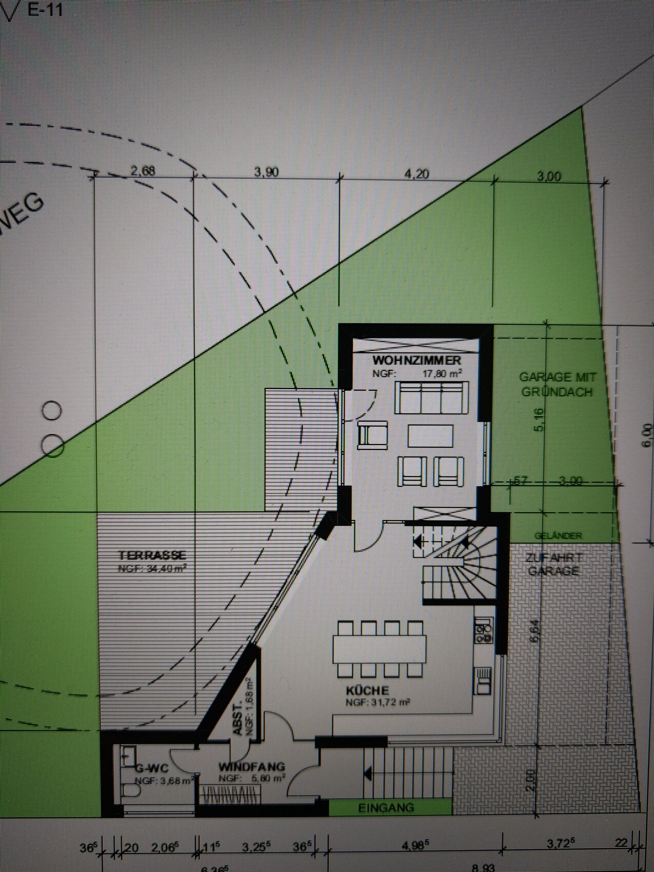

Hello everyone!
We have purchased a triangular plot of land. As if that weren’t complicated enough, there is also a large oak tree that must be considered during the planning. In our initial considerations, it quickly became clear that the floor plan will have an L-shape.
Does anyone here have experience with this type of plot and a correspondingly shaped floor plan? What additional information is needed to get meaningful advice?

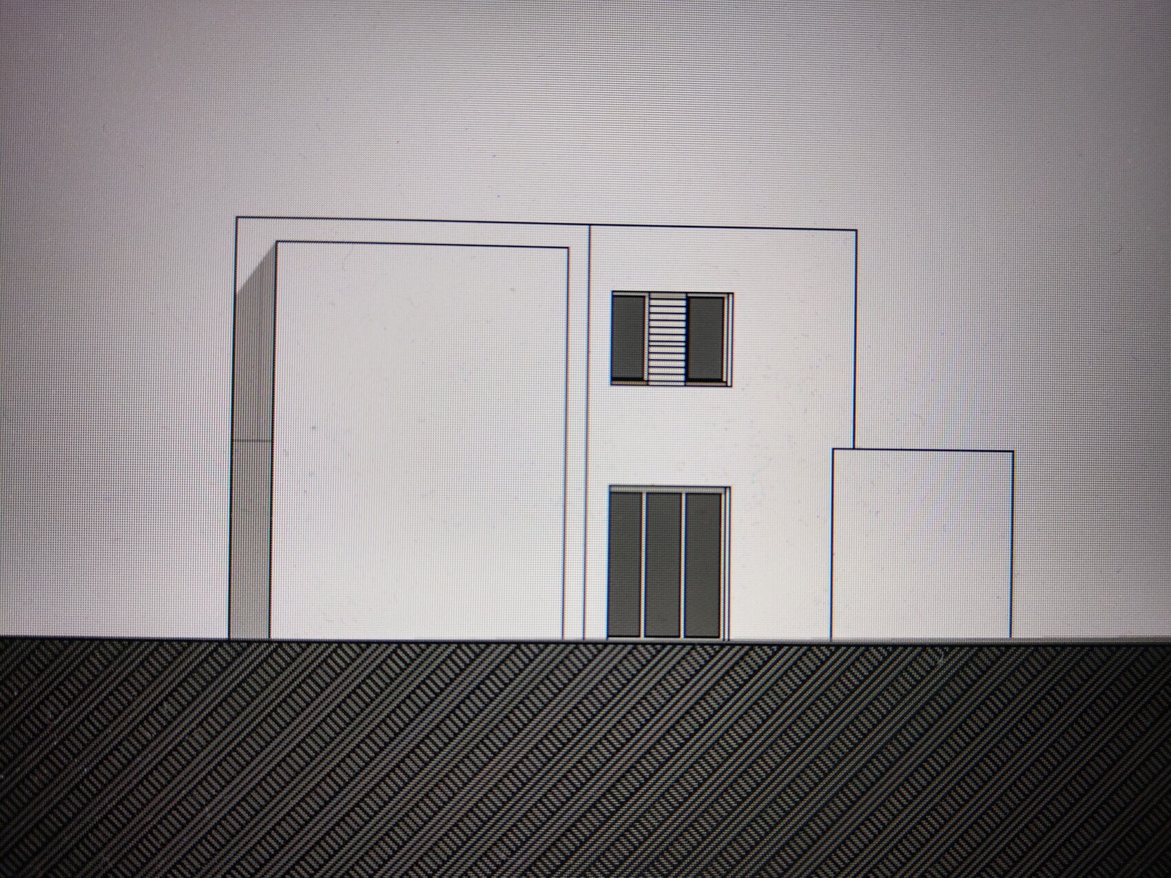

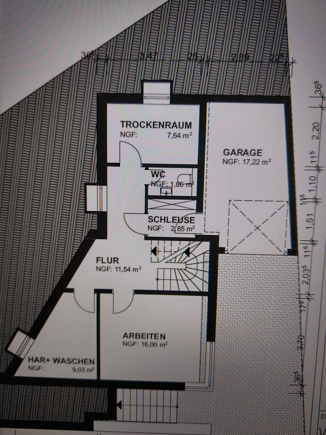

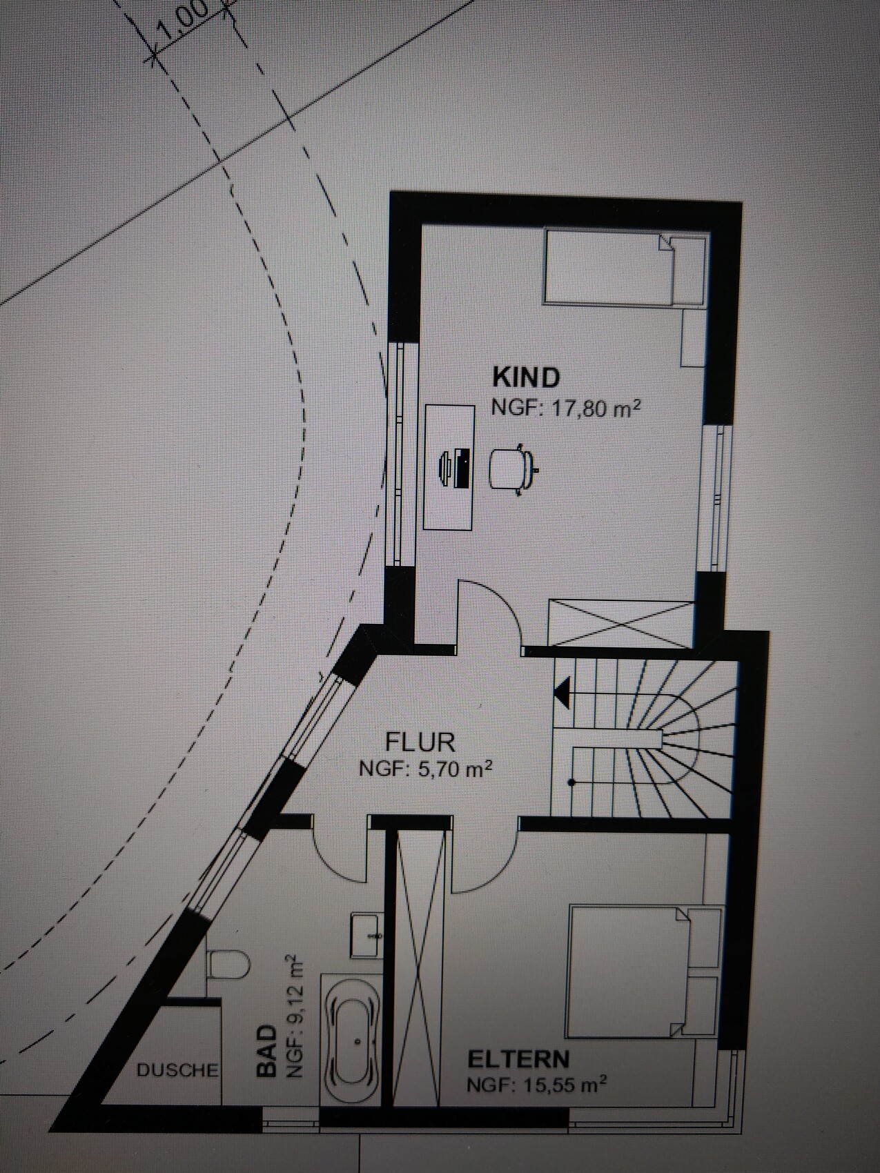

Matthew0310 Jan 2019 11:42And why don’t you share the view from the other side? There must already be a floor plan for that, right? I’m sure everyone who has taken the time to help over more than 40 pages here would be interested...
haydee schrieb:
To me, the entrance and the garage look like simply attached building blocksThis is due to the fact that we need to make the most of the setback areas.
haydee schrieb:
The main entrance only accessible by stairs—my parents and in-laws have this, and I find it impractical.Yes, making it barrier-free would be preferable for us as well. Maybe I’ll have another draft made without the garage. Then the entrance area could be built on the east side...
haydee schrieb:
I also don’t like the basement windowYes, I don’t like that window either. Maybe it would look better if the window sill were raised by half a meter (20 inches). And it doesn’t necessarily have to be around the corner.
By the way, no granny flat or separate apartment is planned in the basement...
