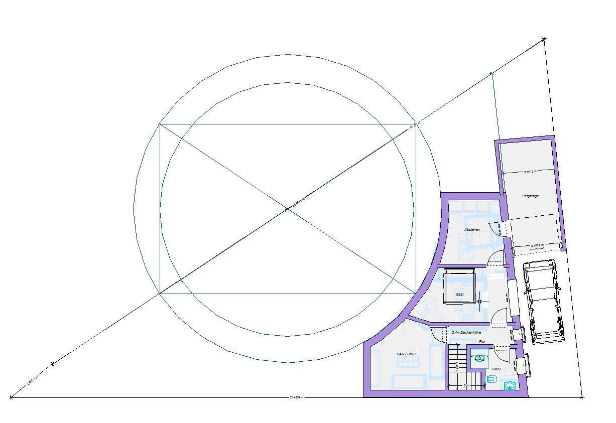

The original poster mentioned wanting 2 floors plus a basement and underground garage. The problem is not just the tree (although without it, the project would be almost easy). The property boundary is also not at right angles. So, to make full use of the lot, you would probably need to build something truly spectacular, with hardly any right angles and a curved section around the tree. Mottenhausen already hinted at this. I’ll add some thoughts:
Architectural floor plan: large circular center, rectangular interior space, garage extension.
[italic]Overview[/italic]
Floor plan of a building with underground garage, storage, guest room, utility/technical room, corridor and guest WC.
[italic]The underground garage is also quite questionable, especially since in this layout you’d have to rush past the entrance door, which is really risky. That’s why I would usually place the garage on the ground floor. But then the guest room loses its window. Well...[/italic]

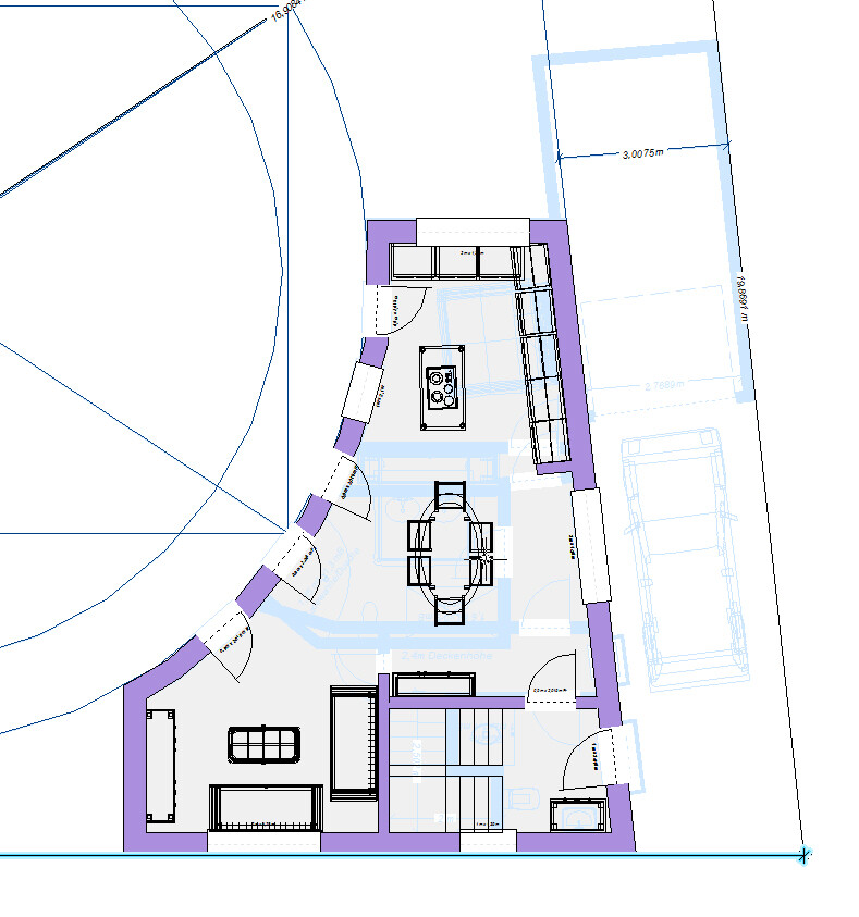

Architectural plan with open kitchen, dining area, lounge and right-side garage.
[italic]I would swap the kitchen and living area here, but the OP wanted the kitchen on the north side.[/italic]

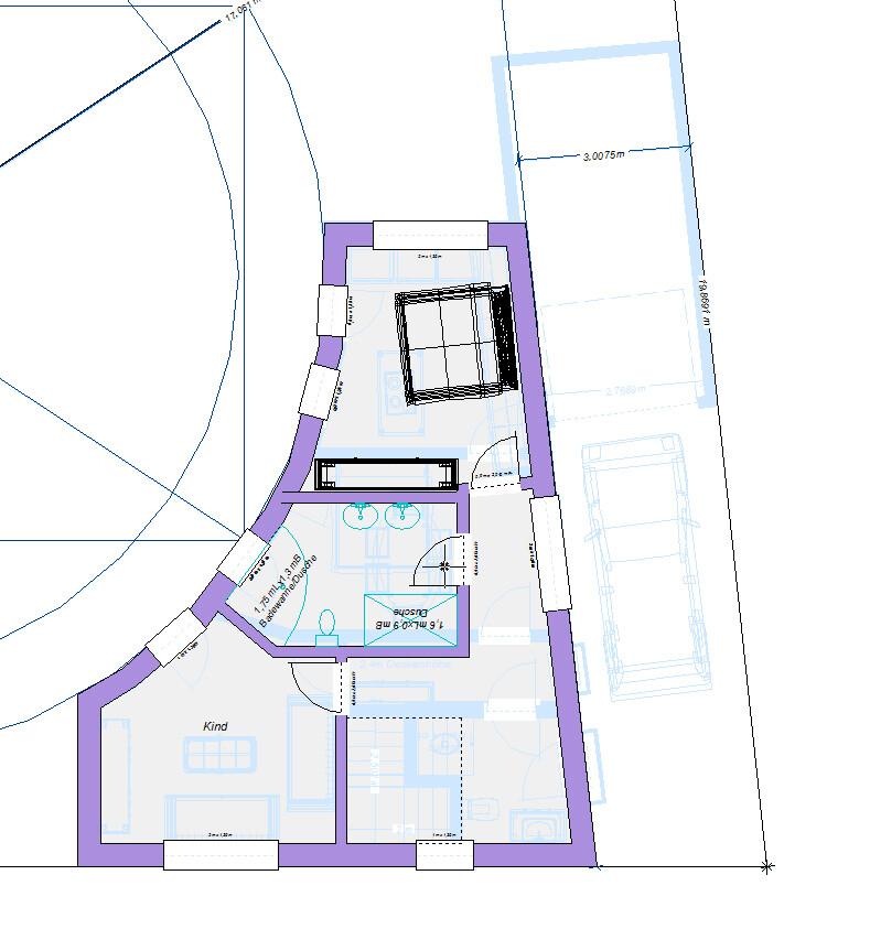

Floor plan of a house with purple external walls, children’s room bottom left, bathroom and corridor, staircase in the center.
Of course, this is just a concept, aside from the fact that it would be extremely expensive and we don’t really know what the OP’s actual needs are.
