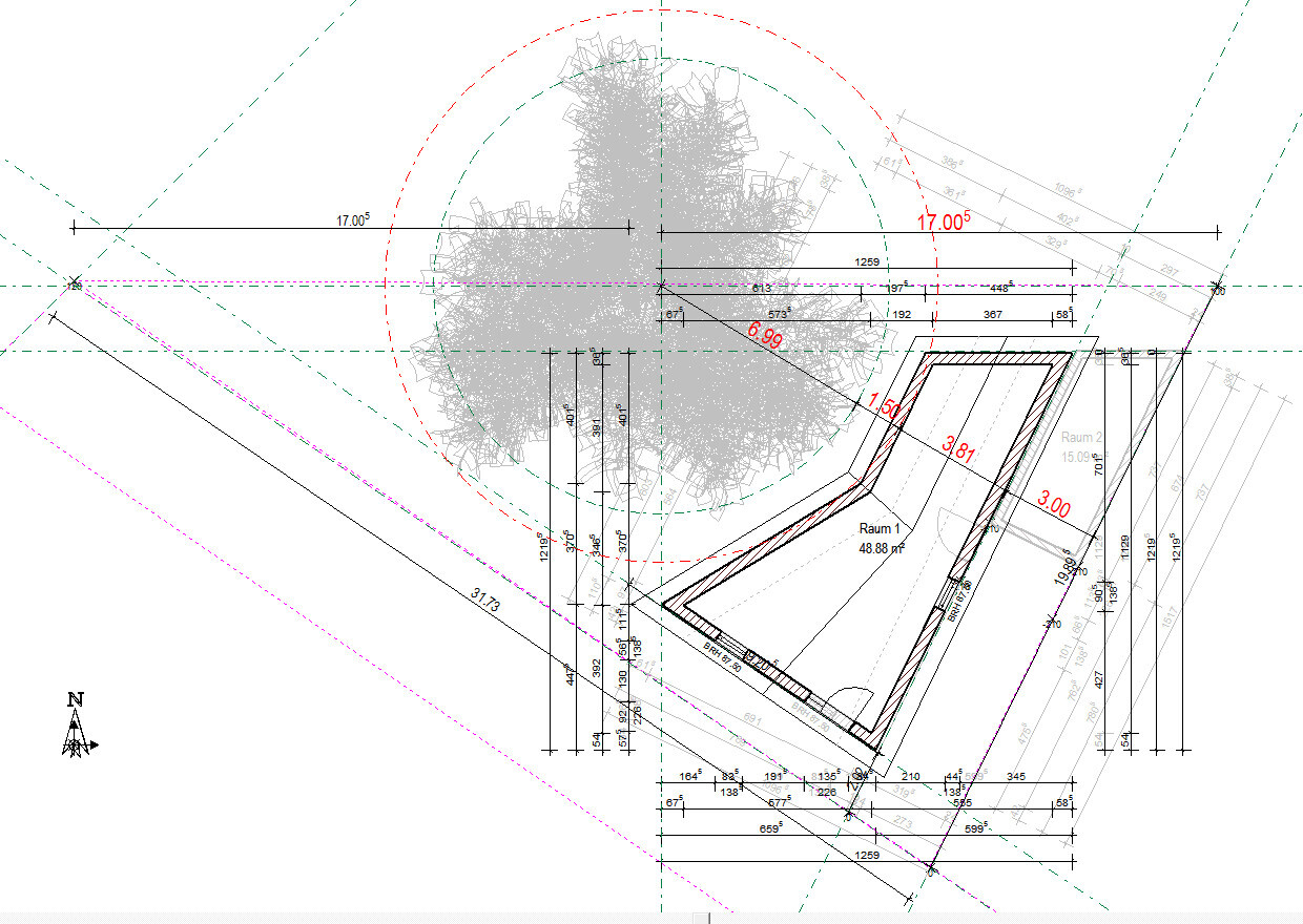

14 Nov 2018 00:01
Tree relocated ... still on the property boundary since the exact location is not known. From there, a radius of 7 m (23 ft) and 8.5 m (28 ft). The house floor plan is still based on the previous oak tree position. It’s clear that the space will become even tighter because the house is already within the additional 1.5 m (5 ft) radius.

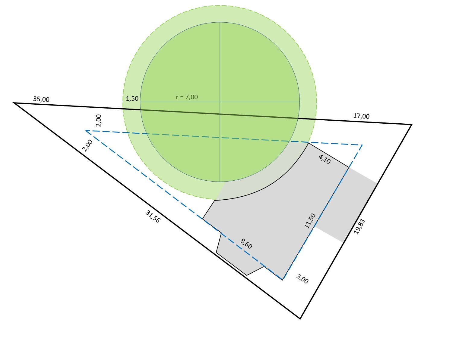

14 Nov 2018 00:30
a little sketch from me:
Technical drawing: triangular floor plan with green circle, gray polygon, blue guide lines and measurements.

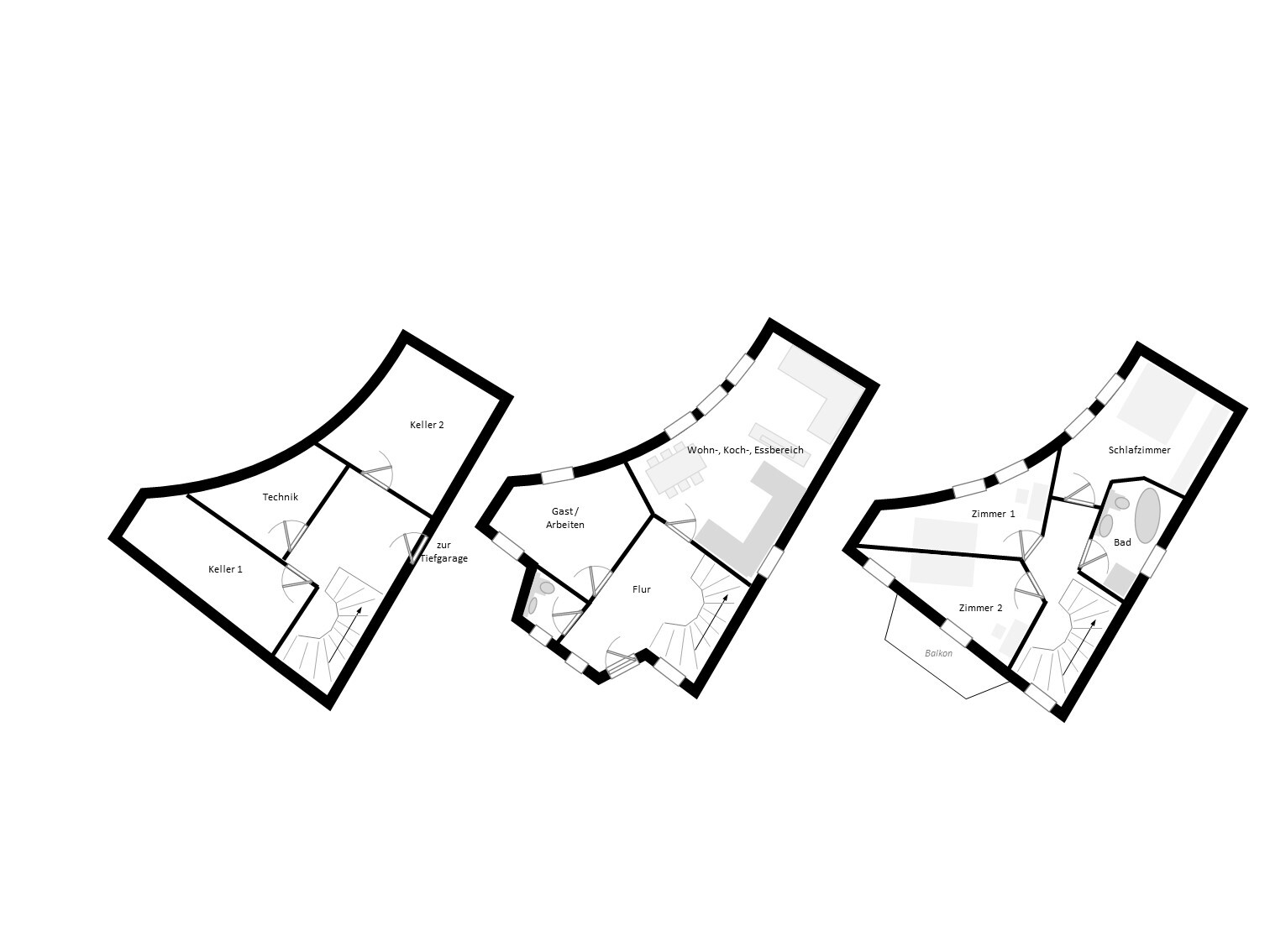

it would be good if you could do without the 1.5m (5 feet) clearance to the tree
this way, you would still have the 1.5m (5 feet) added to the 7m (23 feet) radius around the trunk:
Three floor plans of a house: basement, utility room, living/kitchen area, hallway, bedroom and bathroom.
I would still avoid building there. That costs a fortune!
