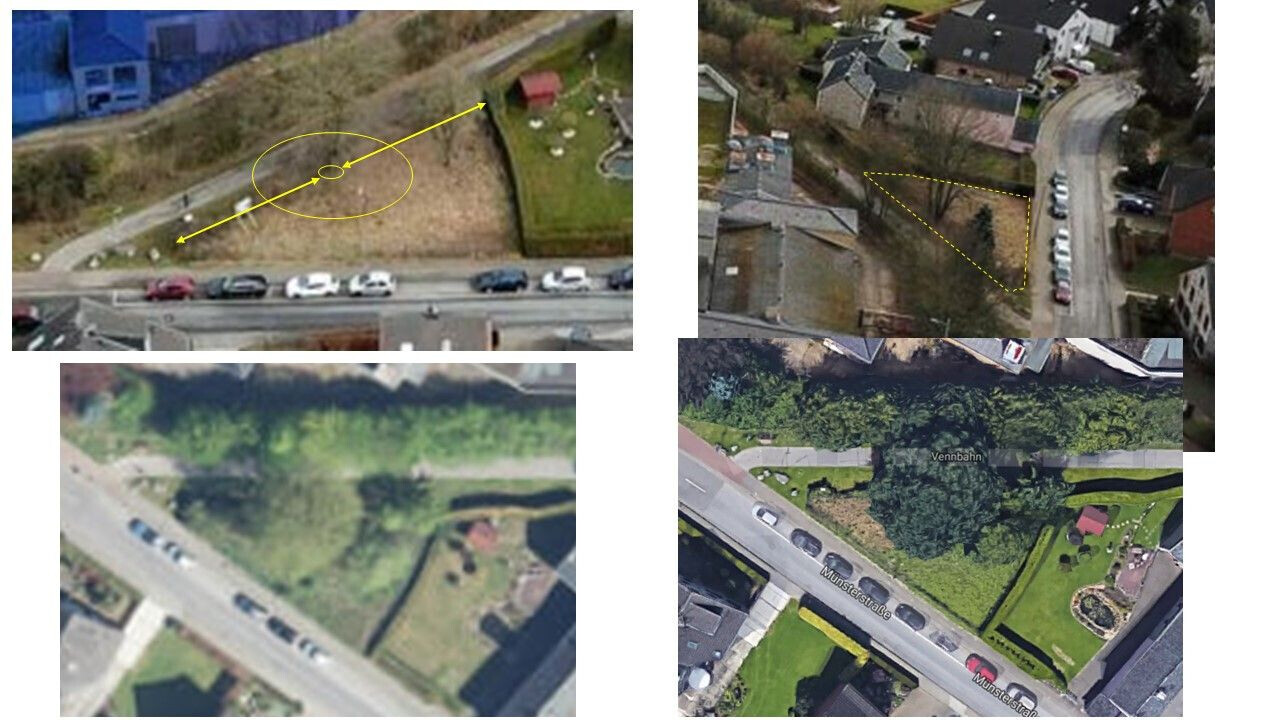

We have purchased a triangular plot of land. As if that weren’t complicated enough, there is also a large oak tree that must be considered during the planning. In our initial considerations, it quickly became clear that the floor plan will have an L-shape.
Does anyone here have experience with this type of plot and a correspondingly shaped floor plan? What additional information is needed to get meaningful advice?

Elevations: 252.56 left, 252.31 top, and 251.35 bottom. I’ve found it again now... it’s just unfortunate that not all the information is combined in ONE post.
It’s not that much, but the issue with supporting the neighboring property will remain, and windows cannot be installed in the basement without additional excavation of the terrain... and this is 2 meters (6.5 feet) away from the sidewalk.

There won’t be any more windows in the basement without additional excavation of the surrounding ground I was thinking of strip windows facing the street and excavation towards the west.

@Oakland ... then get serious ... we need exact measurements ... exactly where the oak tree is located, etc.
And then sketch out how you imagine it. Your underground garage also needs a reasonably decent entrance with not too steep a slope, otherwise there will be issues with the car’s front bumper and so on.The oak tree is located—by the way, not on the property—17 meters (56 feet) away to the east.
If we position the underground garage (6 meters (20 feet)) as close as possible to the northern property boundary, the driveway slope should be relatively gentle.
