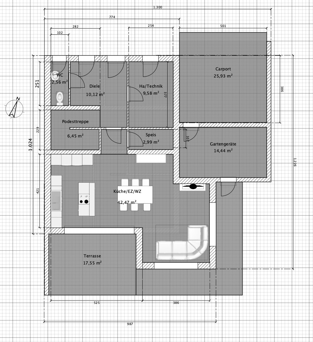

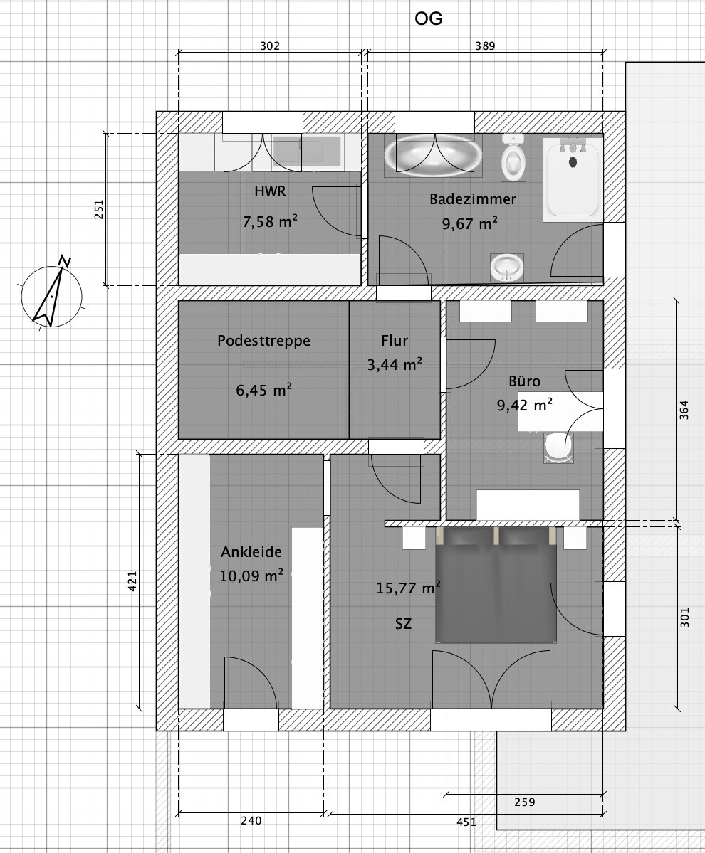

we have been following this forum for some time now and have finally received our first draft from the architect. We are not entirely satisfied and wanted to ask for advice here before our next meeting with the architect.
We were unsure whether we are allowed to post the architect’s plan here directly, so we redrafted it ourselves, but the most important details should still be visible.

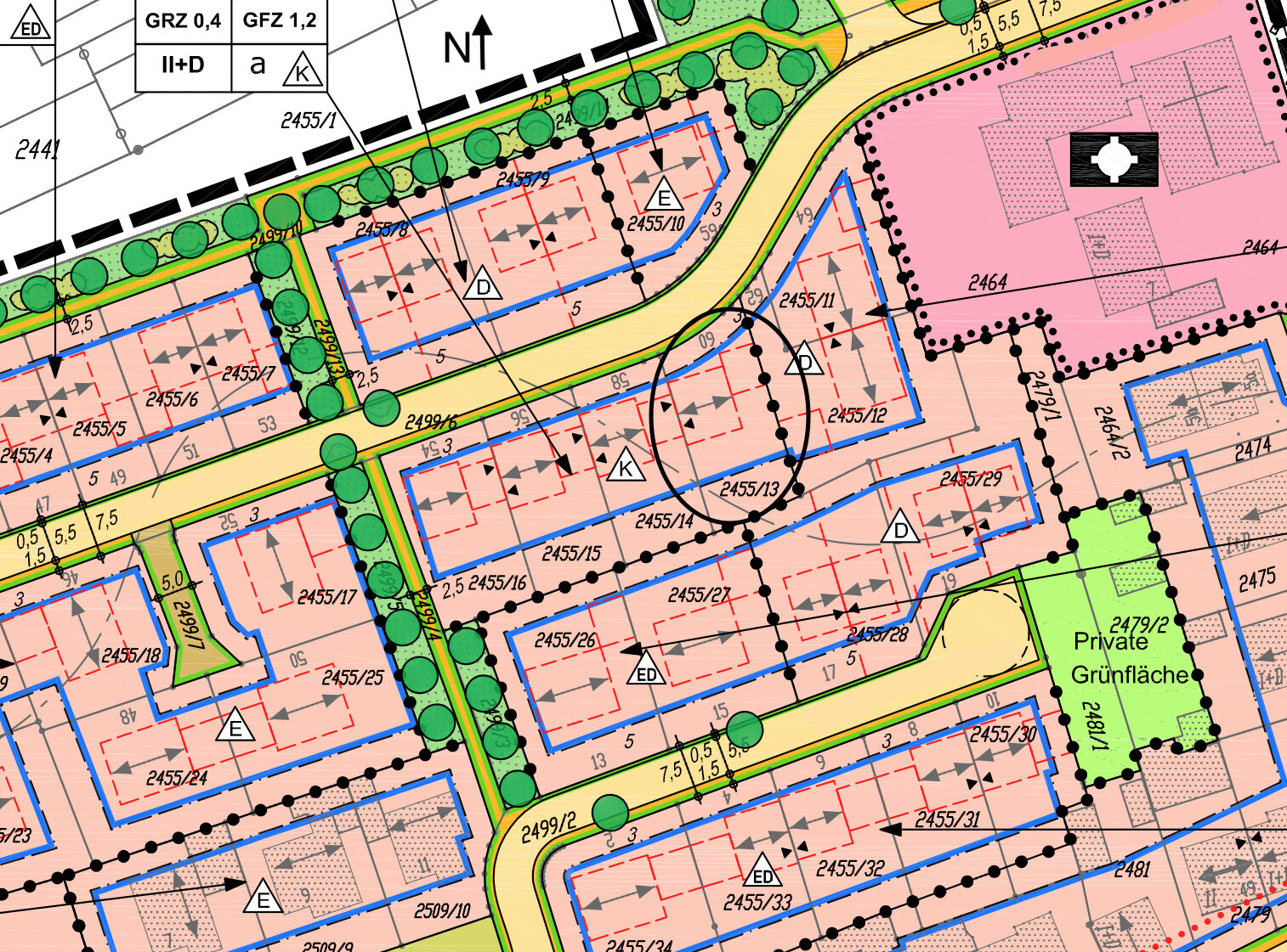

Plot size: 350m2 (3,767 sq ft)
Slope: no
Site coverage ratio (floor area ratio for ground area): 0.4
Floor area ratio (total floor area in relation to plot size): 1.2
Building envelope, building line and boundary line
Edge development: yes
Number of floors: 2 + attic
Roof type: gable roof with 46° pitch
Architectural style: ?
Orientation
Maximum heights / limits: wall height up to 7.5m (25 ft) above street level, house length directly affects roof height due to fixed roof pitch and thus influences setback distances.
Other requirements: terraced development pattern (house/garage/house/garage…), fire separation wall without windows on the west side

Who created the design: architect, first draft
What do you not like? Why?
Window arrangement (exterior view)
Ground floor: living room is too small, guest WC too narrow
Upper floor: access to laundry room through the bathroom, too many doors in the bedroom (doors to bedroom and walk-in closet to be removed)

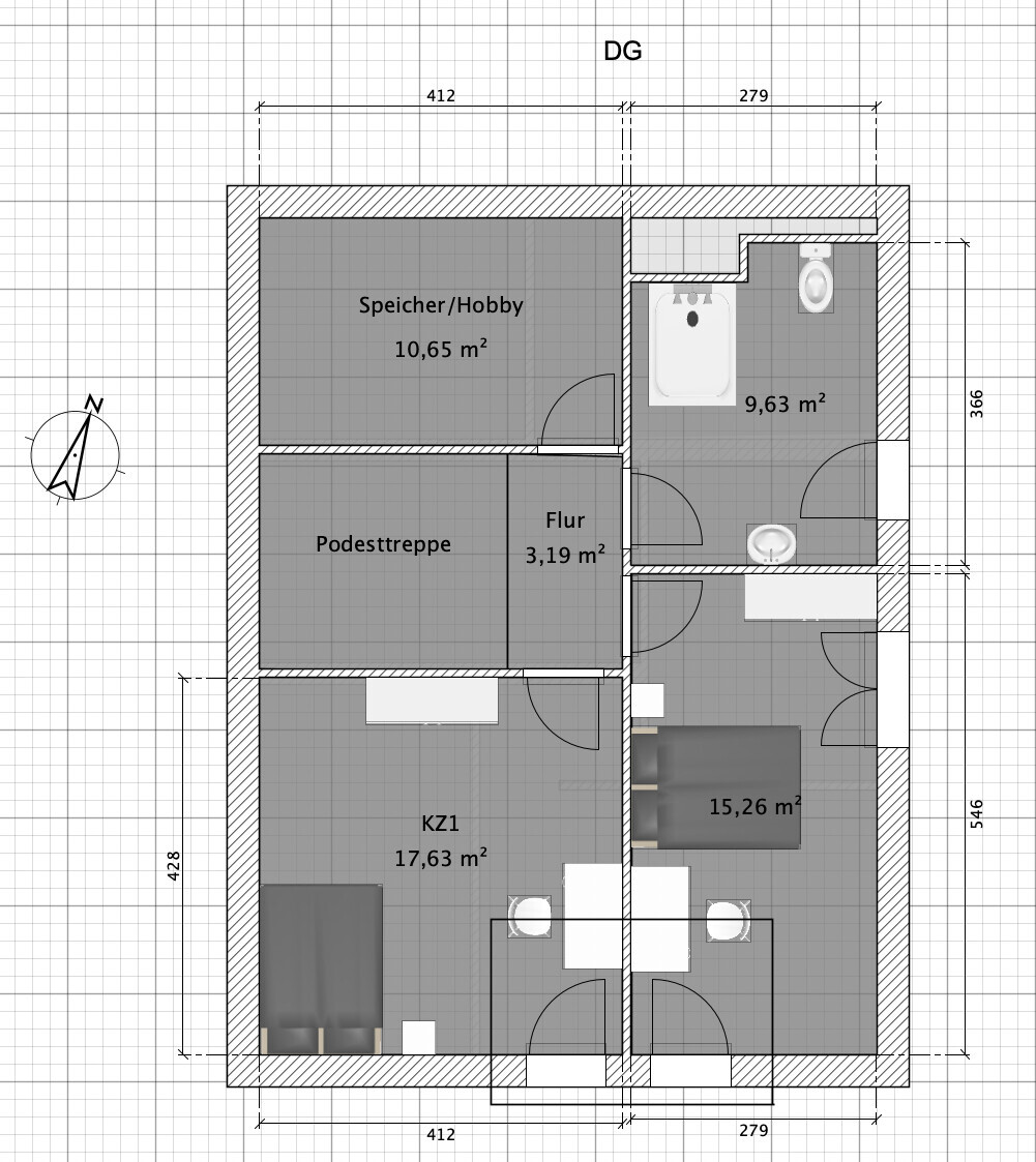

Attic floor: children’s room 1 has only one window, knee wall only 0.75m (2.5 ft); we will increase it to 1.1m (3.6 ft), cross gable not symmetrical, cross gable might be omitted to save space for more photovoltaic panels
The attic floor will be completely redesigned. Children’s rooms on the east side, bathroom in the northwest, and storage in the southwest.
Cost estimate according to architect/planner: €550,000
Personal budget for the house including fittings: €450,000 (including owner contributions)
Preferred heating technology: ground-source heat pump + photovoltaic, probably air-to-water heat pump + photovoltaic for cost reasons
If you have to give up something, on which details/additional features
-can you give up: kitchen island, bathtub
-can you not give up:
Why is the design the way it is now? For example:
Which wishes were implemented by the architect? The architect’s room program was implemented.
We initially only considered a rectangular house; with the cube shape we gain some space on the ground floor and a double carport is possible. Also, with the current height (12.25m / 40 ft), the house must be at least 4.9m (16 ft) away from the neighboring property (12.25 * 0.4) according to regulations.
How can we best arrange the ground floor so that especially the living room doesn’t feel cramped?
We are also considering extending the house by 11m (36 ft).

I would send the architect back to the drawing board completely, as too many things don’t fit.
Ground floor:
- Pantry too narrow and located away from the kitchen
- Projected living room adds no real value
- Multi-purpose room too small for such a layout that requires many circulation areas, with hardly any closet or usable space
- Guest toilet very small
Upper floor:
- Laundry room next to the bathroom creates disturbances (and it’s inconvenient: imagine sorting laundry and your partner needs to use the bathroom—should both doors be locked, leaving you trapped, or should you surprise them while in the laundry room?)
- Bedroom: You walk straight into a wall
- I would add a window to the staircase to avoid darkness there (regardless of the floor level)
Attic:
- A hobby room without a window is only suitable for dark arts
- The unlabeled children’s room on the right is very narrow and long. We have one just like it and I do not recommend it because it is less practical to use
- Children’s room 1 has only one (small) window

haydee schrieb:
Draw the 2 m (6.6 ft) line in the attic.
Actually, the house is too large for your budget.Well, it is too large in terms of square meters.But the usable square meters are too small.
SoL schrieb:
Well, it is large enough in terms of square meters.
But in terms of usable square meters, it is too small. There is certainly potential for savings.
