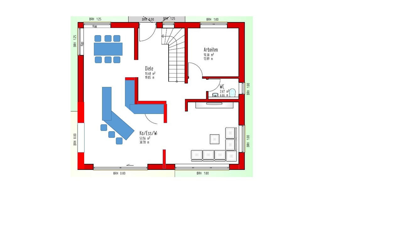

Sparfuchs_:p schrieb:
Well, the kitchen area ends up being quite a tunnel... over 6m (20 feet) deep. For me, it would also be too narrow. I actually think it works quite well and provides enough space. The kitchen itself has a depth of about 2.50m - 3.00m (8 - 10 feet). Until the end of the wall, it’s just over 6.00m (20 feet). But I’m not using that entire length just for the kitchen?

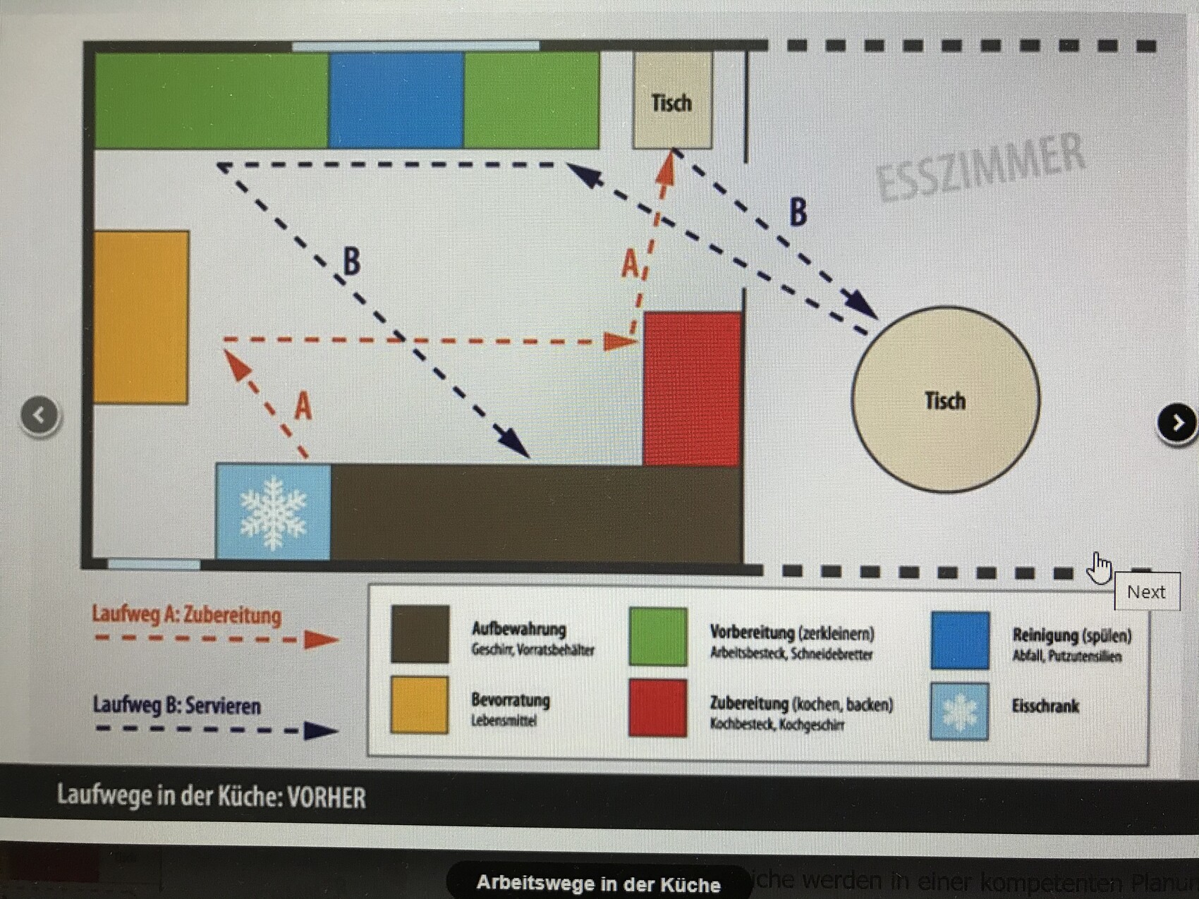

saralina87 schrieb:
As in your first kitchen thread: narrower kitchen, but extend into the hallway area. You even received illustrated examples of great galley kitchens. But why wouldn’t our room be suitable for a U-shaped kitchen? We would like a U-shape because it offers more options space-wise and also gives us a "bar area" or "island seating area." A 2-meter (6.5 feet) clear walkway would be enough, right? At least that’s what our kitchen planner told us back then 😀
The floor plan was already shared in the forum and is similar, correct! At least for the kitchen back then. However, I believe that kitchen was even about 50cm (20 inches) narrower. So unfortunately, that plan is quite outdated, and the galley kitchen probably isn’t as practical now as it was at the time.

You have a basement, right? Aren’t there possibilities there? Very nice! But the kitchen is quite similar to ours, isn’t it? I mean, in terms of dimensions as well? Whether I ultimately design the tall cabinets and so on as currently drawn is still open. But the space itself should be fine, right? You also have a lot of room between the dining room and kitchen – similar to us. As I said, whether I extend the kitchen fully to the south or not is obviously part of the planning. We’re not at the detailed design stage yet – basically, it’s just about the space, and it should be suitable for an L-shape, U-shape, or a two-row kitchen with units on the left and right, right? Just independent of our current ideas?
The office doesn’t bother us or conflict with the kitchen, does it? We have less space than you in the living areas and entrance hall but do have an office on the ground floor, which I like much more than having it in the basement. Our basement is strictly a utility cellar without any windows or light wells. I think we generously planned the space on the ground floor so that the office really deserves its place there.

Is there any “minimum size” for a U-shaped kitchen? I mean, a minimum width below which it wouldn’t make sense or be feasible for us?
As mentioned before, this is not the final design. It looks so narrow and large because we’ve filled it with a lot of items! The kitchen is more than fully equipped. It’s possible that everything will be a bit narrower. That way, I would have some free space towards the dining area, similar to what @OWLer has.
Sparfuchs7712 Nov 2020 09:33exto1791 schrieb:
Is there any kind of “minimum size” for a U-shaped kitchen?First and foremost, the proportions between length and width should be right. In this case, the width seems too long and the length too narrow to me.
