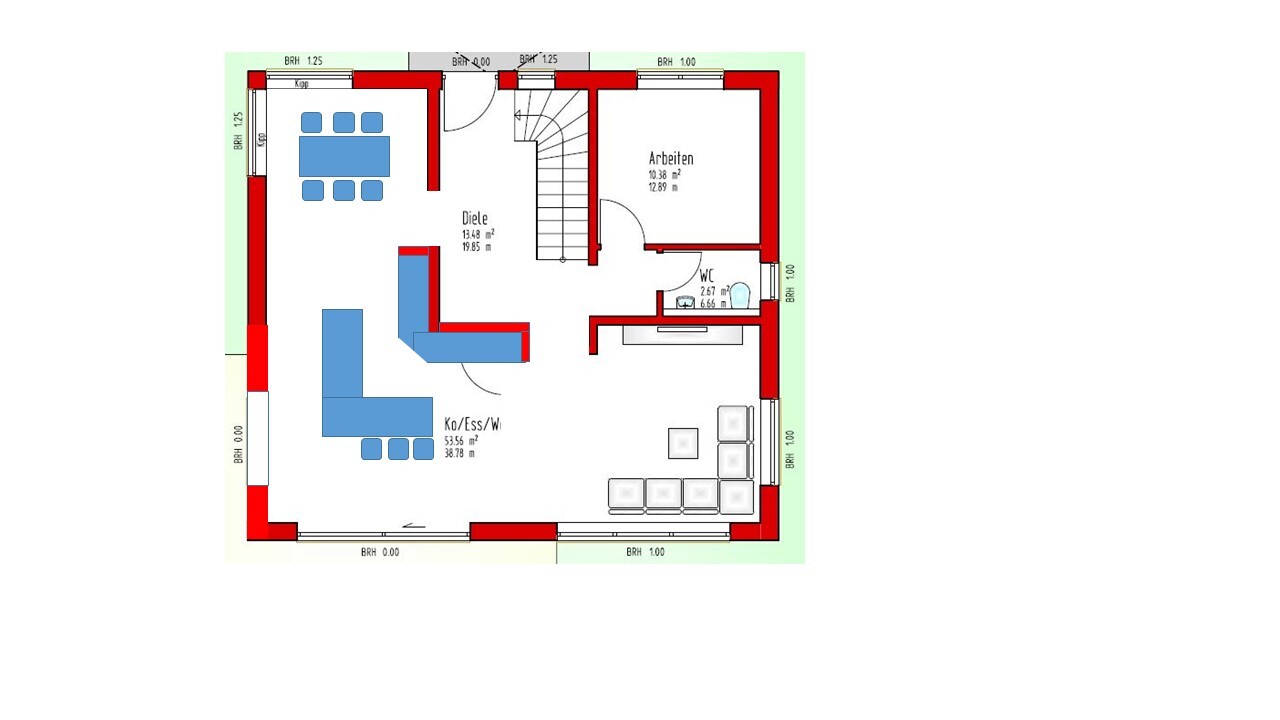

pagoni202012 Nov 2020 09:07Alessandro schrieb:
If you want the kitchen or the sink area to have a view of the yard, then place the kitchen in the center as a central gathering spot where meals can also be enjoyed.
Don’t forget the draft beer system :p :p :p
Absolutely MY style, even without the draft beer system. Your escalator will fit in there too.A "bold" but also stylish floor plan.
Alessandro schrieb:
If you like the kitchen or washing area with a courtyard view, then place the kitchen in the center as a central living space where you can also eat.
Don’t forget the draft system :p :p :p
Wow, that’s a really cool drawing 😀
However, my wife’s compromise: “Open kitchen, yes! But it needs to be somewhat ‘separated’ from the living/dining area. It must not be the complete centerpiece of the living room.” I already had to fight to avoid having a kitchen with sliding doors. I actually think the solution on our floor plan is pretty good? Of course, we can discuss the exact kitchen design separately in detail, but I think that in terms of space (also regarding lengths/widths), a proper kitchen matching our ideas can be planned here.
saralina8712 Nov 2020 09:12As in your first thread about the kitchen: make it narrower and instead use the hallway space. You even received illustrated examples of great double-row kitchen layouts.
Sparfuchs7712 Nov 2020 09:13Well, the kitchen area will end up being quite a long tunnel... over 6m (20 feet) deep. For me, it would also be too narrow.
Alessandro12 Nov 2020 09:16exto1791 schrieb:
Wow, that’s a really cool drawing! 😀
However, a compromise with my wife: "Open kitchen, yes! But it needs to be somewhat 'separated' from the living/dining area. It shouldn’t be the complete focal point of the living room. I already had to fight to avoid having a kitchen with a sliding door. I actually think the solution in our floor plan is quite good. Of course, the exact kitchen layout can be discussed separately, but I believe that, in terms of space (also regarding length and width), a decent kitchen according to our ideas can be drawn here?Then just install a sliding door towards the living room..
We basically had the same problems as you. This is how we solved it. My floor plan
The office was on the ground floor for a long time but eventually had to be removed because it conflicted with the requirement to have a view from the kitchen onto the street.
You have a basement, right? Are there no possibilities there?
