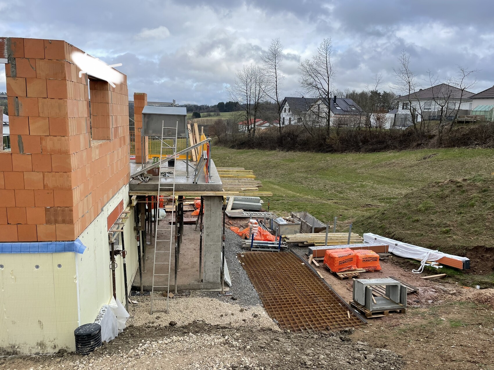

JayneCobb
13 Mar 2023 18:23
You’re already surrounded by quite a few houses that are (almost) finished.
To our right, it’s open and will stay that way.
True, we’re the last ones building in our area. Saves us from construction noise from other sites.
Shell of a house made of red bricks, scaffolding and building materials on the construction site.
