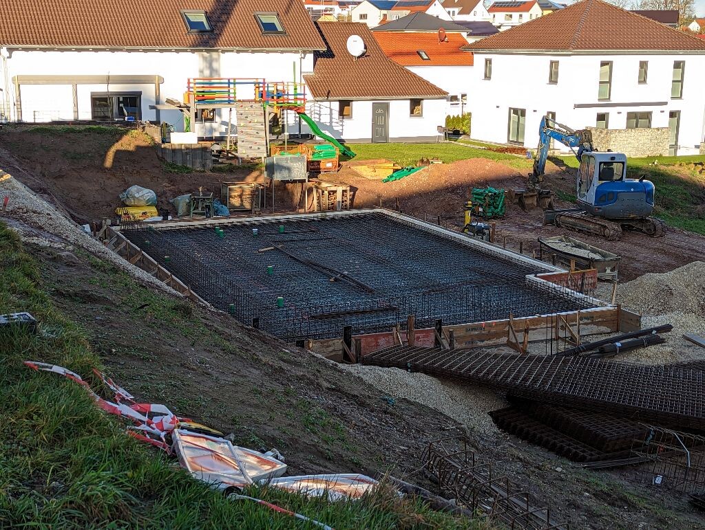

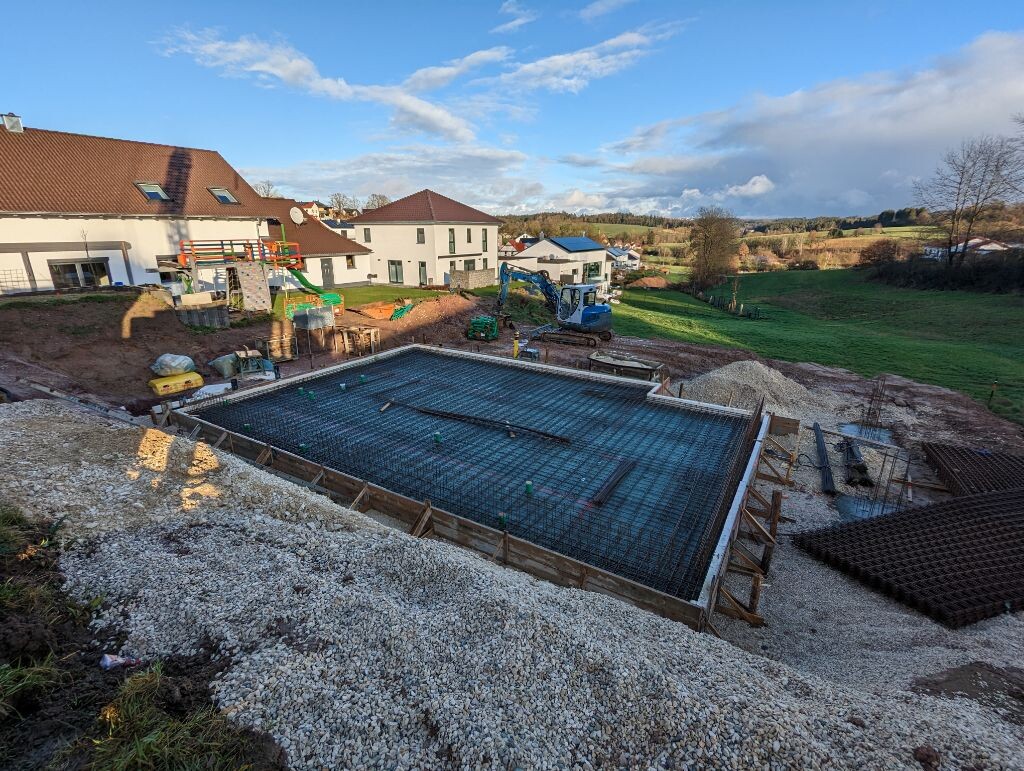

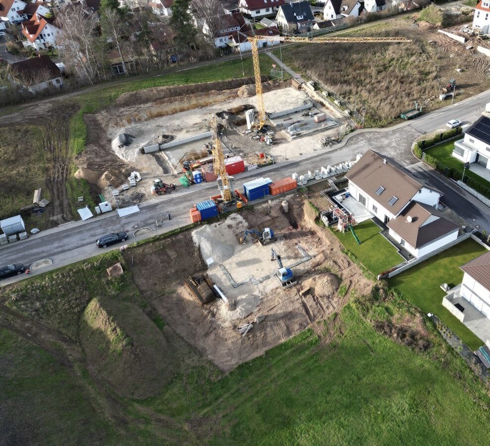

Here are three photos from the end of last year.
If you have any specific questions, feel free to ask again.
Foundation with reinforcing steel (rebar grid) in the ground, construction equipment and surrounding houses in greenery.
Aerial view of a suburban construction site: two cranes, excavations, containers, neighboring houses.
Construction site foundation with steel reinforcement, wooden formwork, excavator and residential houses behind.

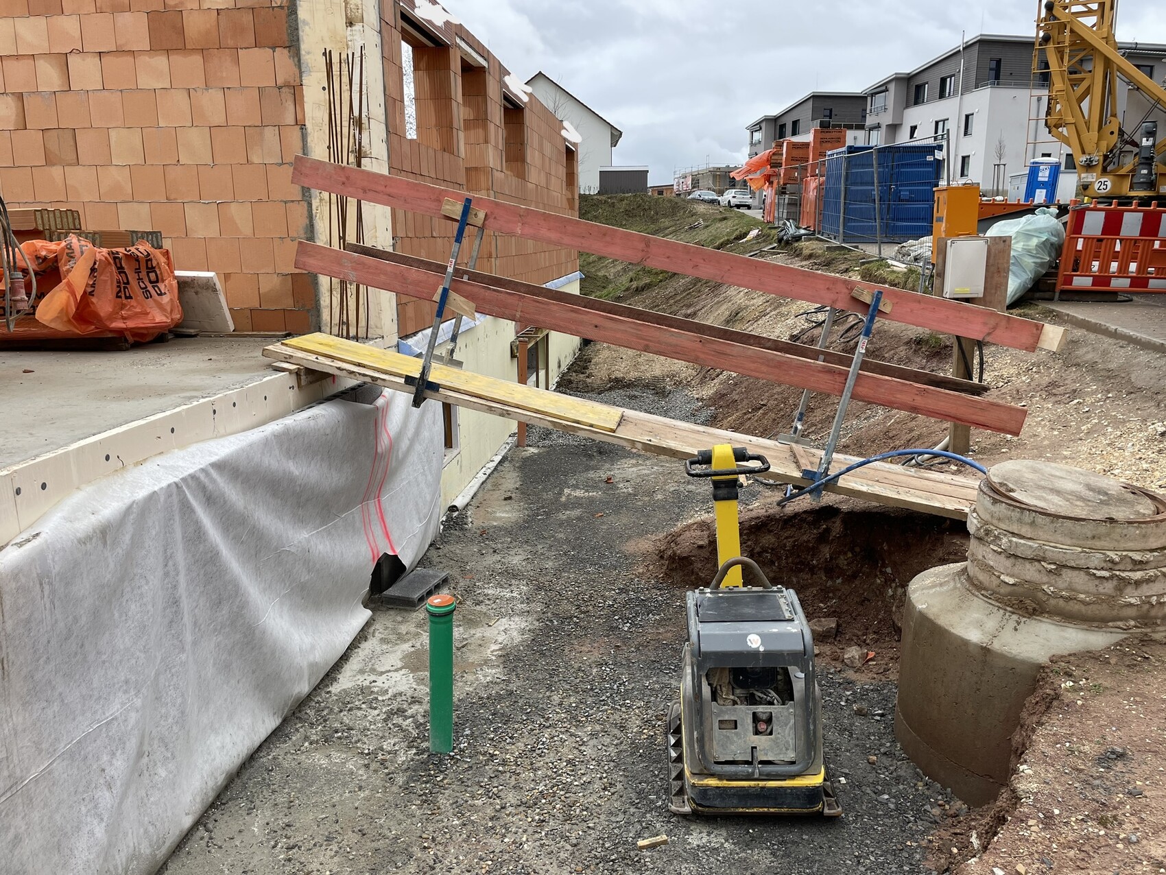

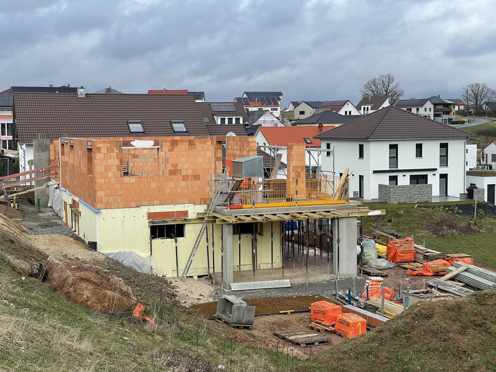

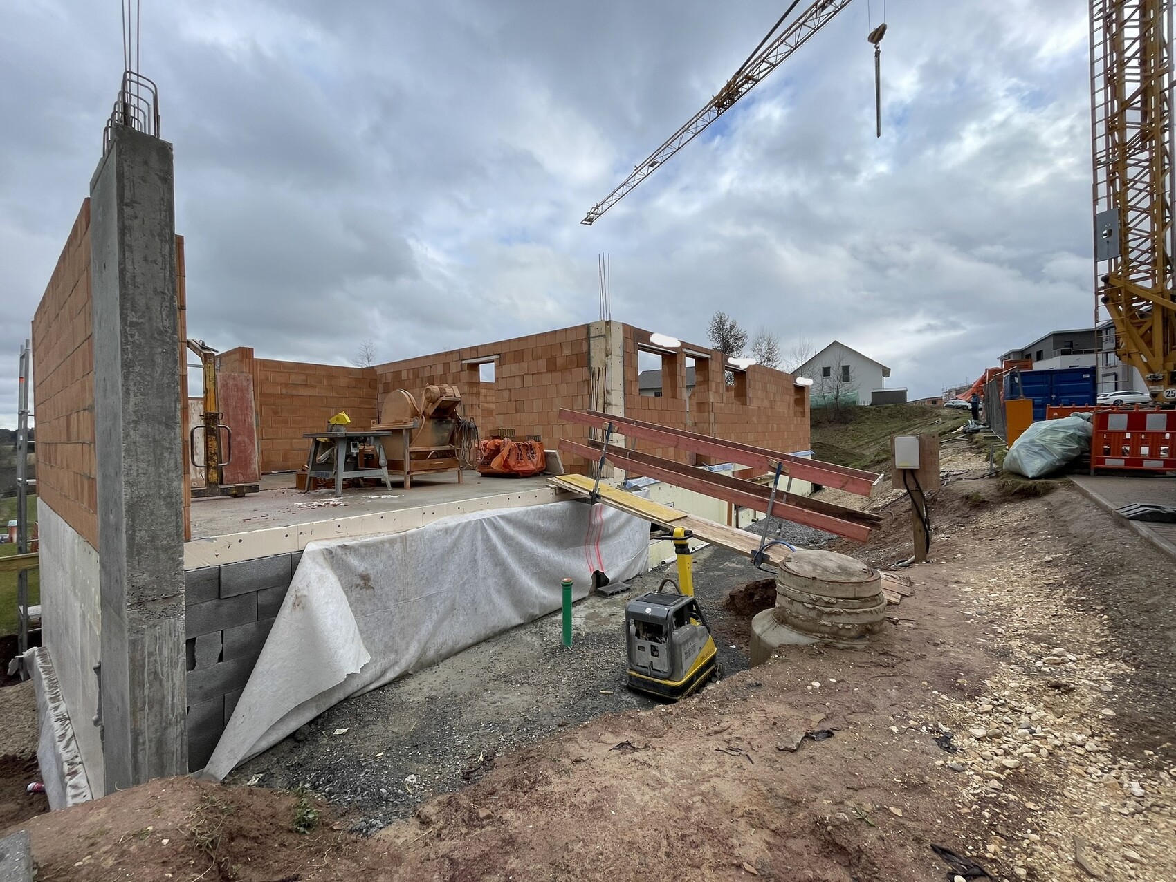

for those interested: Progress is moving along well. This is the status as of yesterday.
The damaged bricks in the lower left corner (covered by a tarp exposed by the wind in the third photo) are a bit concerning. I’m not sure if this is acceptable?
Construction site of a house: orange brick walls on foundation, scaffolding, building materials in the yard.
Shell construction made of red bricks with window openings, scaffolding, and materials on the site.
Construction site with unfinished brickwork, crane, concrete foundation, and construction tools.
Construction site with open excavation, wooden beam barrier, vibrating plate, and building materials.

JayneCobb schrieb:
The damaged blocks at the bottom left (the wind-exposed tarp in the 3rd photo) confuse me a bit.
Especially the one that is out of alignment (top row, second from the left) doesn’t look good to me; and they don’t appear fully filled. The two more or less “chips” from lost formwork aren’t critical, but I would want to find out their cause. As far as I remember (or maybe not), no formwork blocks were supposed to be used in the basement. Have you read my post “Caution with formwork blocks – risk of bursting!”?
