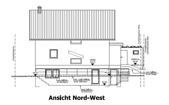

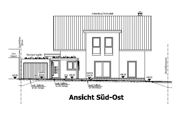

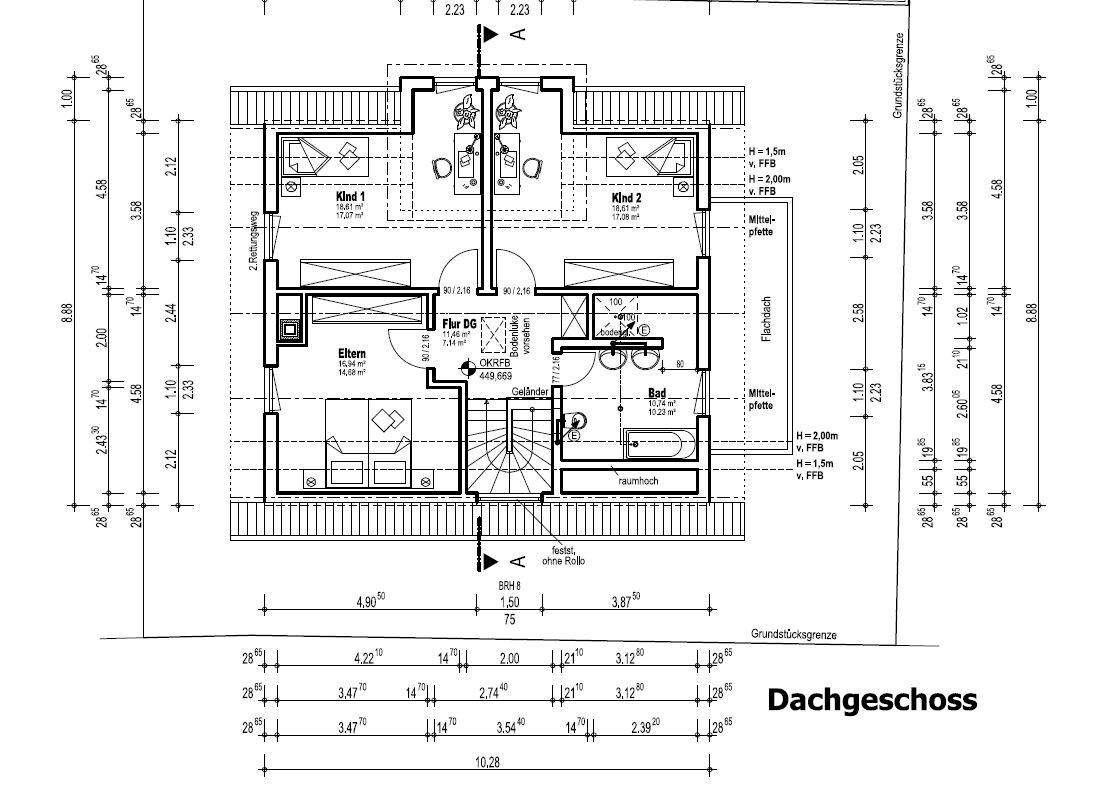

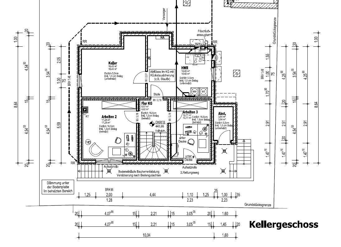

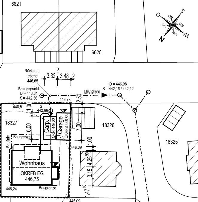

I roughly recreated the room in a 3D planner and came to the conclusion that the "left" window definitely needs to be smaller; otherwise, there is no flexibility. At the moment, we are leaning towards slightly reducing the passage to the living room and also the left window. The door to the hallway will either be designed as a sliding door or an open passage — in any case, so that no door swings into the kitchen.
I have attached the remaining plans again and would appreciate your opinions on them as well. Maybe you will consider something we have completely overlooked. Thanks in advance.
@tomtom79 The plot has a slight slope. I think the stairs will become clear with the other plans 🙂
thank you for all the opinions.
