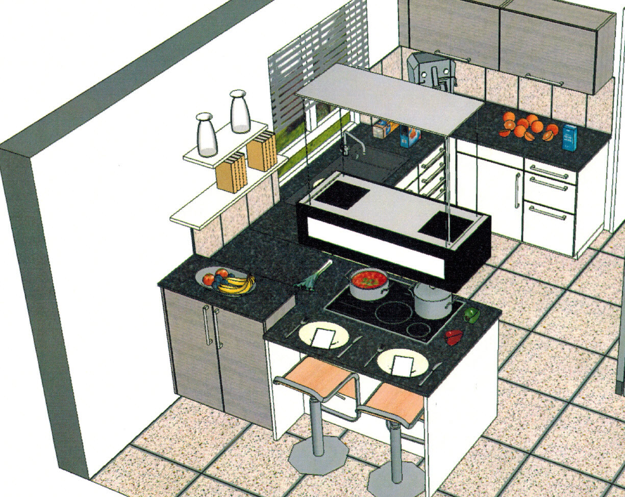

herann schrieb:
We actually don’t want a kitchen island because we don’t really see the added value ;-) We have a similar setup with the cooktop and a retractable recirculating hood on one side, and a small dining area on the other. Next to the dining area, there is a slightly taller cabinet, creating a niche behind it for dirty dishes.
This arrangement provides extra storage and workspace.
If we generously assume a ceiling height of 2.60 meters (8.5 feet), then allow for a soffit of 30 cm (12 inches) to accommodate the ceiling extractor fan, plus a working height of 90 cm (35 inches), the distance to the cooktop remains 1.40 meters (55 inches). This is not a problem for a ceiling extractor. However, these are generally not among the cheaper options. 😉
Of course, there must be enough space available for such a setup. If the soffit extends along the entire length and is fitted with LED lighting, it also looks quite attractive.
