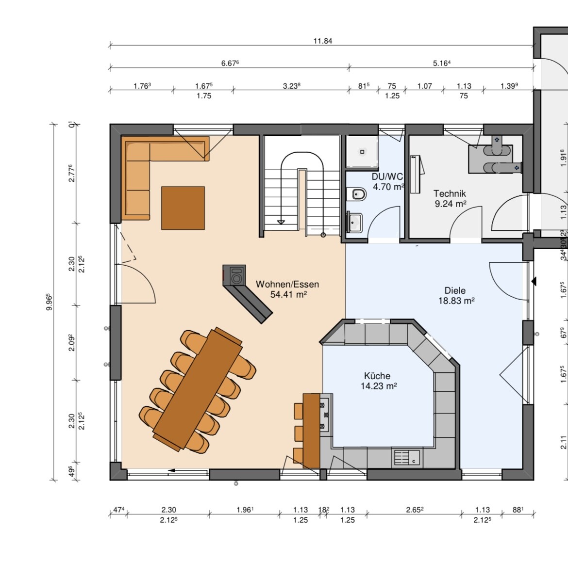

we would like to get your feedback on the attached floor plan. Our goal is to create a bright, open, and spacious feeling.
The main entrance is planned from the east. There is also an entrance from the double garage through the utility room.
The north side is where the staircase is located. The black square in the living room represents a double-sided fireplace built into a wall (room divider).
We look forward to your thoughts, ideas, and suggestions for improvement :-)

FoxyBrown14 Nov 2021 16:52As described above, this is a fireplace installed within a wall that serves as a room divider.
Ypsi aus NI14 Nov 2021 17:02You don’t have to sit with 10 people on the couch... but at the dining table, you do.
Where are you planning to put the wardrobe?
Are you sustainably just the two of you?
I find the kitchen a bit cramped. I would reconsider and possibly go for a single row plus an island.

FoxyBrown14 Nov 2021 17:35Ypsi aus NI schrieb:
You don’t have to sit with 10 people on the couch... but you do at the dining table.
Where do you plan to place the cloakroom or wardrobe?
Are you sustainably just two people?
I find the kitchen a bit cramped. I would reconsider and possibly go for a single-wall kitchen plus an island. Thanks for your feedback. The cloakroom will be placed in the hallway to the left of the entrance. Yes, we are “only” two people.
