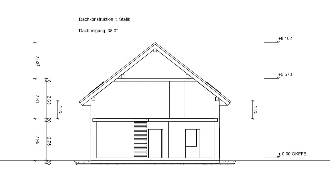

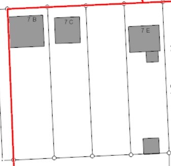

Therefore, I am adding here again the orientation of the plot in north/south direction as well as a cross-section for better understanding.

If more than two-thirds of the upper floor has a ceiling height of 2.30 meters (7 ft 7 in), it should be considered a full storey in Saxony-Anhalt. This should apply in your case as well.

Could you please upload a site plan and add a north arrow to the drawing?

I think the house is too small for a straight staircase.
Especially on the upper floor, the hallway is large compared to the children's room and office.

I completely miss a west-facing orientation here: if you build the house level with the left neighbor, the west side will be free of “massive buildings.” I would install proper windows there to let in the afternoon sun from the west.
