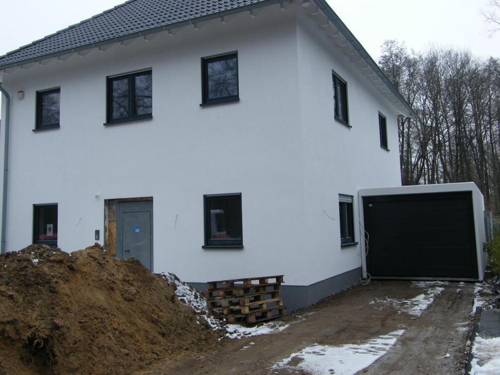

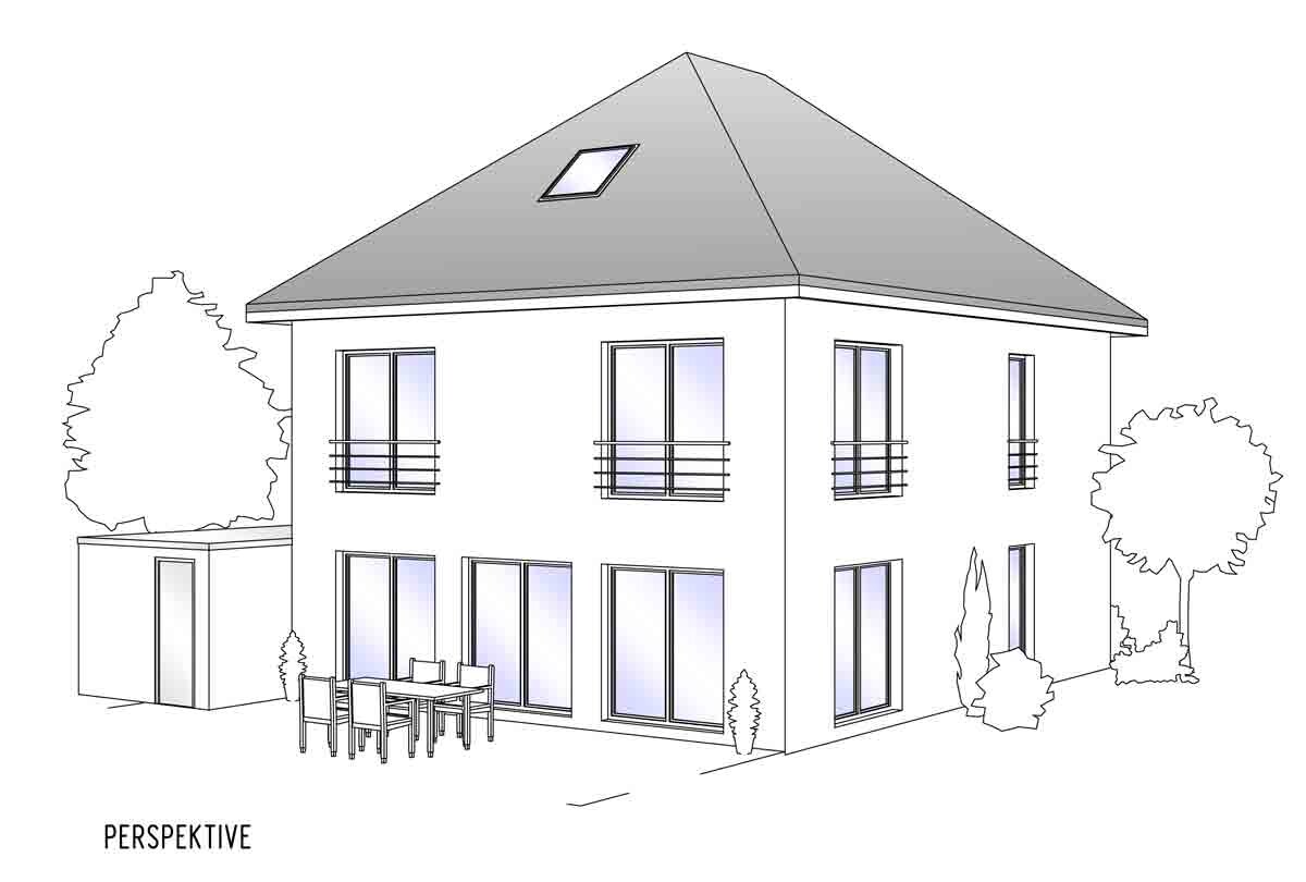

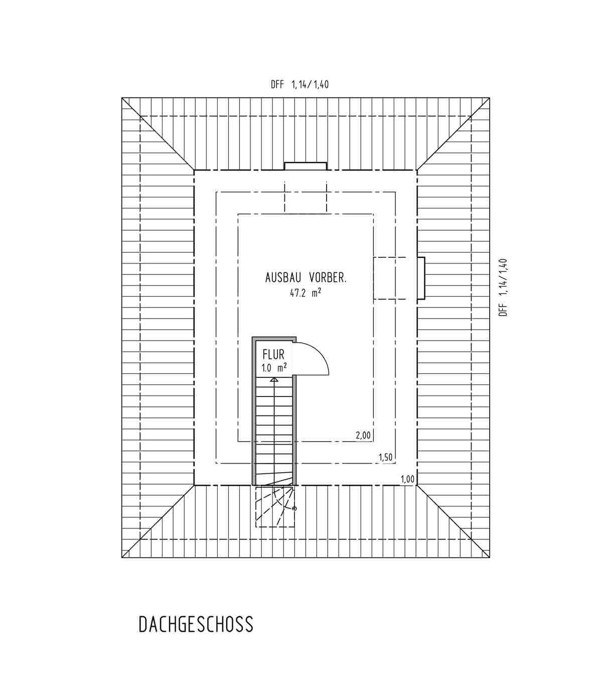

Cicatrix schrieb:Then you should extend the depth of the house footprint since the building envelope allows it. With proper planning, for example 9.00 meters x 11.50 meters (29.5 ft x 37.7 ft), you can create usable space of 47 square meters (506 square feet) in the attic. That should be enough for a study for two people. I’ve attached the attic plan and an exterior view of one of our clients’ homes for you. This floor plan also works if you limit the depth to 11.00 meters (36 ft).
