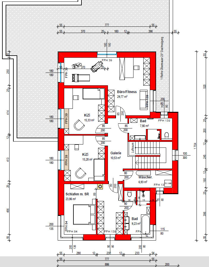

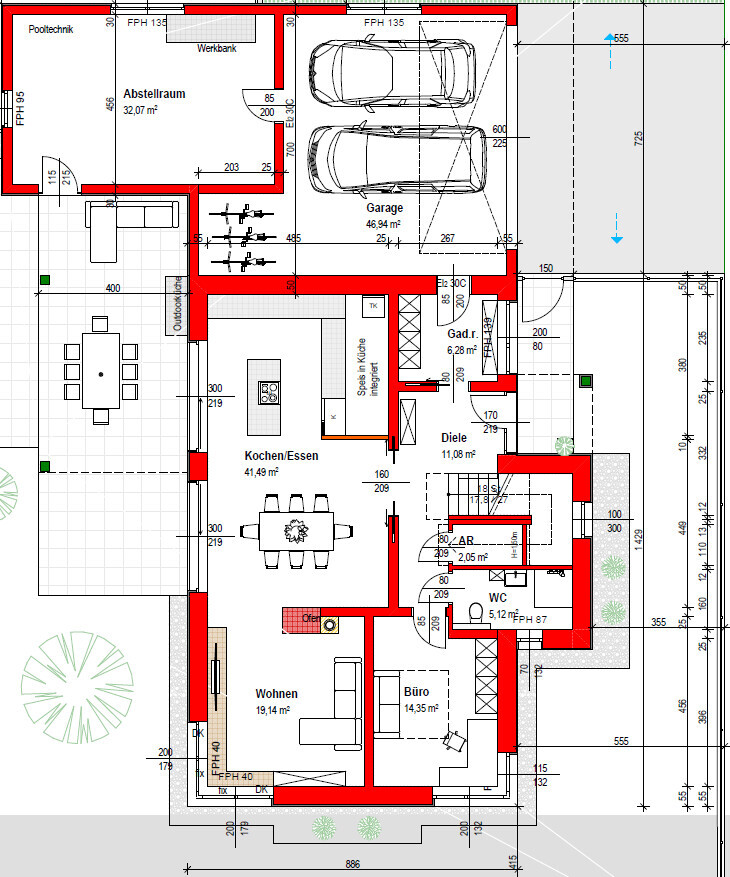

The approx. 30 m² (320 sq ft) room on the upper floor (office/fitness) and the larger storage room behind the garage are intended as a basement substitute. How do you like this solution with the partial overbuilding of the garage on the upper floor?

Well 🙂 Children actually need light more than a view. But you mean the bedroom, right?
Or the ground floor? Then I would question the dining area, which is dark and without a view. A place where you spend time, have a coffee, read the newspaper, and enjoy looking outside.
And your sofa is mainly oriented toward the TV and the fireplace. Maybe you should ask yourselves about that.
A great view is nice. But it doesn’t govern your life. So it should be incorporated, but not the other way around. I meant both the bedroom and the ground floor; I’m now convinced that the dining area is not ideal.

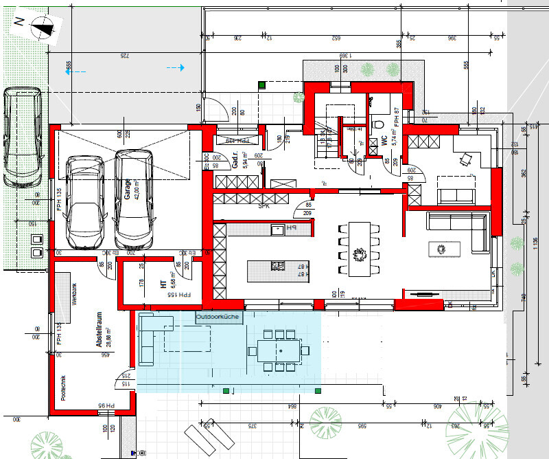

I also find the ground floor too complicated and dark. If you want to save floor space, here is a suggestion for the ground floor: completely remove the kitchen bay window (south sunlight will reach the terrace), place the kitchen close to the outdoor kitchen, and make the roofed area (indicated in blue) significantly smaller and further to the left (the storage room slightly reduced). This way, from the living and dining areas, you would have a nice unobstructed view of the garden, without any roof or garden furniture blocking it. In the living room, a window seat could be installed at the bottom.

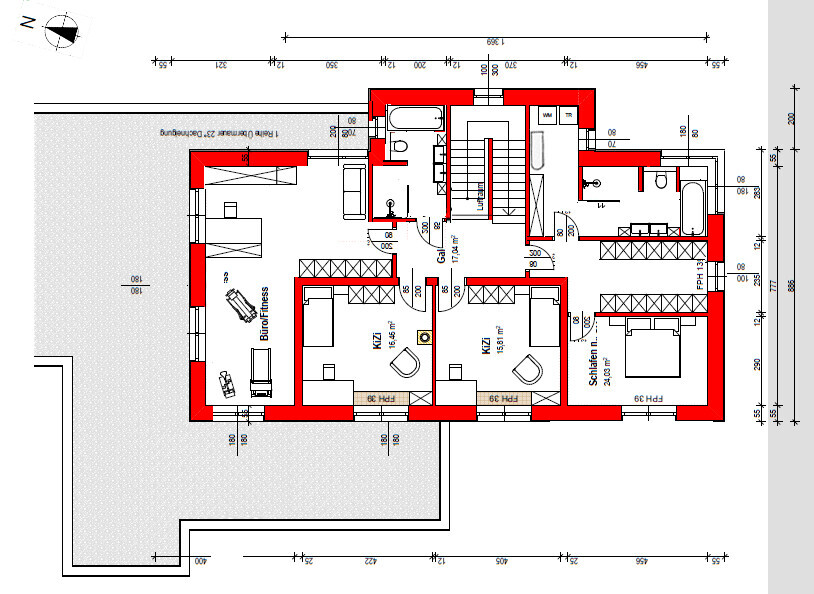

Upstairs, I also tried to save floor space by eliminating the narrow, complicated corridor. On the left side of the plan, the house is now noticeably narrower. The exterior wall at the top aligns flush with the extended storage room on the ground floor. This should look more coherent. Maybe some of these ideas are useful for you :-)
Würfel* schrieb:
I also find the ground floor too confusing and dark. If you want to save some square meters, I have a suggestion for the ground floor: completely remove the kitchen bay window (southern sunlight will then come onto the terrace), place the kitchen closer to the outdoor kitchen, reduce and move the covered area (marked in blue) further to the left (slightly smaller storage room). This way, from the living and dining areas, you would have a nice open view of the garden without any roof or outdoor furniture blocking it. A window seat could be added at the bottom of the living room.
[ATTACH alt="1650891407716.png"]71419[/ATTACH]
Upstairs, I also tried to save some square meters by eliminating the narrow, winding corridor. On the left side of the plan, the house structure is now noticeably slimmer. The exterior wall at the top aligns flush with the extended storage room on the ground floor. That should look neat. Maybe some ideas here will be helpful for you 🙂
[ATTACH alt="1650891534775.png"]71420[/ATTACH]Thank you very much for your input – these are really great ideas!
Regarding the ground floor, the question is whether there might be too much light near the TV 😉 Upstairs, I’m generally not entirely happy with the layout of the bathrooms/WCs, but your ideas are excellent here as well 🙂
