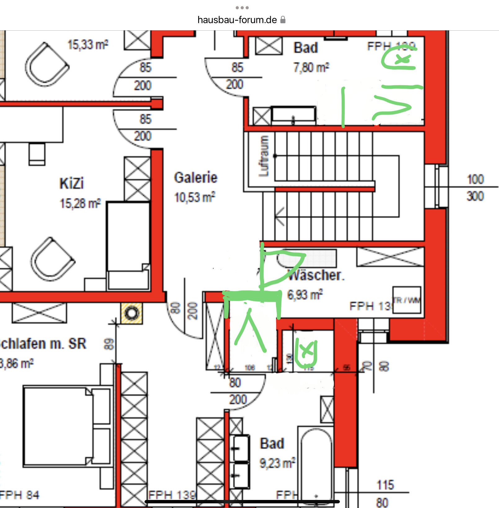

Nemesis schrieb:
Okay, it’s your decision, but I see it completely differently. And I hadn’t even taken into account the very practical point raised by @ypg.
From my point of view, it changes from “no significant advantage” to “often an annoying or at least inconvenient situation” to have to walk through there. Especially since the path around it is even covered. It would be different if the room wasn’t a separate room, but then the unsightly steel door would be even more of a problem. A small cloakroom or storage room encourages people to use the floor inside. No matter how disciplined you are. And I’m not talking about children here, but about situations when you’re in a hurry. And suddenly the shoes or bag end up there.
As planned, it’s simply not practical. (The freezer at the end of the long, narrow pantry isn’t practical either… how wide is that supposed to be?)
I find that difficult because the changes are, to put it mildly, "not very obvious," meaning if I'm shown the "new" floor plans as spot-the-difference images Well, the entire kitchen bay window is gone, for example. That definitely catches the eye, doesn’t it?
I would swap the toilet and washbasin. ypg schrieb:
The door to the multipurpose room should be centered on the staircase. ypg schrieb:
The shower bathroom upstairs is poorly furnished too. It should be enlarged by about 2 meters (6.5 feet), for example moving the shower into the windowless corner. All of what YPG suggests, plus in the children’s bathroom, move the window all the way into the corner like in the utility room. That gives more space for a corner shower.
But the room usage is mixed up in my opinion: the kitchen ends up dark, and the south-facing window goes to the sofa and chill-out area. I see that differently; I think the kitchen gets enough light and it is located right next to the terrace and the outdoor kitchen.

Regarding the floor plan:
Finally, there is some light coming into the house! However, the room usage seems reversed to me: the kitchen ends up dark, while the sofa and lounge area get the south-facing window, which will only be used in winter. I’m also not a fan of the hidden and narrow pantry. That said, much has improved now.
The toilet on the ground floor is just outside the door. A width of 1.50 meters (5 feet) isn’t enough there. I would swap the toilet and the washbasin.
The shower bathroom on the upper floor is also poorly furnished. It should be extended by about two meters (6.5 feet), for example by moving the shower into the windowless corner and rotating the toilet so daylight can reach the washbasin area.
The door to the multipurpose room should be centered with the stairs; otherwise, the sightline toward the stairs feels awkward.

I don’t find it perfect, but it’s better than some other designs I’ve seen. What I would change:
1. The door in the master bathroom swings close to the toilet, which can cause bumps. However, this isn’t a quick fix.
2. Make the patio roof entirely out of glass with an under-roof retractable sunshade. This way, the kitchen won’t be so dark.
3. Access to the pantry should not be through the kitchen cabinets (which is unfortunately not entirely clear in the current plan).
