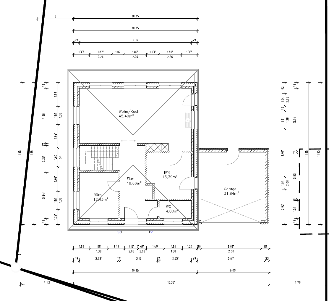

Our project is about to start soon. Before all the masonry work begins, I would appreciate your feedback.

Ground floor: Living/dining/kitchen area, utility room, guest WC, office

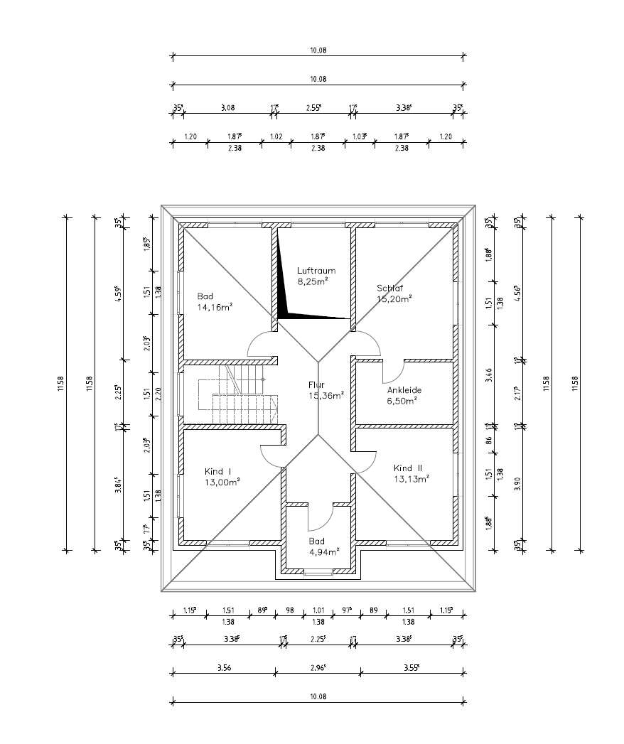

Upper floor: Master bathroom, children’s bathroom, master bedroom including walk-in closet, child 1, child 2

Regarding the kitchen, the door shown in the drawing will be removed. The kitchen unit will extend along the entire wall, and the indicated window is relatively large, facing south to allow afternoon sunlight.

Ground floor:
Upper floor:

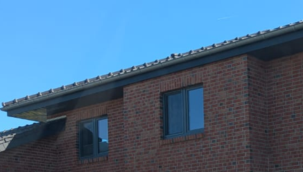

1. pointed out that the setback of the facade edge on the upper floor is about 2cm (1 inch) larger than on the ground floor, which is quite significant for the facing brickwork,

Regarding 1/3: I discussed this with the planner today and it will be corrected. In the end, the ground floor will be about 5cm (2 inches) wider so that the rails for water drainage can be placed on the brickwork.

Regarding 4: We were able to look at a solution where a uniform roof overhang of 50cm (20 inches) and a 50cm (20 inches) offset for the children’s bathroom on the upper floor is possible. In the following example, both ground floor and upper floor are offset, whereas for us it would only be the upper floor.

The clearance between the table edge and the fireplace is about 1 meter (3 feet 3 inches).
Maybe… but then nobody can sit there without melting away.

that you can integrate a shelf (possibly multiple shelves) into the drywall partition.
You don’t want to contort yourself like that permanently either.
But that fits with “sitting in bed looking outside.” That’s unrealistic, sorry. Who does that and "stares into space" when they have a day’s work at home or children?

Here is the scale drawing of the furniture layout.
Almost nothing is truly to scale. Setting aside that beds for children often grow with them, the bathroom layout simply doesn’t work. The bathtub and sink are almost touching if you look closely. Practically, you can’t even pass between the washbasin and the bathtub without brushing against them. And that’s with two small children to consider...
