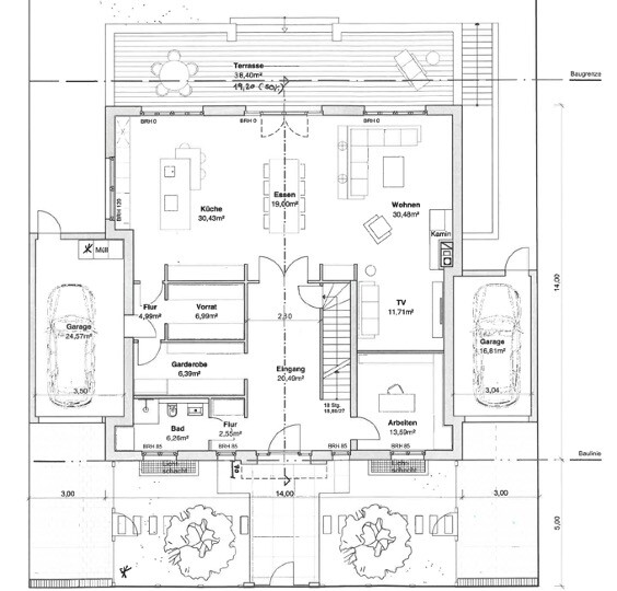

_MPCAP_ schrieb:
1. Regarding the lighting in the center of the house, the plan is to install a larger glass element in the middle of the roof on the street side (i.e., the west side) of the building. On either side of this, two dormers are planned, as shown in the design. The glass element would illuminate the entire air space and thus the center of the house – according to the architect, the light entering through this glass roof element would be roughly eight times greater than that of a normal vertical window. Opinions from the forum are very welcome! With all due respect, that sounds like architectural nonsense. How is the light supposed to reach the living space then? Is one of the children’s rooms for Einstein Junior, who researches light refraction, or is this going to end up like in the Blues Brothers?
Seriously, if the west side faces the street, you should at least try to preserve the south side. And if I were to add a light element on the west side, it would be for a nice private roof terrace or loggia—search for Velux roof balcony online. That would have practical use for enjoying sunset drinks or as a play area for the kids, rather than wasted volume in the air.
Speaking of which, 95sqm (1023 sq ft) of open-plan space plus 20sqm (215 sq ft) for the entrance hall (and another 20sqm (215 sq ft) of air space above) doesn’t feel generous but rather overwhelming due to the hall-like layout and lack of division. Add to that the absence of natural sunlight—this really just won’t work. You’re wasting a lot of space where it’s not needed and where it even feels unlivable, and then there’s this:
Anyway: on this topic, I noticed the toilet doesn’t work, it is located beneath the knee wall and is not accessible 😉 Furthermore, the children’s bathroom is far too small. A guest has to go through the hallway to reach the bathroom if the ground-floor office is to serve as a guest room. The garage layout doesn’t work either. Obsessive symmetry, structural issues, and lighting problems have already been mentioned.
If it absolutely has to be large and expensive, consider a U-shaped house with distinct functional zones instead. This would also allow you to better use the depth of the plot. By the way, how does the house north of you look? The footprint looks interesting.
I know people who live in a very similar house. It’s slightly larger and has an additional floor.
They also have two 3-meter (10-foot) garages attached to the house on the left and right, each with a driveway gate. Unfortunately, their cars are quite large as well, matching the size of the house. Now they always park in front of the garages because it’s difficult to get in and out, and the passage to the house, like in your case, is next to the left garage. However, the car is right up against the house wall there.
Like you, they have a huge, imposing entrance hall with a large chandelier. It definitely looks impressive, but they say it causes a lot of noise (stone stairs, stone floor, smooth walls), so they wouldn’t design it that way again. Also, the entrance hall takes up a lot of space, making the rooms adjoining on the left and right rather narrow.
They only have windows facing the garden at the front in the open-plan living area, but these face west, and the living area is very deep, just like yours. It’s really very dark in there, and they have since installed indirect ceiling lighting throughout to reduce the gloominess.

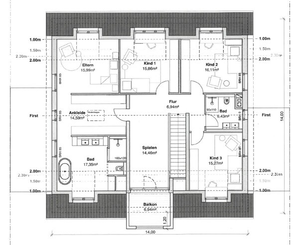

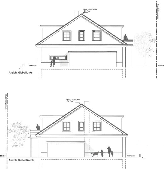

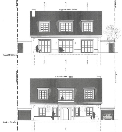

Dear forum members,
Thank you very much for the feedback on the draft here in the forum. Based on this, I have worked with the architect to further advance the planning. You can find the current version in the attachment. The following additions will be passed on to the architect for the next draft:
A brief note on the raised questions:
-House orientation: The building envelope is quite clearly defined by the development plan, namely 14 meters wide and 15 meters deep. Building deeper is not allowed, which makes ideas such as an L-shaped house difficult to realize. All houses on the street are oriented east/west. Rotating the house 90 degrees to face south does not make sense in my view, because then there would be no garden in front of the living room but instead a direct view of the neighbor’s garage on the right. I understand the argument that a southern orientation is generally preferable, but unfortunately, I have to take the realities of the plot into account.
-Double garage on the north side: With a 6-meter wide double garage, the house would only be allowed to be 11 meters wide instead of 14 meters, because the 3-meter setback on the south side must still be observed. This would result in a significant loss of space. Is slightly better lighting really worth such a considerable loss of area? I would be interested in your opinions!
-Guest room: This is planned for the basement. The office on the ground floor is therefore not intended as a guest room.
-Garages: These are now wider than previously planned and should hopefully provide sufficient space for getting in and out comfortably.
I would really appreciate your feedback!
- Add a large window area on the upper right side of the living room
- Rearrange the TV (rotate it 90 degrees clockwise and then mount it on the wall below)
- Continuous garage door on the left side
- Consider: small window or skylight for the TV area (this would provide an additional independent seating area, for example, if you want to have some quiet time away from the children)
- Consider: extend the wall between the office and TV area slightly upwards
- Consider: glass roof over the balcony!? (Thought: it wouldn’t be visible from below and would improve the brightness of the entrance area)

I would really appreciate your feedback! It should be well known by now that a lack of dimensions is not appreciated here. By the way, there are rumors that someone once died from over-symmetrizing. At the top, there are two load-bearing walls, with the left one having no counterpart on the ground floor. In the garage on the left side of the plan, you can only exit comfortably if the car is driven in backward or if it is right-hand drive.
