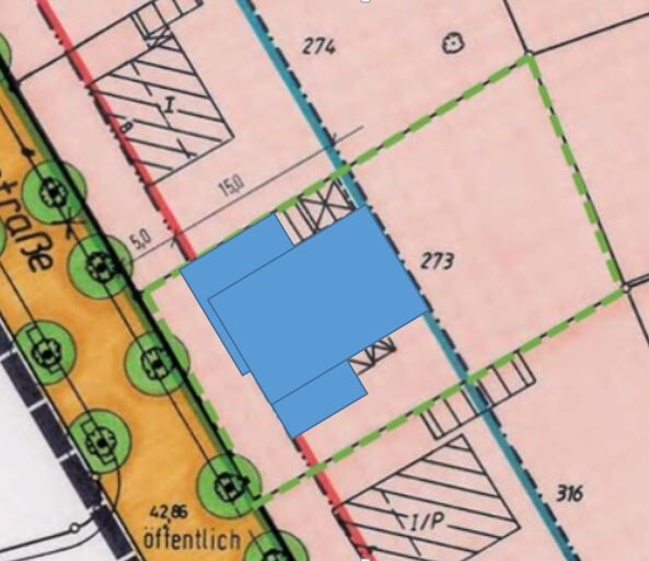

I would have arranged the house differently. The double garage partially inside the building on the north side, and an extension on the ground floor on the south side. The canopy from the building window should be eligible for a building permit / planning permission. The upper floor would then be a full storey.
Lageplan: blaue Gebäudefläche, rote und grüne Parzellenlinien, Baumreihe am Straßenrand.

I would have arranged the house like this instead.
And the ridge will most likely have to run parallel to the street as well.

And the ridge will probably need to run parallel to the street as well.
The ridge direction can often be changed when you go to the local building authority. With a flat roof, it usually doesn’t matter anyway. 😉
