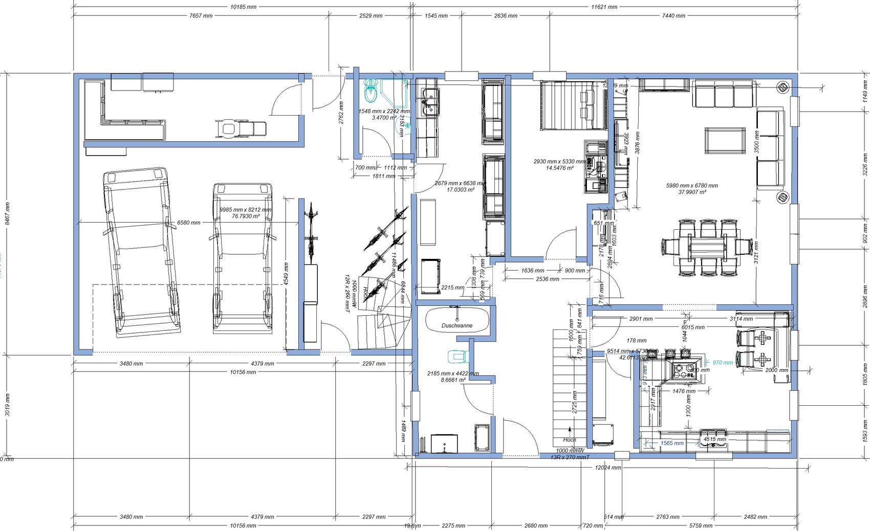

ᐅ Single-family house floor plan, approximately 200 sqm without a basement – assessment
Created on: 14 Dec 2014 10:37
Slammer0909

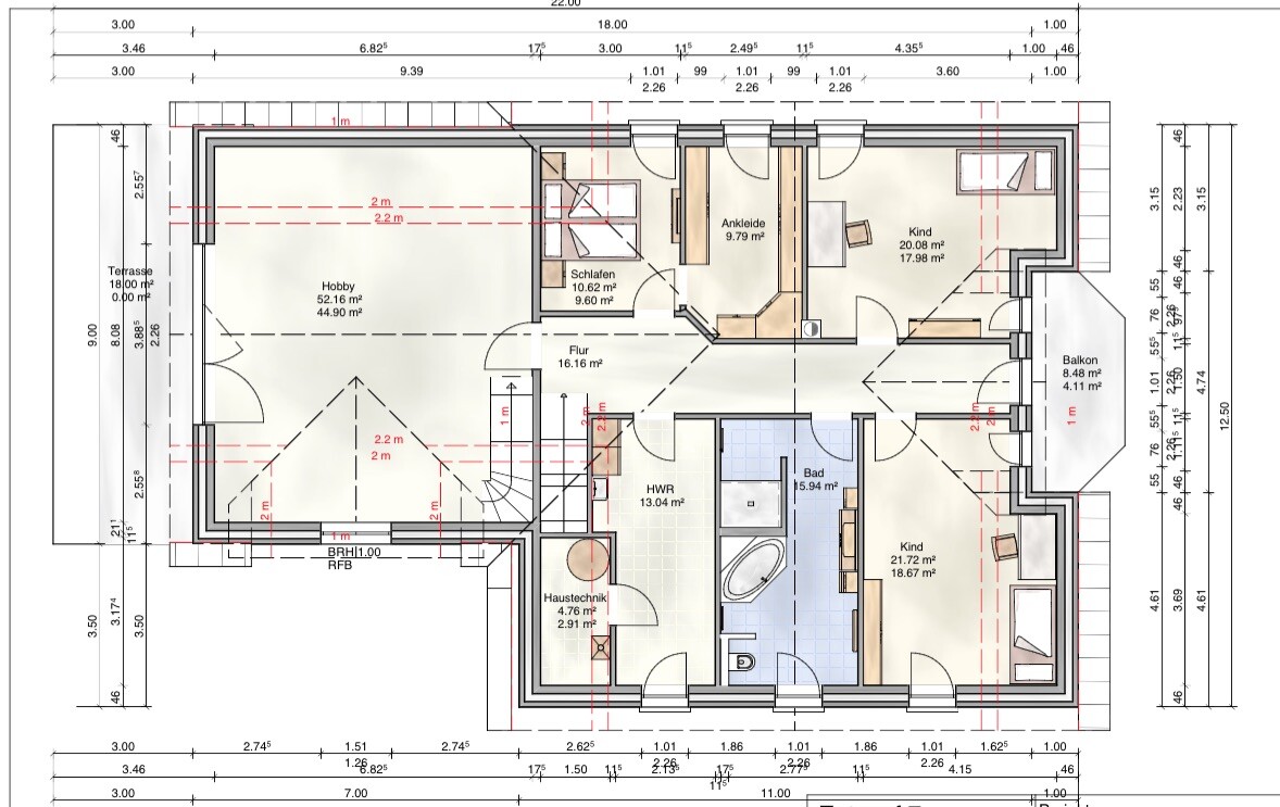

I have been following this forum for some time now, looking at other threads as well as their floor plans and feedback.
My wife and I are already in contact with a construction company, and the floor plan is roughly finalized. I also contributed to the design of the ground floor.
However, I am not satisfied with the layout of the upper floor because you have to walk through the dressing area to reach the bedroom.
I have been planning and moving walls around for about a year now, and I am starting to get somewhat "blind" to the design.
I would really appreciate any constructive feedback, both positive and negative, on the floor plan.
The rooms are quite large, but we prefer it that way (child’s room about 20sqm (215 sq ft), etc.).
Originally, we wanted a full basement, but due to the groundwater level, this is no longer possible.
That is why the rooms are arranged around the garage, with a large utility room including a cloakroom on the ground floor, and a laundry room on the upper floor.
The site plan including the property boundary is provided just to help visualize the dimensions of the plot.
Attached are the floor plans.
Thank you in advance.
Mathias

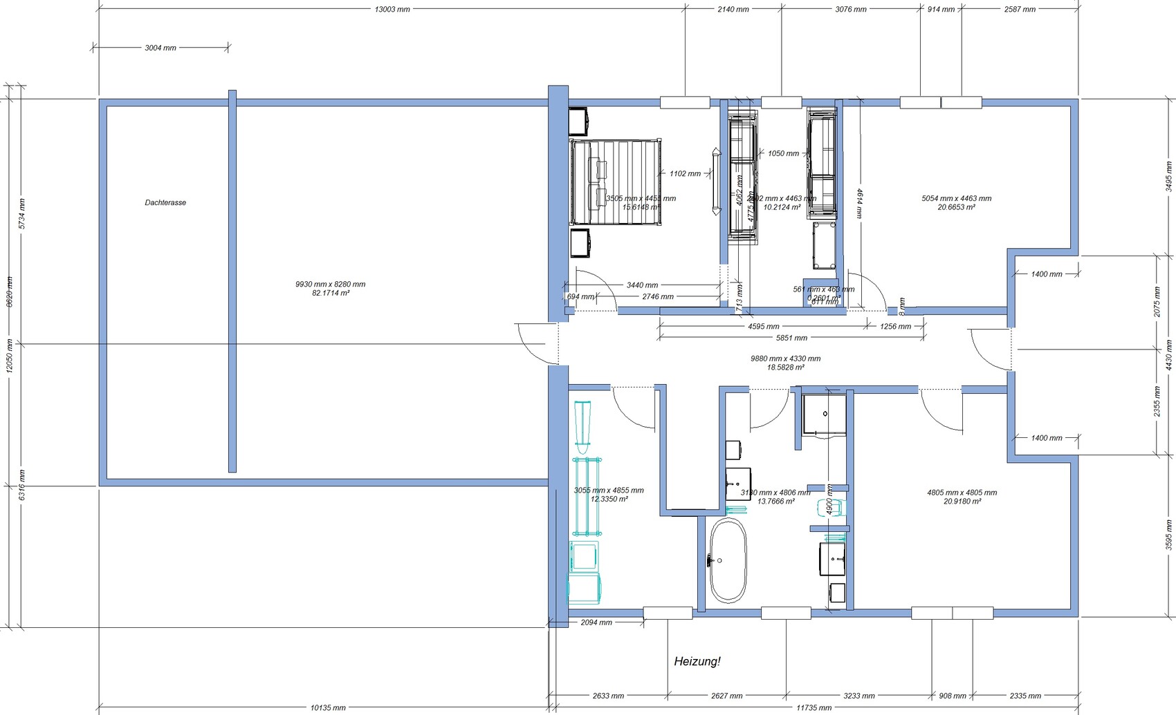

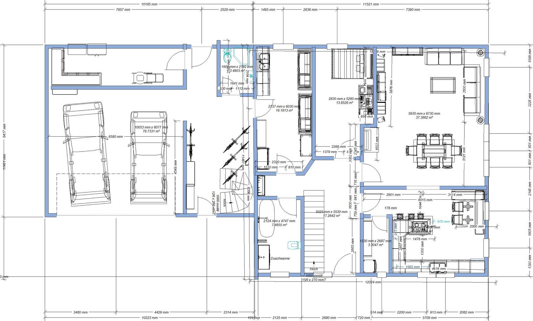

Slammer090926 Jan 2015 20:48Hello,
I have a new draft. Some suggestions have been incorporated, such as removing sloped ceilings. However, other corners have been added—for example, in the kitchen to accommodate an old rustic cabinet.
The children’s room is now located on the south side.
Attached are the drafts.
The kitchen island can be adjusted in length to allow enough space for the seating area. The seating area is planned with a bench around the corner.
I wanted to share these plans with you again.
Are these still terrible to you (apart from the second staircase, which we definitely want to keep 100%)? Any improvements?
I also talked with a friend who is an architect, and she gave her input.
She suggested relocating the entrance to the west side to reduce hallway space.
I don’t think that’s a bad idea; it results in a much larger bathroom downstairs where a shower tray can fit. I also removed some edges and the bay window.
This allows the possibility to place the balcony centrally on the upper floor.
The plan doesn’t change completely but quite significantly.

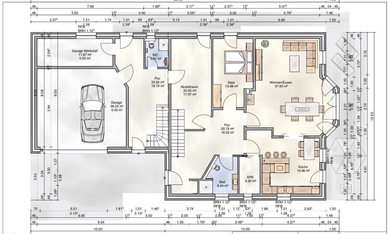

The first plan shown is from the builder. He hasn’t seen the “new” one I created yet. What do you think?
I reduced the external dimensions back to 12 x 12 meters (about 39 x 39 feet). The design for the party room is still open, so feel free to share ideas or suggestions.
The exterior walls are actually thicker, of course, but it’s probably nicer this way so that when you come upstairs, you can take at least two steps forward. On the opposite wall, a large photo gallery could be nicely arranged.

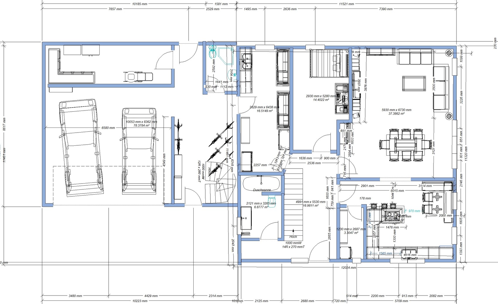

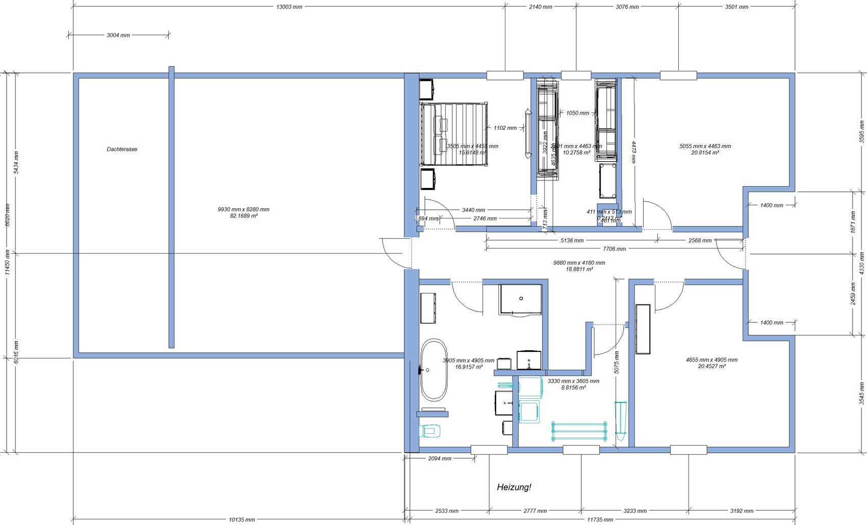

But an important question: How does it really look with a door under the staircase? The staircase would already be “up” there, but I can’t imagine how it actually works in reality.
We actually prefer it if the staircase rises on the bathroom side, so there’s no issue with a door being in the way.
I have two variations for that:
Option 1:
The disadvantage of this is that separating this area later on won’t be easy. Also, I would have long walking distances to the toilet.
It would be nice if the wardrobe corner could be directly placed at the end of the narrow corridor on the left.
So here’s another version (the stairs are always spiral at the bottom):
Here, the narrow corridor moves further into the center of the house, with access from there to the utility room and bathroom. Shorter distances for daily trips to the toilet.
Advantage of the bathtub: you can bathe the children downstairs as well. Later, a walk-in shower can be installed there.
Now, the tricky point with the “staircase on the bathroom side” version: Will it still work upstairs with the roof slopes for the laundry room? Maybe it’s pushed too close to the wall and can’t be entered properly...
Okay, that was quite a lot.
I would appreciate your feedback and suggestions. If you think something has improved, please say so!

I see many narrow passages in each design: either the entrance to a room is restricted by walls, then further narrowed by furniture (kitchen, guest area) or hallways.
If that’s how you want it?! That’s not very appealing. Your architect friend probably envisioned it differently.
Why doesn’t she professionally design your house?
Regards, Yvonne

Slammer090926 Jan 2015 22:55Hello,
don’t put too much emphasis on the paintwork. My focus is on the floor plan, meaning the layout of the rooms.
The door will also be moved further toward the dressing room; it had shifted temporarily in the meantime.
I have also seen the “niche” for the guest wardrobe in show homes like this. It was only about 1 meter wide (3 feet). You can see the same in the first link I shared if you take a look.
I also don’t understand if it’s just a visual issue with my plans? Each room actually seems sufficiently sized.
By the way, our clothes are not hanging in the guest wardrobe but in the utility room, which includes closets for clothes and shoes, so it’s a bit larger than usual.
The rooms will be narrow because I want a window in every single one.

Sorry, but this will only result in a mess, especially in the kitchen area. For the seating nook, you’re planning about 250 to 260 cm wide (98 to 102 inches), but within this width you also need to include the passage between the seating area and the kitchen peninsula.
And I have to agree with Yvonne regarding the overly narrow walkways and so on.
Now, in your revisions, the staircase is directly next to the front door, even though you have so much hallway space.
The path from the garage through the utility room into the house... well, you might as well skip the access through the garage altogether. It’s quite a walk, around corners and so forth.
The routes from the guest room to the guest bathroom always pass right by the entrance in your variants.
No, I really don’t like it. So much space and so many compromises.
