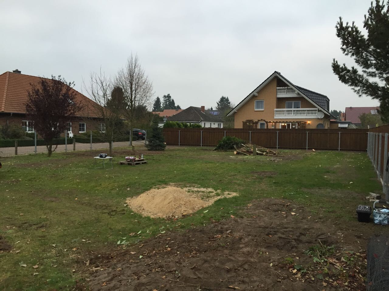

Plot from the south (not yet at the southern boundary):
Garden area in front of the house with a pile of sand, stacks of wood, and construction tools
