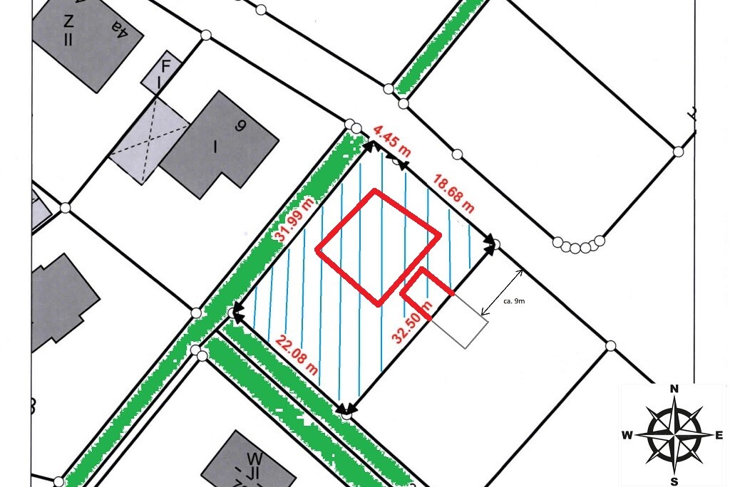

Why place the garage on the south side? Your neighbor certainly didn’t build theirs facing north without a reason.
So, garage or carport?
Then add a city villa.
Oh dear, first of all, thanks for the comments. I’m actually taking them in a factual way and don’t see them as negative. Rather helpful.
The points you list are not immediately obvious if you have tunnel vision. That’s why I’m presenting this here for some lateral thinking.
I really need to take another look at it.
We already had an appointment with a builder.
The meeting went so that he took note of our wishes, but will now create the floor plan/design himself.
I’m curious to see if it will fit better.
My idea was that I could build garage to garage.
To the north, I don’t have a neighbor because there is a green strip there. I would have to respect the building setback (3m (10 feet) distance) and would lose width because of that.
I sketched it in the site plan.

hanghaus2000 schrieb:
Why is the garage facing south? Your neighbor surely didn’t build theirs to the north for no reason.
So, is it garage or carport?
In this case, I would probably leave the northwest side open, as the evening sun shines nicely there in summer.

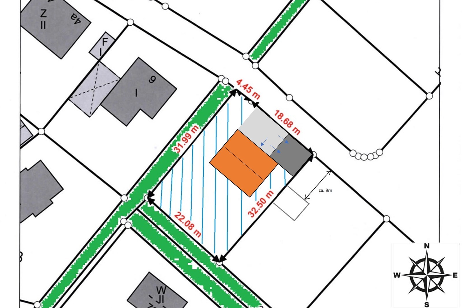

For this plot, I would consider the following orientation, since the restrictions for the house might be less, and above all, there would be more space for windows on the sunny side... (the blue arrows indicate access for people and cars)
Sommesba schrieb:
On the north side, I don’t have a neighbor because there is a greenbelt there. I would have to maintain the building setback (3m (10 feet) distance) and would lose width as a result. It should be possible to fulfill up to half of the building setback within the greenbelt.
