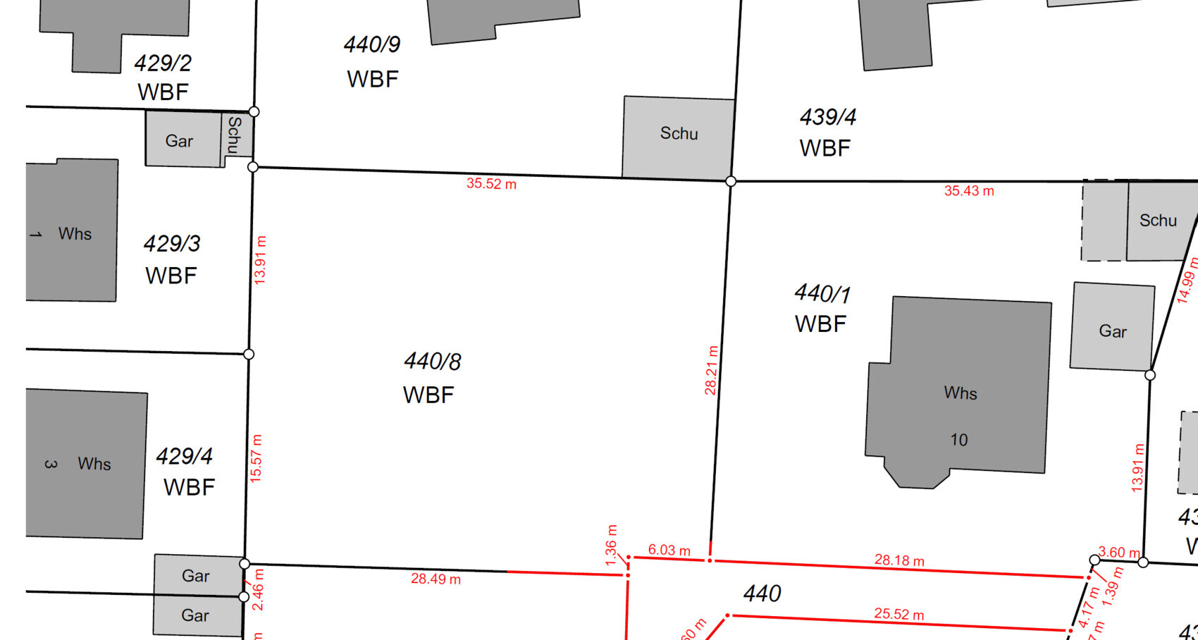

Framework Conditions
Development plan / restrictions:
Section 34 of the Federal Building Code (no classic development plan; neighborhood development is decisive).
Single-family houses with gable or hipped roofs are permitted (currently clarifying if a hipped roof is allowed).
Plot size:
Approx. 1,000 m² (2,710 sq ft) (parcel 440/8).
Slope:
Slight southern slope, elevation difference approx. 0.8 m (2.6 ft).
Planned building height approx. 0.5 m (1.6 ft) above street level (similar to the neighbor). The rest of the garden shall be as level as possible by adding fill.
Site coverage ratio:
Not explicitly specified, compliant with Section 34 – adapted to neighboring buildings (approx. 0.35 realistic).
Floor area ratio (FAR):
Also Section 34-compliant, oriented on neighboring houses with two full stories.
Boundary setbacks:
Distances according to the State Building Code of Baden-Württemberg, minimum 3 m (10 ft). Garage on the boundary allowed.

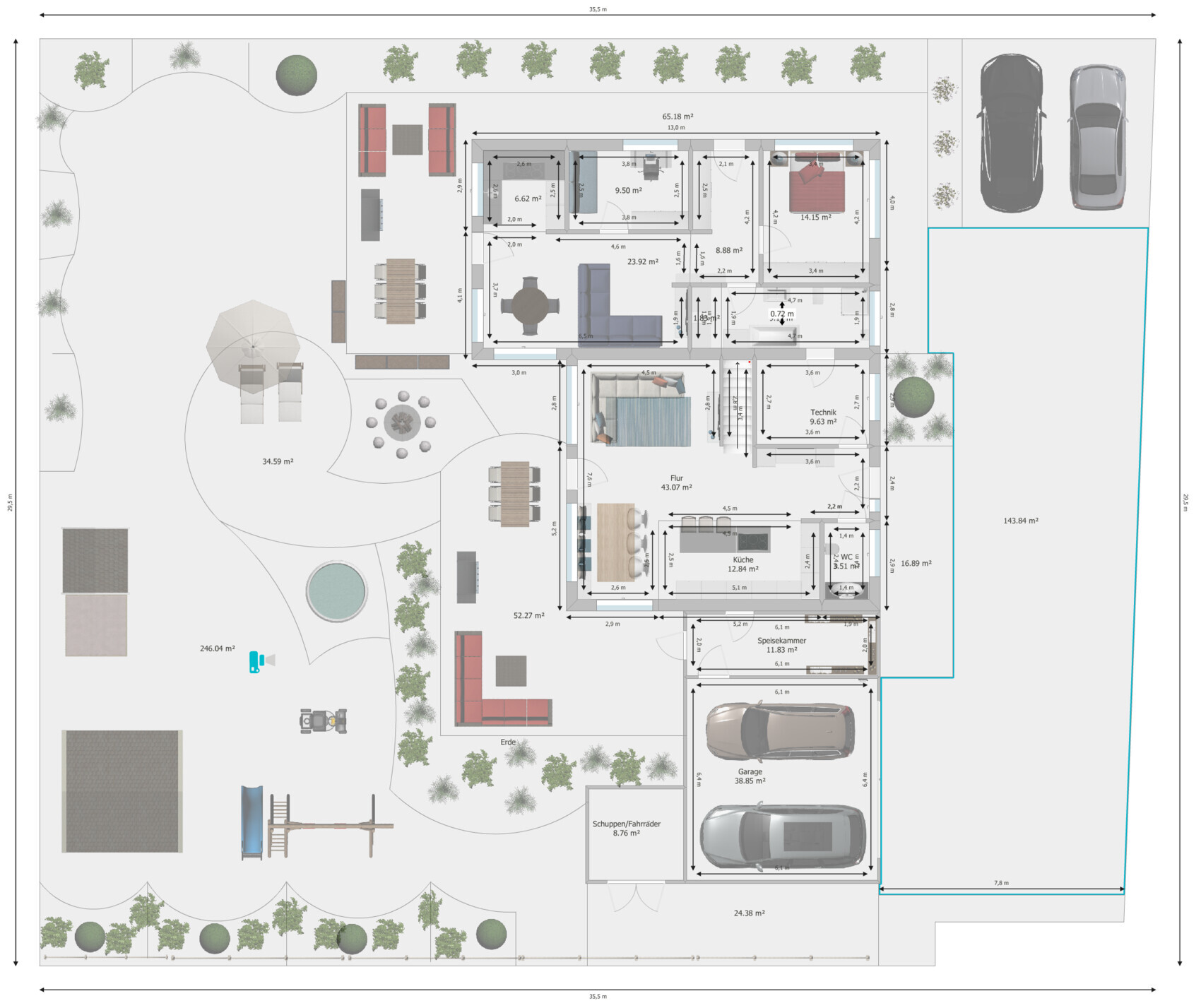

What do you like most? Why?

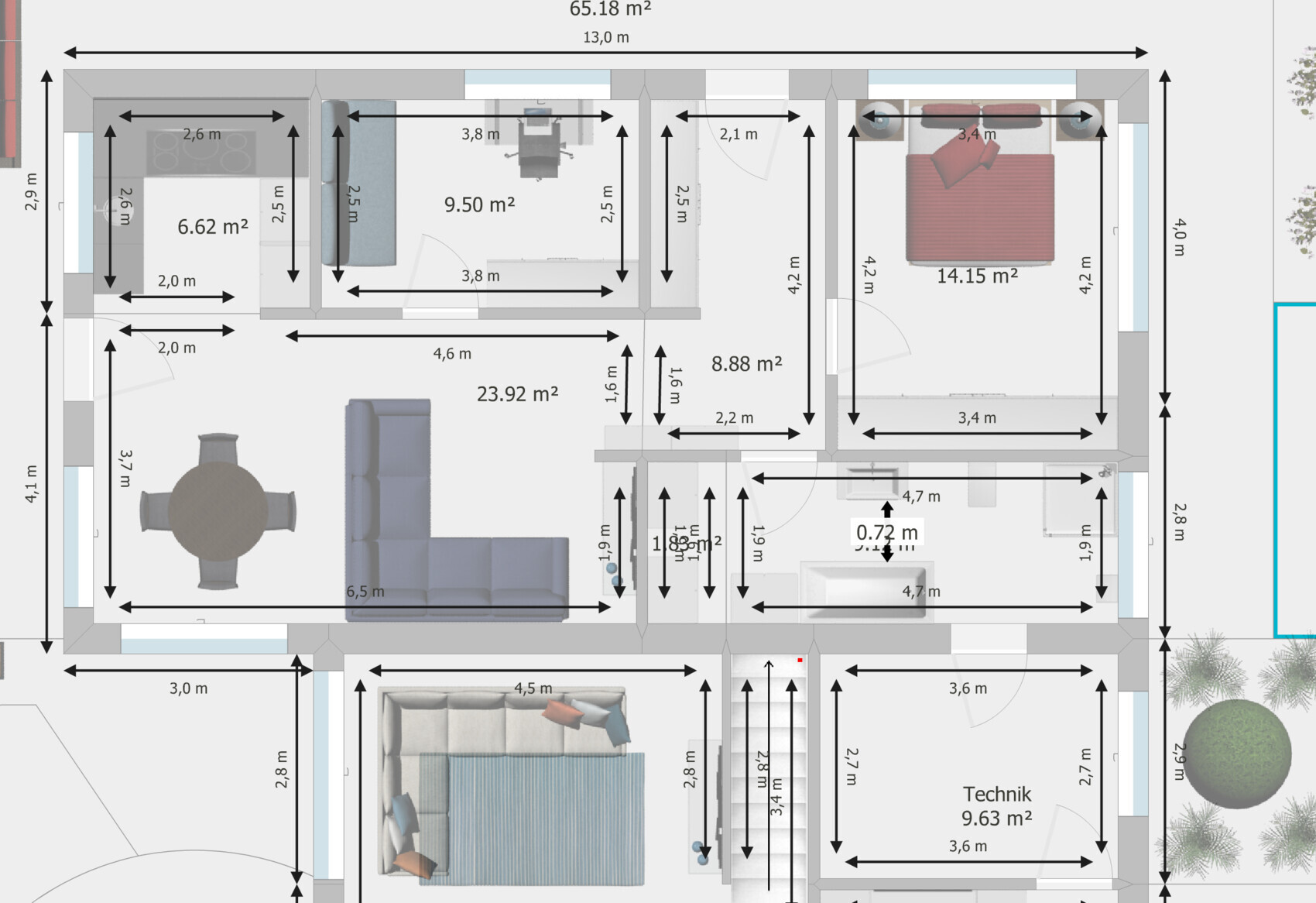

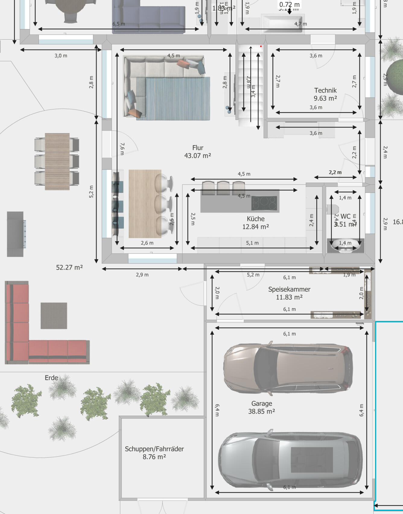

- Open, bright living area with nice southwest orientation
- Separation of family and apartment areas without losing overall aesthetic
- Functional floor plan with clear traffic routes and large window fronts
What do you dislike? Why?
- Some room sizes and window arrangements still don’t feel quite right
- Ground floor sometimes feels a bit tight
- No more space for a pantry in the main house, therefore planned in the garage extension
- Upper floor corridor might be a bit long
- Kitchen possibly too open to the living area, too close to the dining area.

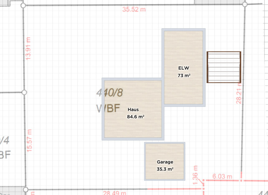

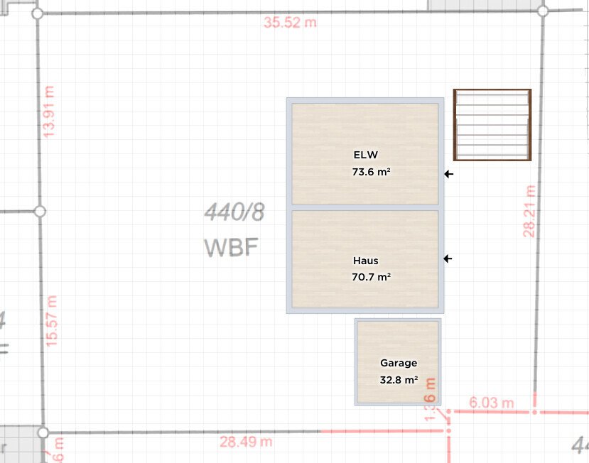

hanghaus20238 Oct 2025 08:45Is there a design ordinance from the municipality? Otherwise, Section 34 does not specify a roof shape.
Oh dear, if the costs are already over budget by 100,000, you should aim to save around 150,000. It usually ends up being more expensive than stated in the quote.
YPG has already written something about the granny flat. Consider how accessible you want it to be. The bathroom only works, among other things, as long as both people can walk without assistance.
I also support reducing the size of the driveway.
Overall, both units just seem randomly combined. I find the passage through the utility area practical. This way, you can access the other area without compromising privacy, but you still don’t enter the bathroom. The kids dash through there when they want to quickly visit grandma.
The dining area in your apartment is too narrow; maybe a beer bench would fit. The minimum width should be 1m (3.3 ft) + table width + 1m (3.3 ft), and even that is really tight.
Go back to the drawing board. Define your must-have requirements and your nice-to-have features again. Remove everything that isn’t essential, draw your current and desired furniture to scale, and move things around. Try to reduce the size and untangle the layout like a game of Tetris.
I visited here yesterday and, considering the drawings were, to put it kindly, the opposite of self-explanatory, I thought I should check back today. That was probably a bit too soon.
haydee schrieb:
The bathroom only works as long as both can walk without assistance. Not really. When someone is getting ready at the washbasin, there’s no way to get to the toilet. Nobody likes being disturbed while washing, applying makeup, or doing their hair. People over 60 aren’t any different.
haydee schrieb:
That way, you can access the other area without compromising privacy. Well, one could sneak over to the parents’ and “borrow” some eggs. The kids can play pranks. The curious elderly father might inspect all rooms when no one is home. People don’t always remember to lock interior doors.
SaschaG. schrieb:
That’s a door in the utility room to allow access from the granny flat as well, since the parents-in-law would also use it as a laundry or utility area. Since a flat needs a storage room anyway, and a 9sqm (97 sq ft) utility/technical room is not very large, it probably can’t accommodate two doors plus a window. It might be better to keep the washing machine inside the flat after all.
hanghaus2023 schrieb:
If the builder is already €100,000 over budget, what’s the point in discussing the floor plan at all? Start over smaller. You’re probably right. Hallways should be drastically reduced, and the upper floor should have proper, regular rooms without extra corners. The kids’ bathroom and second office need reconsideration. So far, it looks like a playful “this-is-how-our-house-could-look” concept rather than a realistic plan. Some room sizes, including the pantry, are clearly too large.
At €3,000/sqm (approximately $280/sq ft), about 30sqm (320 sq ft) of space is wasted upstairs—space that realistically isn’t needed, unless you want a corridor with the feel of a castle. But a castle-sized home is not an option here.
SaschaG. schrieb:
Personal price limit for the house including fixtures:
About €700,000. That’s a problem! As already mentioned, living space costs money. While 75sqm (810 sq ft) might be an attractive size, it won’t come under €200,000. Also, if you want individuality in the house shape and concept, you won’t get €3,000 but more like €3,300 to €3,500/sqm ($310 to $325/sq ft).
A standard house model, more like a production house, would be more affordable. With about 160sqm (1,720 sq ft) plus 75sqm (810 sq ft), you could likely stay within €700,000—excluding additional building costs and a double garage.
Furthermore, I would suggest planning for more privacy in the garden, even if it’s meant as a social space. Relatives don’t necessarily share the same interests after work and often have their own social circles.
You don’t need separate entrances for that: paved surfaces are expensive, and having to walk constantly around the house (granny flat) can be tiring. Long paths should always be avoided.
That’s why I would first use templates to outline the property. For example like this, or something similar—you need to compare this with standard house types:
[ATTACH alt="Bildschirmfoto 2025-10-08 um 15.09.58.png"]93073[/ATTACH]
If you don’t want to give up a compact layout and want to save costs here, the living area upstairs must be reduced decisively. Over the decades, a gable roof on a single-story has proven successful. As far as I know, paragraph 34 does not restrict such a design. But I do see a problem in your planning regarding vehicle turning space. Well, this is just a quick and rough sketch anyway.
