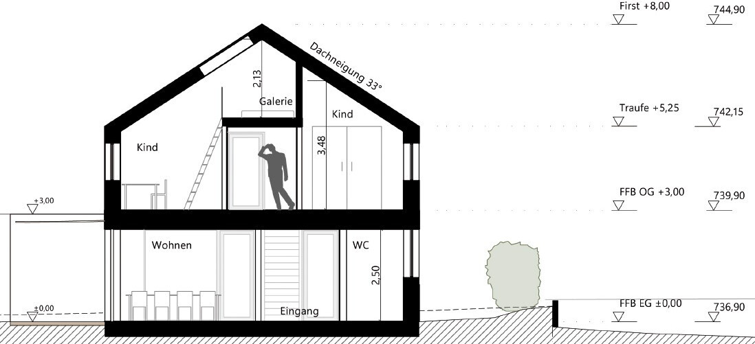

Schnittdarstellung eines zweigeschossigen Hauses mit Dachgeschoss, Innenräumen und Garten.

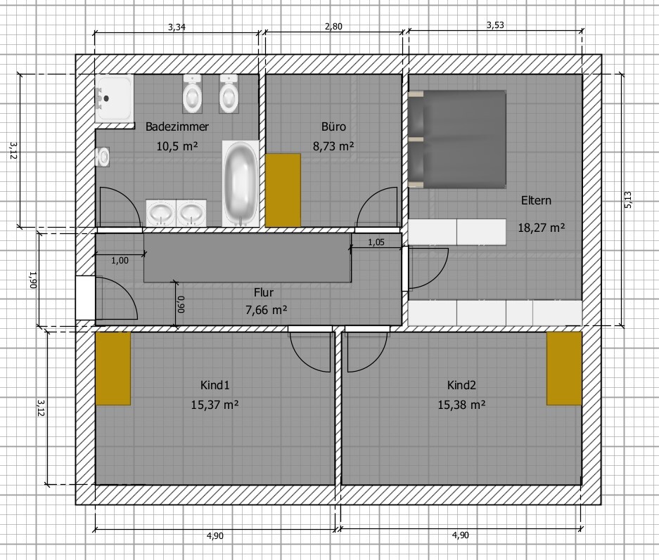

Floor plan of a house with kitchen, dining area, living room, bathroom; site with measurements.
Floor plan of a house with master bedroom, two children's rooms, office, bathroom, and hallway.

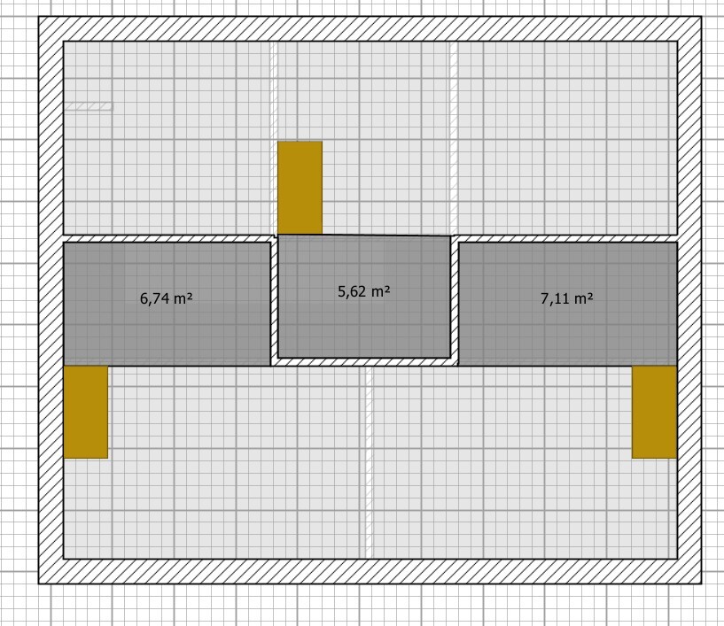

Floor plan with three gray rooms (6.74; 5.62; 7.11 m² (72.6; 60.5; 76.5 sq ft)) and yellow doors.

Well, first of all, if I were you, I would reconsider whether a straight staircase is really necessary. You don’t gain much from the look of a straight staircase—not only because of the narrow hallway but also because of the cabinets—and secondly, it takes up your hallway space. You can conveniently place a storage room under a winding staircase. I would remove the staircase from the hallway to save space. It doesn’t get better when you draw little white boxes “there at the entrance” that have nothing to do with proper wardrobe cabinets. And yet you have to enter the house single file without any room to take off jackets.
The idea of coming home, taking off outdoor clothing, or getting ready to go out just isn’t working here.
Then, I would think about your daily routine, how you use the courtyard, and the sun terrace.
I actually see the courtyard more as a dining terrace, and positioning the kitchen there would kill two birds with one stone—also creating a shorter path from the entrance to the kitchen. It might even help to give up a corner in the south for a better entrance and thus a better overall floor plan.
Upstairs, the children’s rooms are much better, so you can have a bed downstairs as well. But be aware that even in the office, the headroom near the stairs will be only about 1.20/1.40m (3.9/4.6 ft). This means that combined with the stairs and bending over, you might stumble. So this is not an optimal storage space.
Otherwise, my only advice is to have the architect revisit the plan. Keep in mind that his dimensions are for the shell structure (shell-in-place). You still have to add things like plaster and tiles on top of the wall. For the staircase, the railing can add thickness as well. With brackets or posts, this could add another 10cm (4 inches).

@Abartig … the average ridge height is listed as 8 m (26 feet)… ah, but I just realized, okay, I had seen 744.9 in the checklist as a typo and thought it was 7.44, so okay, but you can still see the very low headroom in the gallery area.
Section through a two-story house: living area, entrance, WC, staircase, child’s room, gallery
