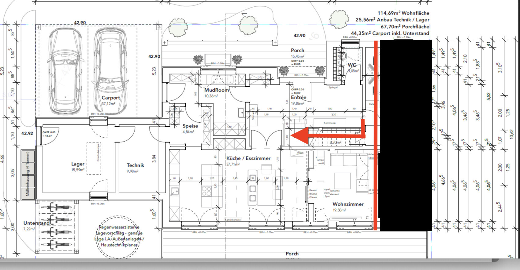

Hi everyone,
we are planning to build a prefabricated timber-frame house in the American style.
Before choosing a supplier, we worked with an architect to develop a floor plan. The architect’s latest draft was acceptable, but we made some corrections and have now incorporated them into the floor plan via screenshots. I hope everything is still clear enough for evaluation despite that.
We are now entering the third round with the architect. After this, any further planning or changes will incur additional costs. Therefore, we are hoping for tips and constructive criticism.
Note: In the house visualizations, the carport roof is still very high (architect’s planning mistake, as the upper floor windows would have looked directly onto the carport roof...). The roof pitch will be lowered so that only a small roof remains.
Rear view: There is no railing on the back terrace, as the small roof at the carport should serve as a bicycle parking area, but this will be removed.
Thank you very much in advance for all your efforts.
Plot size: 1000sqm (about 10,764 sq ft)
Slope: no
Floor area ratio (FAR): 0.28
Plot ratio / building coverage index: n.a.
Building envelope, building line and boundaries: see site plan
Edge development
Number of floors: 1
Roof type: gable roof, hip roof, half-hipped roof, etc.
Style: n.a.
Orientation: S/SW
Maximum heights / limits: ridge height 9m (30 ft), eaves height 4.30m (14 ft)
Other requirements: none
Client requirements
Style, roof type, building type: American farmhouse, gable roof
Basement, floors: no basement
Number of occupants, age: 2 adults, 1 child
Floor space required on ground floor (GF), upper floor (UF): approx. 160-170sqm (1,722-1,829 sq ft)
Office: family use or home office? Workspace for 2 people, both working from home, private use
Guests per year: 5
Open or closed layout: open kitchen-dining area
Conservative or modern style: farmhouse / modern
Number of dining seats: 6
Fireplace: no
Music / stereo wall: no
Garage, carport: carport, 2 parking spaces required
Additional wishes / special features / daily routines, including reasons why some things are preferred or avoided:
- Because of the American style, we have covered terraces both at the front and back. We hope this means we won’t have the typical “mudroom” at the entrance (dirt settles on the terrace, shoes can possibly stay outside).
- No office on the upper floor due to sloping ceilings. The desks are height-adjustable, and we have bookshelves there... this would be difficult to accommodate.
- Laundry room on the upper floor with space for a drying rack is great – short distances.
- The living room should be separable to reduce noise from the kitchen (currently we have an open kitchen-dining-living area and it’s hard to watch TV when someone is cooking).
Who designed the plan: Architect and our ideas
What do you like best? Why? Large kitchen-dining area
What do you dislike? Why?

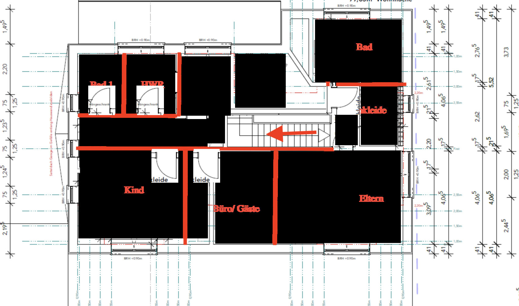

The upper floor feels too big because we have – unfortunately – more rooms downstairs than upstairs. Does anyone see potential to save some floor space?
The wardrobe ended up there because the small room was still “left over.” It was originally the guest bathroom without a shower. We would like to have 2 showers in the house.
Estimated price according to architect/planner: 800,000 EUR
Personal price limit for the house, including fixtures: 800k
Preferred heating system: air-to-water heat pump, underfloor heating
If you had to give up any details or additional features:
- can give up: "all-purpose room" (see floor plan)
- cannot give up: mudroom
The floor plan ideas come from a collection of house tour videos and Pinterest inspirations.
Since the construction method places strong emphasis on symmetry and harmony in the façade, moving windows around is not “just possible” without causing visual chaos from the outside.
What do you think are its strong and weak points? Well, that’s the question. For us personally, everything is now taken into account, but is it also “logical”? Are there planning errors? What can be improved?

Schorsch_baut24 Jun 2024 09:50The ground floor from the architect’s design is at least logically arranged. On the upper floor, I would have swapped the children’s room with the parents’ room and left the rest as it is. That way, the man would have a shorter path to the bathroom. Maybe you could even add a children’s bathroom, so you would have two showers.
But it’s definitely possible to build better.
Do you have farmland or a job/hobby where you get very dirty? A mudroom or a terrace to wash off the dirt?
The house’s appearance is refreshingly different. What inspired this design? Have you ever lived in a house like this? The budget might be tight. Such a large house with so many narrow spaces.
Is the utility room really just for the technical equipment and maybe a snow shovel? Many people also store their toolbox, spare batteries, and tapes there. The door to the garage and utility room looks quite narrow.
I only know mudrooms from agriculture, and yes, they make sense there. Usually, a shower is connected as well.
You have two wardrobes far apart. I can already see it: “Hurry, the school bus is about to leave.” “Mom, where are my shoes?” Here we go: hallway, kitchen, pantry, mudroom—only to find they’re not there—so pantry, kitchen, terrace—finally, there they are.
The guest bathroom toilet is very tight.
There is a lot of hallway space due to the traffic routes.
With two home offices and the available space, wouldn’t a second office be more practical?
Maybe move the office upstairs so the upper floor doesn’t feel so empty.
Upstairs, the dressing room and the anteroom in front of it: much of this area is below the 2m (6.6 ft) height line, for example, the seating area in the large hallway, the wardrobe in the dressing room, etc.
Somehow, the floor plan and the shape of the house don’t really fit together.

Schorsch_baut24 Jun 2024 10:19Schorsch_baut schrieb:
With the staircase direction reversed.Is it possible to shorten the house by 2 meters (about 6.5 feet), specifically at the coat area at the top of the plan and the living/dining area?S
Schorsch_baut24 Jun 2024 10:44H
hanghaus202324 Jun 2024 11:30I can hardly see anything that matches the American standard. Usually, every bedroom has its own bathroom. I wouldn’t like the hallway next to the stairs with the sloping roof. Many standard layouts offer more in that regard.
