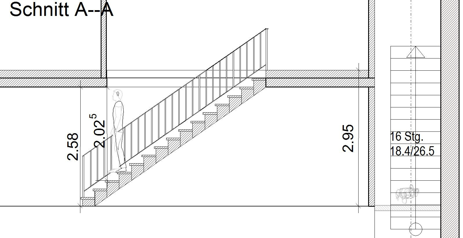

- What I am still struggling with: the living area is intended to be bright and open. But on the other hand, the sofa should not be placed in front of a (floor-to-ceiling) window as shown in the design. I would be especially interested in ideas for this.
- The living area also has a small split-level, adapting the building somewhat to the slight slope of the land. The drawbacks, such as reduced accessibility, are known and this is not decided yet. I would particularly welcome opinions on this...
- Regarding the entrance area: we told the architect that we would like a covered entrance. I have gotten used to the design now and probably am a bit too accustomed to it.
- The staircase is 1 meter (3.3 feet) wide but feels almost a bit narrow to me.

Much has already been discussed ... I just noticed the overhang of the first two stair steps. I don’t know what floor-to-ceiling height is planned or how tall you are, but especially for taller people, there could be head clearance issues when going downstairs. Since this is not yet a finalized detailed plan, in reality, there might even be an overhang of 2.5 steps.
