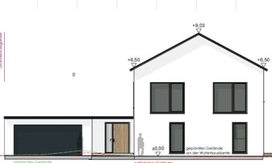

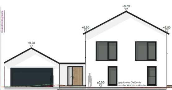

hanghaus20234 Oct 2024 15:56This is how it should look with the garage ridge direction rotated.
Responses in the text.
A house with a generous knee wall and a steeper roof pitch should be more economical.
SliPkNoT1848 schrieb:
In my opinion, this is the minimum requirement.
- Wall height ground floor + upper floor (currently we have 2.50 m (8 ft 2 in) each)
Gable windows make sense if the space will be used.
- Wall windows in the attic?
Roof windows make sense where the stair landing clearance is too low.
- Consideration of roof windows
Bathroom planning should already be considered. In my design, I saved some square meters that I would invest in a children's bathroom for three kids.
- When should we start detailed kitchen and bathroom planning? Could that still affect the floor plan?
The architect should have more experience with the windows. I just noticed that the windows on the upper floor are quite large.
- Various window sizes and shapes, as well as their arrangement
The window on the upper floor is sufficient and cannot be made larger. In my design, this would be possible because there is a flat roof.
- Too little daylight at the stairs on the ground floor (window like on ground floor instead of an interior window?)
No problem in my design. The bathroom definitely needs to be planned. Do you have a washing machine and dryer in the bathroom? Another set in the utility room?
- Skylight window in the bathroom facing the garage possible? How much would the garage roof pitch need to be reduced? Possibly a slightly asynchronous garage roof design?
As mentioned, two bathrooms could fit there, or at least a utility room.
- Current impression: bathroom very large, dressing room relatively small
If you want to use the attic, a roof window is necessary.
- What effects does the 1.78 m (5 ft 10 in) wall height have at the entrance to the attic?
Appliances should be drawn in.
- Representation of appliances in the utility/technical room possible? Possibly spatial separation feasible?
This should be reconsidered entirely. I like a direct entrance to the house from the garage. But your layout is quite a maze.
- Positioning of the door in the utility/technical room, possibly towards east-south?
Large windows, 200 m² (2,150 sq ft), double garage, and finished attic
- Any indications of current potential cost drivers

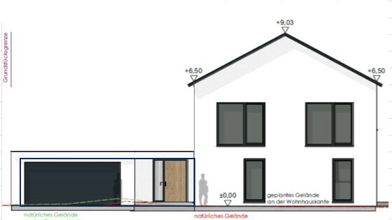

hanghaus20234 Oct 2024 16:06In the old post https://www.hausbau-forum.de/threads/doppelgarage-grenzbebauung-in-bayern.47886/page-2 in #9, @ypg quoted the state building code, which states that the garage as planned is allowed. However, I wouldn’t like it.

hanghaus20234 Oct 2024 16:26Possibly with a small parapet. 4 minutes?
