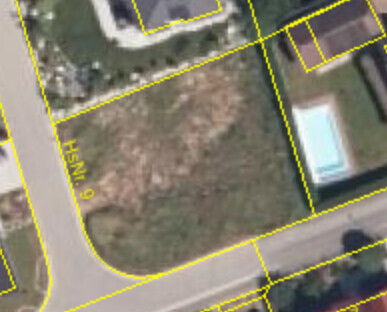

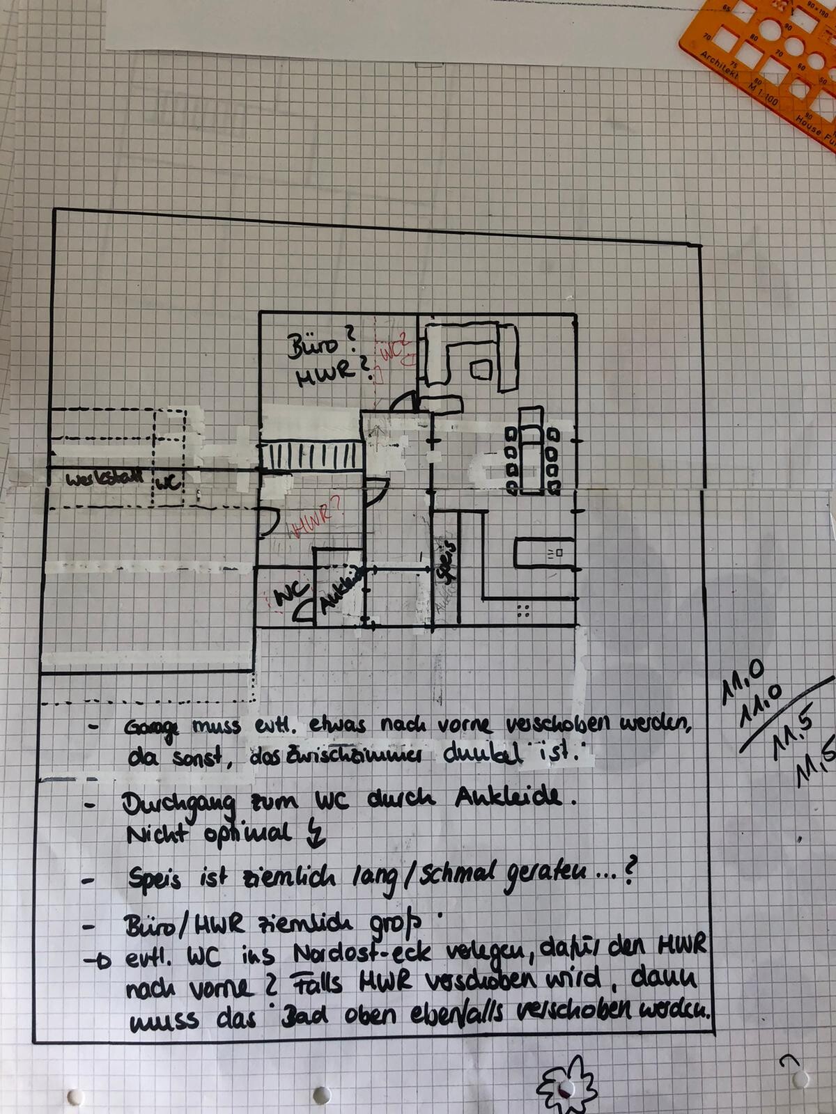

my wife and I, currently without children, have recently purchased a plot of land that we plan to build on. However, designing the floor plan, especially for the ground floor, is proving challenging even with the help of a draftsman, which is why I am turning to this forum. Maybe someone can offer some advice.
Here are a few ideas for the house, and perhaps you can help us with the implementation =)
Plot: 625 sqm (6726 sq ft), corner lot, new development area, streets on the south and west sides

- Ground floor with open kitchen (southwest side), living and dining area, pantry, toilet, wardrobe, hallway, utility/technical room, preferably a straight staircase to the upper floor, possibly an office
- Upper floor: hallway, bathroom, at least 2 children's rooms, possibly a 3rd child’s room or office, master bedroom with walk-in closet
- Master bedroom and walk-in closet on the upper floor: master bedroom with one door to the hallway and one to the walk-in closet; closet with one door to the hallway and one to the master bedroom
- Bathroom on the upper floor: with shower, bathtub, toilet, double sinks, and laundry chute to the floor below (-> bathroom above the utility room)
- Garden and covered terrace on the west (and south) side
We understand that it may not be possible to meet every aspect perfectly, but we want to get as close as possible.
My main concern is to design the ground floor well; I am more flexible and have fewer requirements for the upper floor.

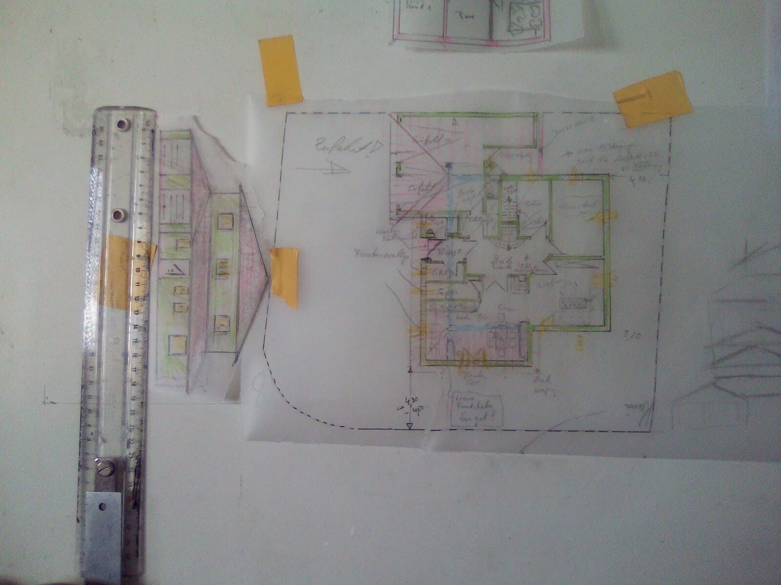

Attached are some photos of the plot and current plans. The images labeled "2 EG" are from the architect, and many ideas still need to be incorporated.
The areas marked in black pen are our own sketches with handwritten suggestions for improvement, which obviously still need substantial refinement.
Peter

peteeeeey schrieb:
That’s not possible either. I can place the garage differently, for example with the driveway on the east side, but I’d rather not. Why not? The positioning would have some advantages
Take a look at the sun position using the tools available online. Especially in summer, the sun sets more towards the northwest in the evening – and in your plan, that’s where the garage and the entrance to the house are located.
The overall orientation on your plans basically makes sense and might be more consistent with the street layout. I’m just a bit surprised because you specifically mention evening sun as a priority, but the orientation doesn’t really reflect that.
You could plant a nice tree in the south-east corner of the plot that would provide pleasant shade on the terrace around midday in 20 years.
