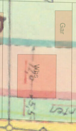

ᐅ Floor plan single-family house 150 m² on a 448 m² plot, 1.5 stories
Created on: 14 Jan 2022 18:26
HoisleBauer22
Plot size: 448 m² (5400 sq ft)
Slope: No
Floor area ratio: 0.28 (setback left + right 3 m (10 ft))
Floor space index: ?
Building envelope, building line and boundary: see plan
Edge development: see plan
Number of parking spaces: 1.5 (as required)
Number of stories: 1–1.5
Roof type: gable roof, 45 degrees, approx. 1.30 m (4 ft 3 in) knee wall
Architectural style: classic
Orientation: see plan
Maximum heights/limits
Additional requirements
Style, roof type, building type: suitable
Basement, floors: fully basemented
Number of occupants, ages: 2 adults, 3 children
Office: home office
Guest bedrooms per year: once
Open or closed floor plan: closed
Conservative or modern design: conservative
Number of dining seats: 1
Fireplace: if budget allows
Music/stereo wall: no
Garage, carport: carport
Utility garden, greenhouse: yes
Additional wishes/special features/daily routine, also reasons why something should or should not be included
Planner: planner from a construction company
What do you especially like? Why? Large children’s rooms
What do you dislike? Why? Office on the ground floor will be converted to a bedroom later, office in the basement
Cost estimate according to architect/planner: 430K + about 100K additional costs
Personal budget limit for house, including fittings: 430K
Preferred heating system: air-to-water heat pump
If you have to give up anything, which details/features
Can you give up: fireplace
Cannot give up: storage room on the ground floor, office
Why does the design look the way it does?
Standard design from the planner? Close to a production house model (some walls cannot be moved)
What do you think is particularly good or bad? Very pragmatic/efficient, maximum space for living room, 3 equally sized children’s rooms on the upper floor. Maximizes usable living space under very restrictive development plan.
What is the most important basic question about the floor plan, summarized in 130 characters?
1. Are there any no-gos, things we might have overlooked?
2. How can we get another office on the ground floor (or upper floor) through modifications?
3. The hallway is quite small – is that a problem?

HoisleBauer2216 Jan 2022 00:14haydee schrieb:
Is the light well still an option? Building plot and floor-area ratio? The light well is theoretically possible as a projection, but the KfW55EE application (which would be relevant due to increased U-values from additional or larger basement windows, right?) is already approved. Of course, some windows elsewhere could be omitted... We don’t have a floor-area ratio, only a building envelope (marked in red in the attachment) with a length of 12m (39 feet) and limited by a green strip. As far as I know, a light well doesn’t require a setback from the neighboring property.
haydee schrieb:
So much space under the roof and then not usable? Wasteful.
Make sure you get an offer for it properly insulated and accessible. I agree with you. I will ask about it. But how is heating supposed to work? Infrared panels on the floor, right?
And then at least two double casement windows are needed, which would reduce the yield of my eventually planned photovoltaic system...
HoisleBauer22 schrieb:
A light well theoretically counts as an upgrade, You can do that yourself.
but the KfW55EE application (would be relevant because of the increase in the U-value due to additional or larger basement windows, right? Take the west side, then you gain. Somewhere where there is no terrace anymore (NW)
As far as I know, a light well does not require a setback from the neighboring property. To my knowledge, it does.
Huh? Currently, the living room is on the west side… kitchen in the south! Again: are you aware of this? Your current drawing shows the living room on the west side. If swapped, it would be in the south.
