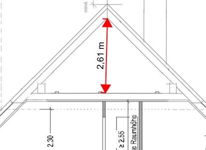

Thermal envelope yes, but due to missing windows and the inability to build higher (limit on ridge height around 9m (30 feet)), the room height of 2.30 m (7.5 feet) is too low for a living space according to standards. Would a higher basement cause problems exceeding the allowed height from the upper finished floor level of the ground floor, or do you have an absolute reference height that this would conflict with?
Pinkiponk schrieb:
Could you please explain what you mean by lacking care? The general attitude of sending homeowners with three children to sleep or work in the basement. The typical standard floor plan ;-) is designed for one to two children and is nowhere spacious enough to adjust the children’s rooms through different layouts. As a result, instead of starting with a budget-appropriate model, you have to take a smaller one that is then extended along the ridge axis. In this case, the provider apparently preferred the usual “sales-driven planning” path :-(

HoisleBauer2215 Jan 2022 18:25haydee schrieb:
How high is the attic?
It bothers me that one room is missing.The attic is not officially allowed to be converted into living space, meaning windows are not permitted. It is also not tall enough. That one room (whether it is an office or the master bedroom) therefore has to be placed in the basement. I prefer to move the bedroom to the basement, and as @Pinkiponk mentions, living down there can’t hurt. It will be funny if a child wants to come all the way down to the parents at night 🙂
HoisleBauer22 schrieb:
The attic space is officially not allowed to be converted into living space, meaning windows are not permitted.That’s nonsense. The correct statement is: it is not allowed to become an official habitable room. However, you are still allowed to renovate it and use it for hobbies or as an office.
You can install windows anywhere, whether double casement windows or a small square or triangular window at the top of the gable. After all, windows are permitted in the attic.
However, Heinz von Heiden will offer you a non-accessible cold roof. Ask about the cost of making the attic accessible and insulated (full insulation, not a cold roof).
