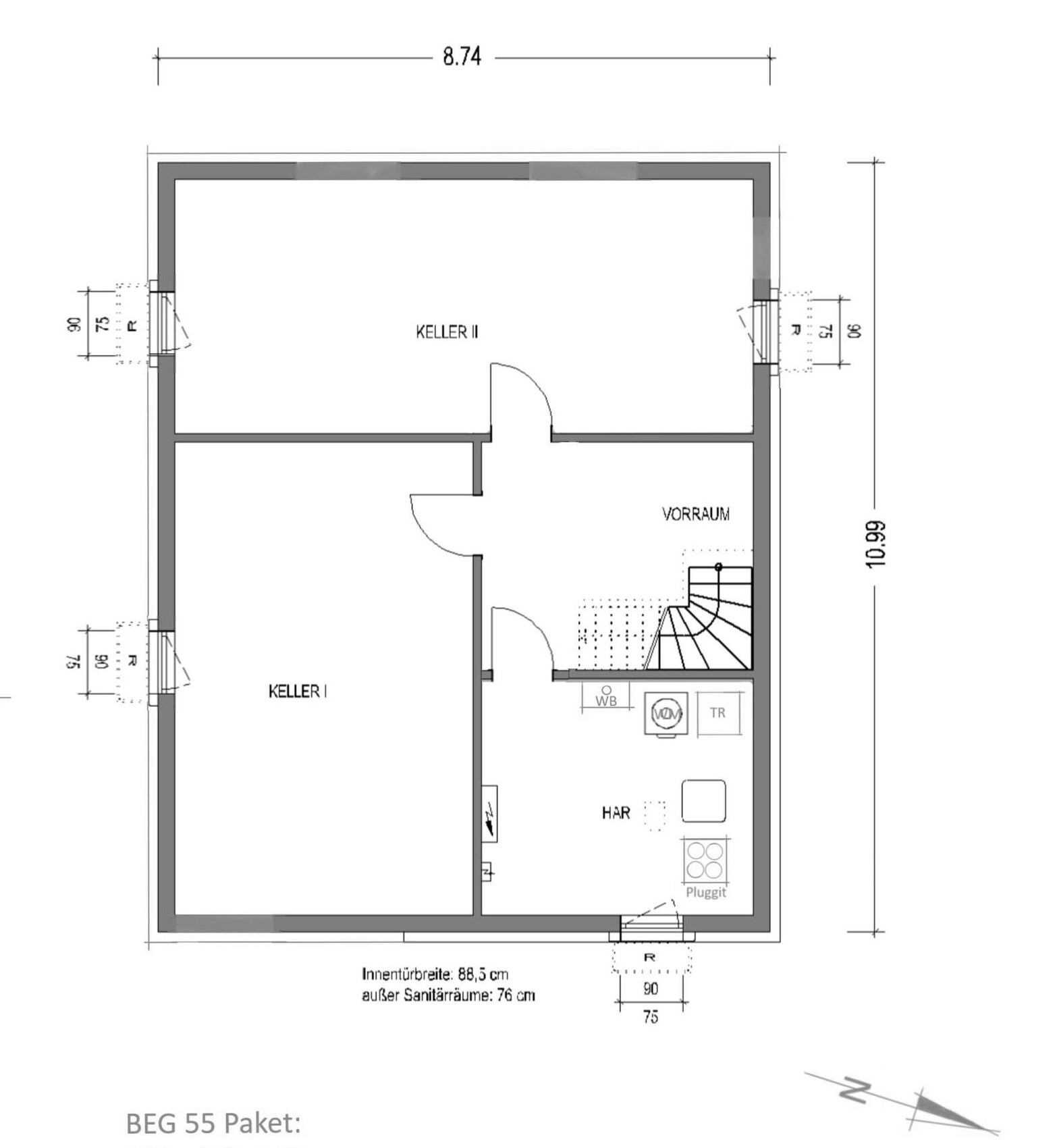

Basement floor plan: Basement I & II, entrance hall, stairs, building services.

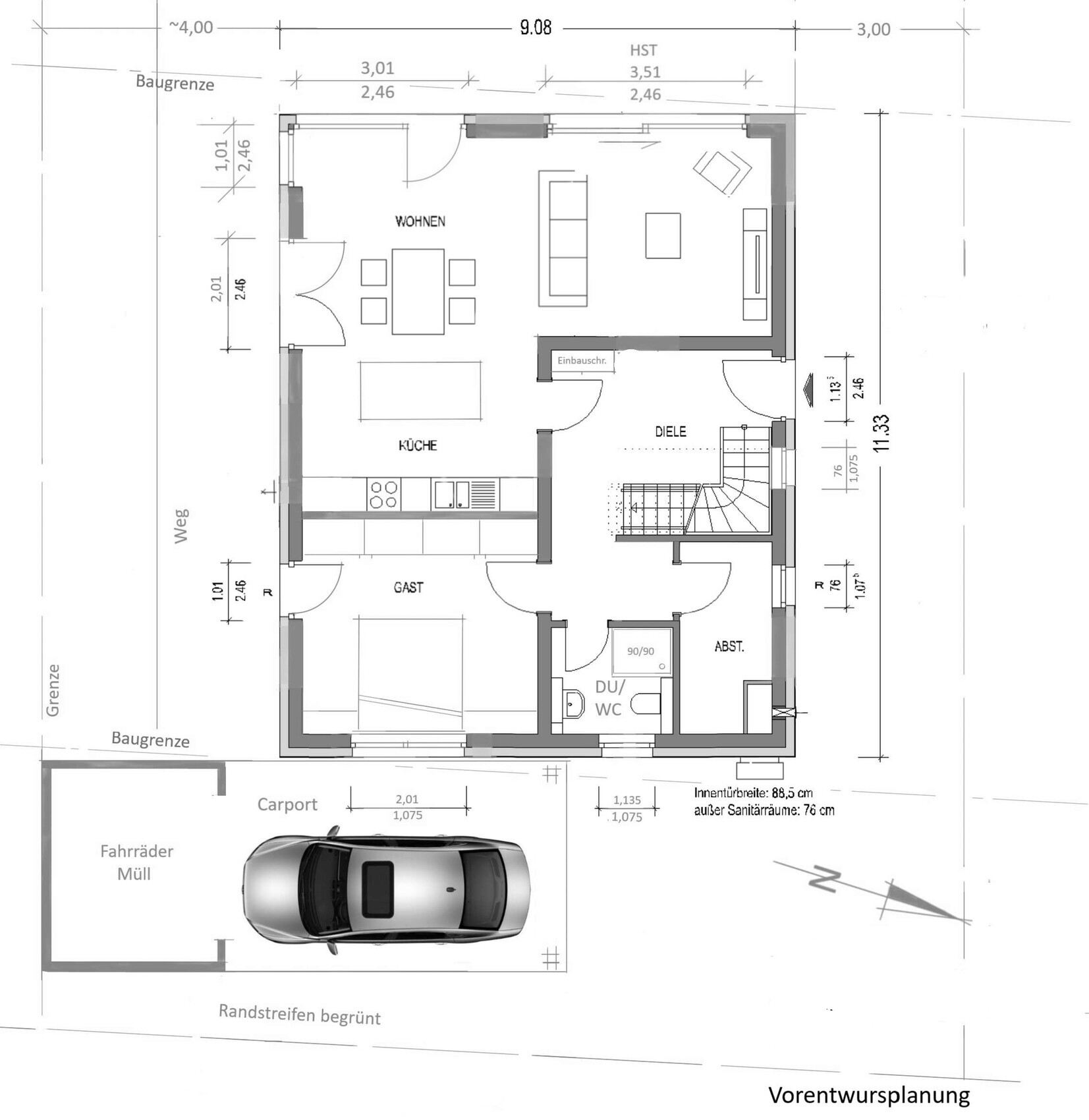

Ground floor plan: Living, kitchen, guest, hallway, shower/toilet, storage room, stairs, carport.

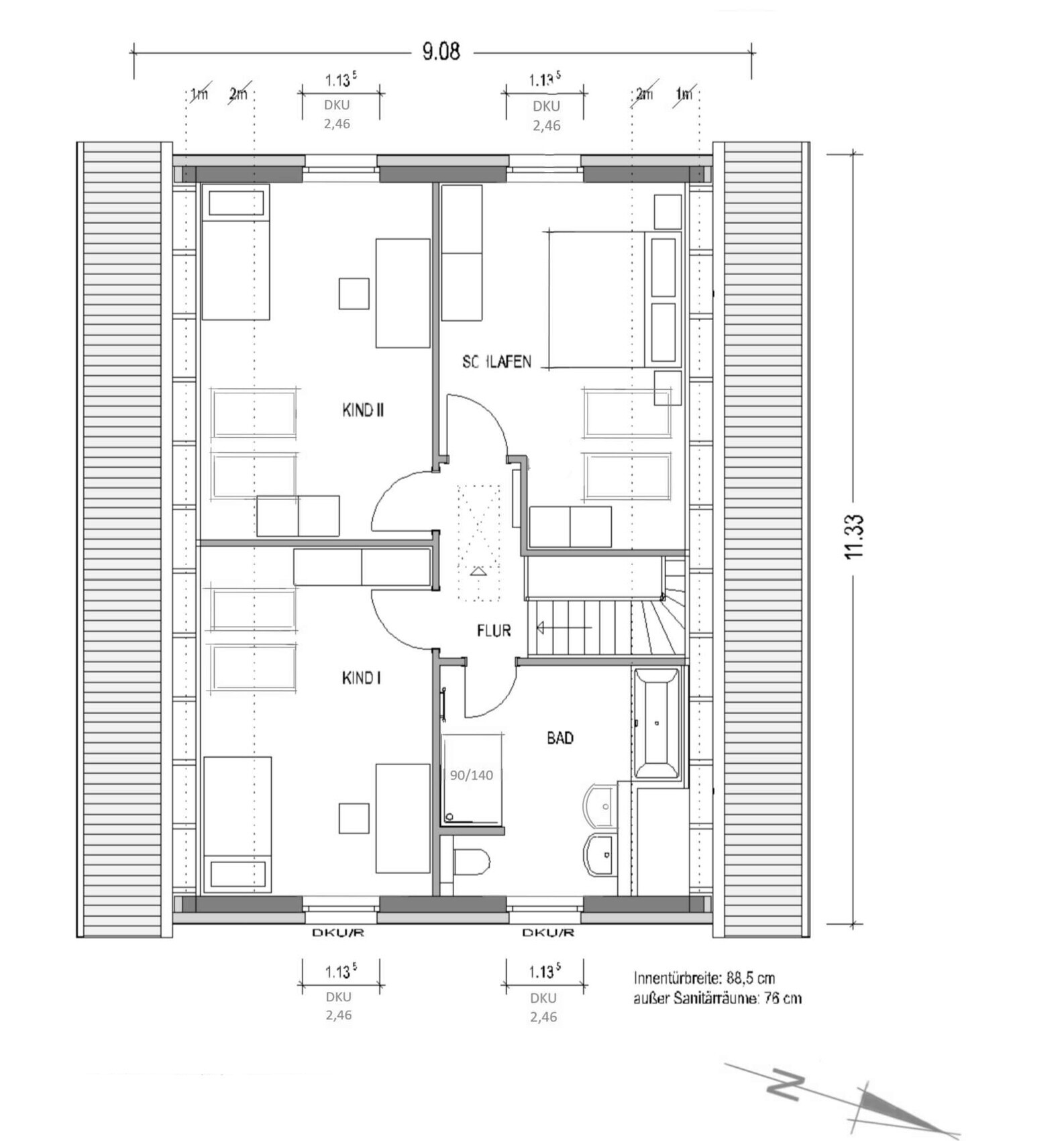

Upper floor plan: Hallway, bathroom, stairs, CHILD I, CHILD II, bedroom.

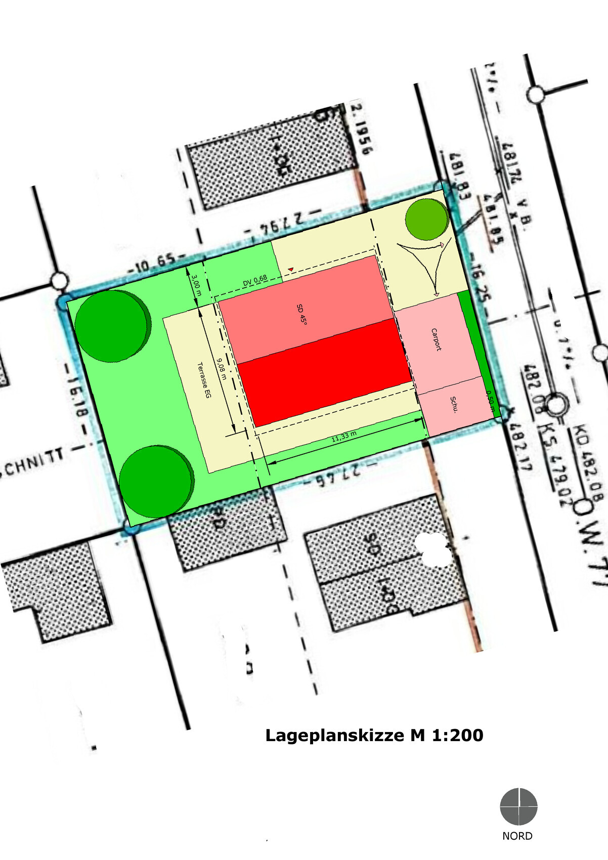

Site plan 1:200: Property with green garden, red building, carport, and trees

Additional note: What is labeled as "guest" on the ground floor is actually the office or the adults' bedroom. This was entered incorrectly.
If it is an office, then the bedroom would have to be moved to the basement. Thanks to underfloor heating, this would theoretically not be a problem. However, the basement rooms each have only one light well, so there is very little natural light. -> This is our main issue with the floor plan.

Where is the driveway?

3 children, 2 children’s bedrooms... maybe you could add some information about that? This might not be clear to anyone. Also please include the children’s ages, especially if one child doesn’t get a bedroom.
3 children, 2 bedrooms... maybe you could provide some more details? That probably doesn’t make sense to anyone. Also, please include the ages of the children if one doesn't get a room.
Actually, there are 3 rooms upstairs.
The master bedroom is planned for the ground floor, and the office will be in the basement.
Thanks for asking. I forgot to mention that instead of "Sleeping" upstairs, it should actually say "Child 3." Great that you are paying such close attention!
