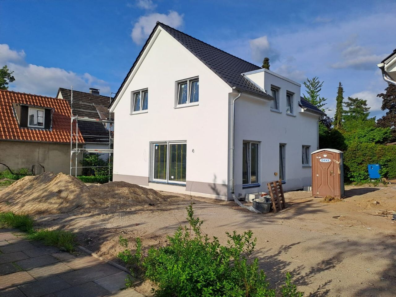

From all the suggestions and tips, a house has now come to life. We still really like the floor plan. Thanks again for that.
Here is a photo from the outside. Pictures from the interior will follow.
At the moment, we are planning the outdoor area, see also Terrace design, size, and shape
Best regards!
