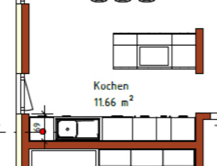

- Kitchen and dining area could be a bit larger. However, this would likely come at the expense of the cloakroom and guest WC. The guest WC could probably be made about 25cm (10 inches) narrower if the positions of the toilet and washbasin were swapped.

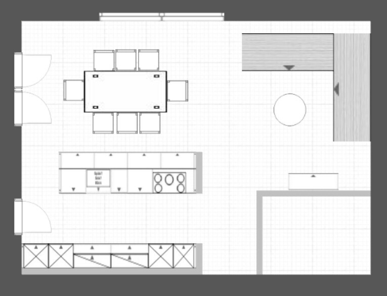

If it’s possible to remove the wall in the kitchen, that would definitely be better. In that case, I would place the island a bit more centrally in front of the kitchen units. Let’s see how much extra that would cost. 😳

If the kitchen wall can be removed, that would obviously be better. I think the wall is very important for zoning and privacy. (Especially considering the idea to rotate the stairway entrance.) It also provides privacy between the sofa and the stove. The wall protects the countertop space at the island and could offer wall mounting options.
The asymmetrical layout also makes the kitchen quite interesting. However, I would make better use of the free space… even if it’s just extending the island… or connecting the island to the exterior wall?
