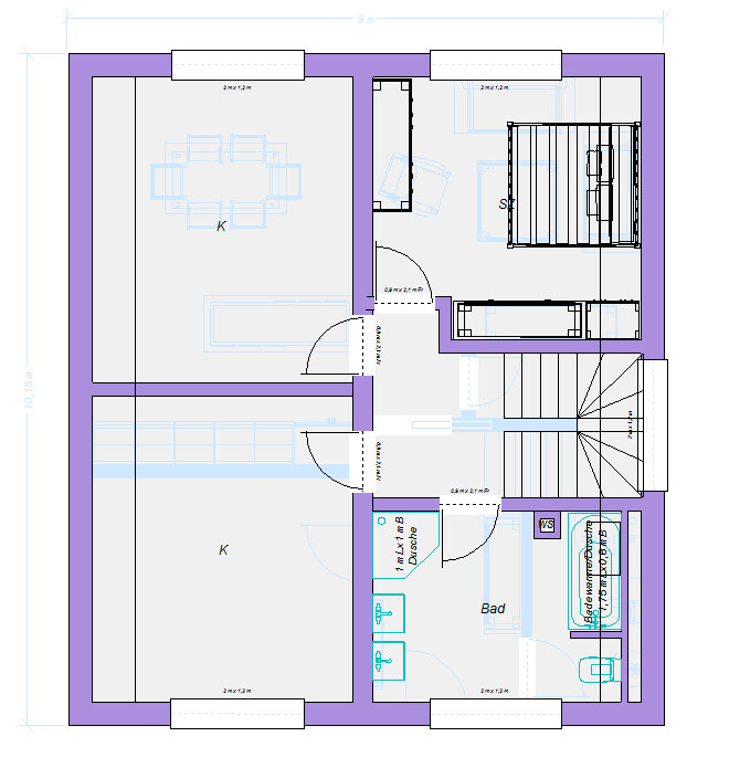

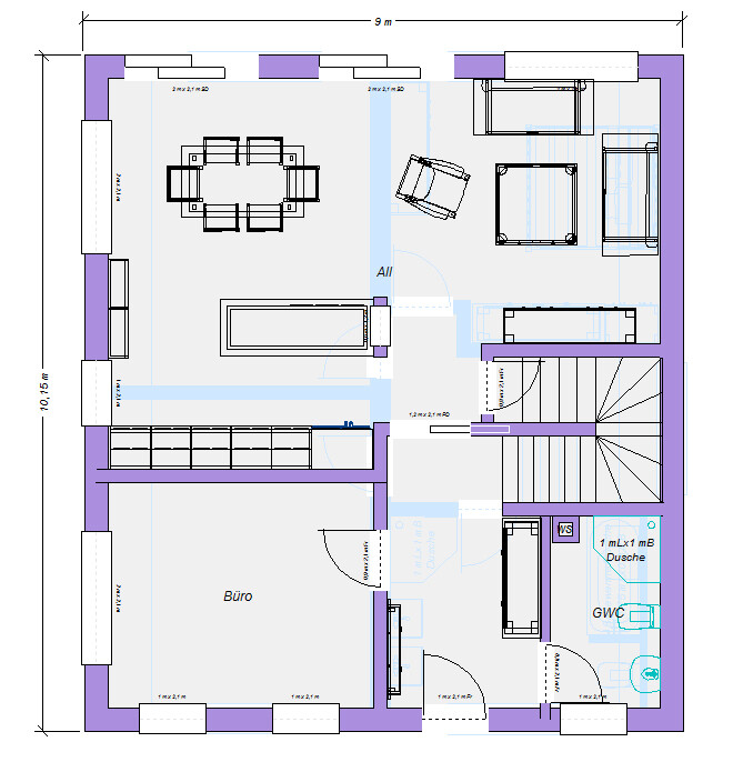

- Kitchen and dining area could be a bit larger. However, this would likely come at the expense of the cloakroom and guest WC. The guest WC could probably be made about 25cm (10 inches) narrower if the positions of the toilet and washbasin were swapped.
- No natural light in the stairwell or hallway. Possibly install a window here?
- Would a different staircase design create more space? Probably, but it would also cause major changes to the floor plan.

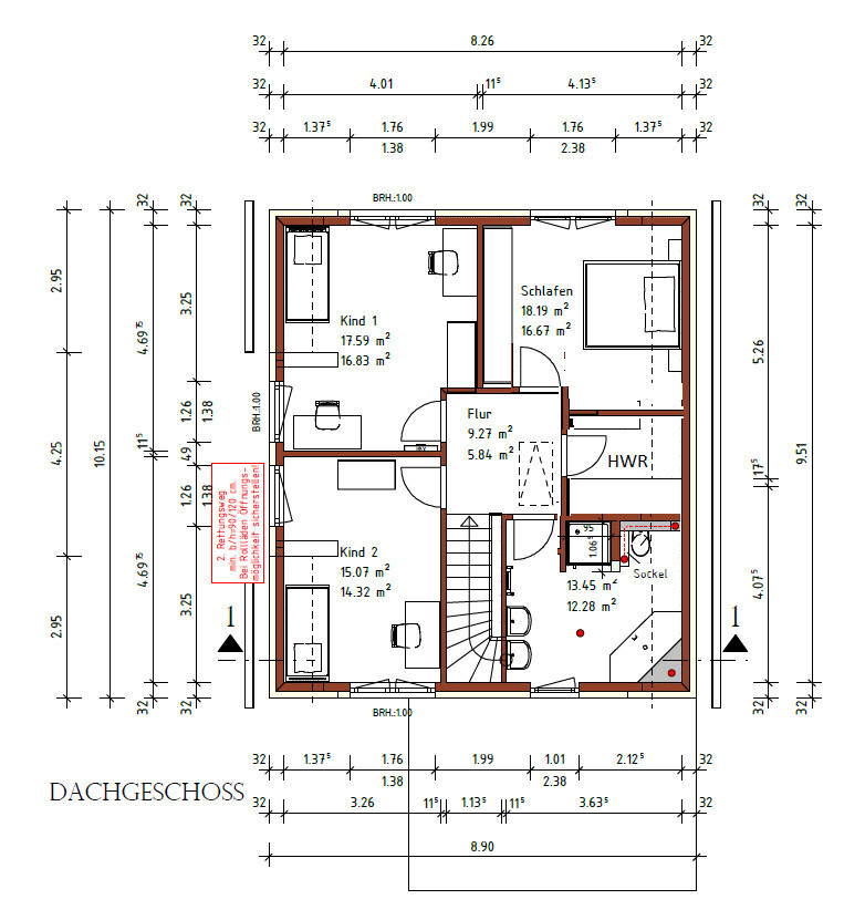

- Cloakroom may be very small. We also have difficulty imagining how this will feel later. The planned pipe routing for wastewater and ventilation in the cloakroom currently takes up quite a lot of space. Maybe swapping cloakroom and guest WC could help?
- The architect has included some very large windows. For example, the office has a 1.76m (5.8 ft) wide window. We wonder if this is necessary, especially given the view is just the driveway and neighbor’s house. What do you think about window sizes?
- The shower has two solid side walls, which may make it quite dark. Currently, daylight only comes from the front. How do you handle shower width? What did you choose?
- The carport location is not ideal. We would have to reverse along a 15m (49 ft) long driveway. Perhaps better to place it on the south side and keep the bike shed in the current position?
- Room layout and window positioning in the basement. Would you keep it this way?

Oh dear, this looks rather neglected. A tiny kitchen squeezed into a small corner is hardly ideal. The dark hallway on the upper floor is also quite bleak. I would just toss this aside and file it under “discard.”
Unfortunately, I don’t understand the garage layout. From the elevations, it appears to be on the north side, if I’m reading that correctly. But on the site plan, the parking space is shown on the south side. I’m going to assume you have a choice and opt for the north side. Accordingly, here’s a quick sketch with a standard design for approximately 9x10 meters (30x33 feet) plus basement (east is at the bottom of the plan):
You’ll have to imagine dormer windows for the kids.
One more thing I wanted to mention—the wall thicknesses seem odd to me. 32cm (13 inches) exterior walls—what kind are those? Timber frame? Do they comply with the energy-saving regulations? I’ve just accepted them for now, but nowadays the standard is usually 50cm (20 inches) walls. Of course, that depends on the material used.
HoisleBauer228 Jul 2022 23:55Great idea to widen the staircase. And overall, a good suggestion!
This was already hinted at: You won’t be happy with this kitchen! The number of utensils that need to be stored simply doesn’t match the available space. Overall, the hours of use are not reflected in the area allocated. In my opinion, the kitchen is the central hub—not just technically. It’s where cooking is done, school lunches are prepared, relaxing teas are made, birthdays are organized... This should NOT be limited to just 7 square meters (75 square feet). And the hallway is simply a very dark space that constantly requires artificial lighting.
HoisleBauer22 schrieb:
Great idea to widen the staircase. And overall, a good suggestion!You have the Like button to choose from 😉HausiKlausi schrieb:
This was already mentioned here: You won’t be happy with this kitchen! The amount of utensils that need to be stored doesn’t match the available space. In general, the number of hours it will be used isn’t reflected in the allocated area. In my opinion, the kitchen is the central point. Not just technically. It’s where cooking happens, school lunches are prepared, relaxing teas are made, birthdays are organized... This SHOULD NOT be only 7 sq m (75 sq ft). And the hallway is simply a very dark structure that constantly requires artificial lighting.The kitchen is larger than the one in the parallel thread by @KED1234 😎Similar topics
